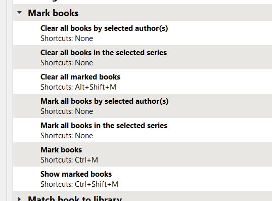

I don't use the mouse, I use the following keyboard shortcuts
Name:	0  Mark Books shorcuts.jpg

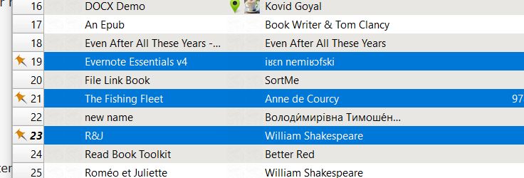

I marked some books with Ctrl+M
Name:	1 marked books.jpg

I searched for (Showed) marked books with Ctrl+Shift+M, and selected them all with Ctrl+A.

Now I can action the three books -- send, save, remove, add a tag, etc, etc.
To Clear the push pin marks I would use Alt+Shift+M
