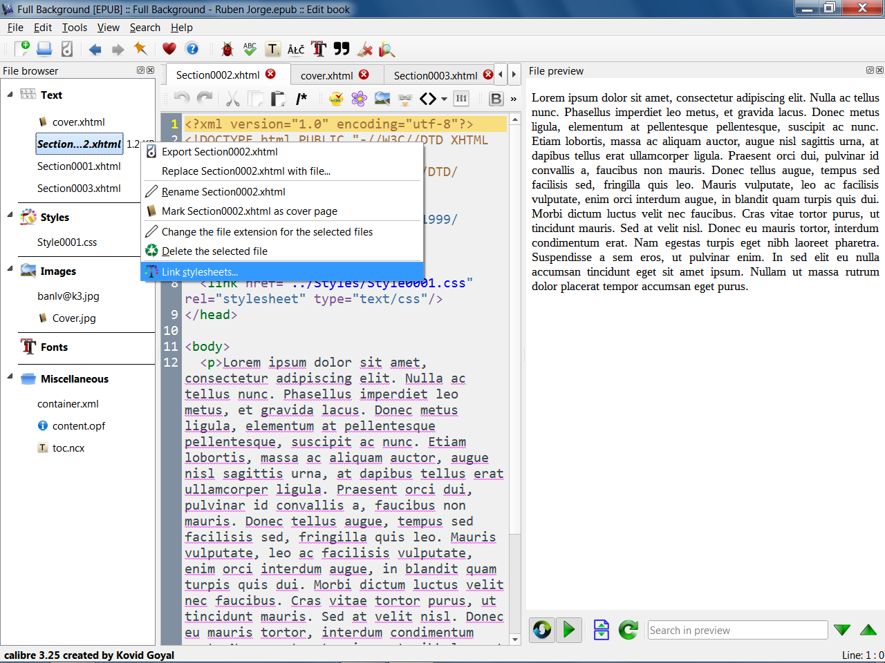

Hi Corinne;
In your first post you said that are using Calibre 3.23; well, I will explain you what to do in that program.
I suppose that you already have loaded your ebook in Calibre. Do right click in that ebook and choose the "Edit book" command; the Calibre Editor will show.
In the "File Browser" window (at the left of the screen) select the file whose image and text you want to center and after that, do right click. You will see something like this screenshot:
Select the command "Link stylesheets...". Now you'll see something like this dialog:
In the above picture you see only one .css file but it can be several. If you have only one, then select that .css file; if there is more than one .css file, select what you want (in all cases, desmark the option "Remove existing links to stylesheets"). Press "Ok". That's all
Regards
Rubén
PS: And don't forget to write the ".center" style in the .css file you have selected according to the explanation.

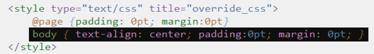

The second thing: according to your screenshot, you are already applying styles by means of "embedded css" (if you want to understand better the way to apply styles, watch the link below).
https://en.wikibooks.org/wiki/Cascad...HTML_and_XHTML
And, in your embedding styles, you have the following (do click in the picture to enlarge it):
The style body {text-align: center; padding: 0pt; margin: 0pt;} what it makes, is to center all text and images inside the .xhtml file. So, you already have set that all elements in the files with the embedded style body {text-align: center; padding: 0pt; margin: 0pt;} are centered. For that reason is that you see all centered automatically.
