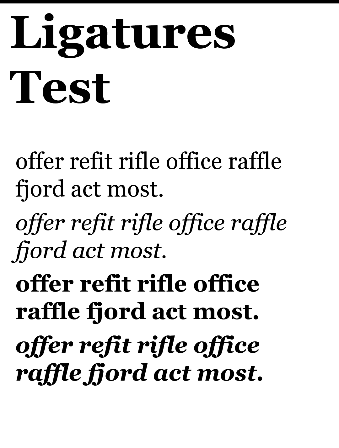

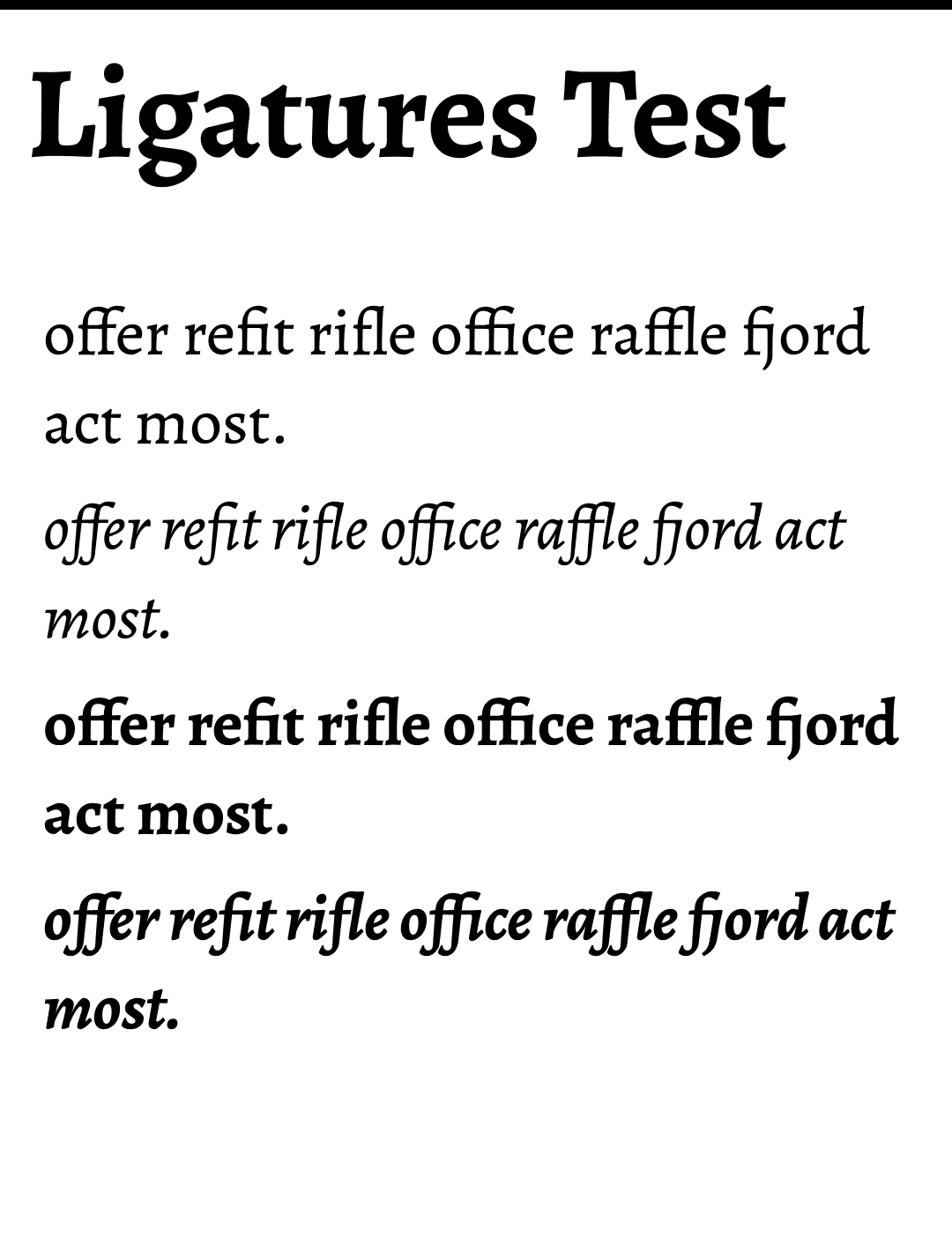

AFAIK, there are no mainstream epub2 apps that actually support ligatures (and other OpenType features). What apps/readers do you use to test ligatures?
Is there a ligature bug in the Calibre subsetting code? If so, you might want to report it to Kovid, if you haven't already done so. (When I reported a font subsetting problem with Arabic fonts a couple of years ago he fixed it the same day and the fix made it into the weekly Calibre build.)
Umm, a little known epub 2 renderer called Adobe RMSDK supports ligatures and kerning (and maybe other opentype features).
In fact, Here are a couple of screenshots from my Kobo of a test epub. First screenshot is the in built Georgia font, which clearly has no ligatures. The second screenshot, I switched to Alegreya, which does.
Name:	Georgia No Lig.png
ID:	163674   Click image for larger version

Thank you sherman for your information and examples.
So ligature display can vary according to the font (Alegreya > Georgia), the renderer (RMSDK > creengine (for koreader)), the subsetter (to be determined) and probably some other - yet- unidentified factors.
The subset of a defective -on this regard- font, will not display ligatures. The subsetter has nothing to do about it. That's why it would be unfair to speak about a "bug" of the subsetter without providing an example. Examples will help us ascertain the origin of the defect. It's not a test.
