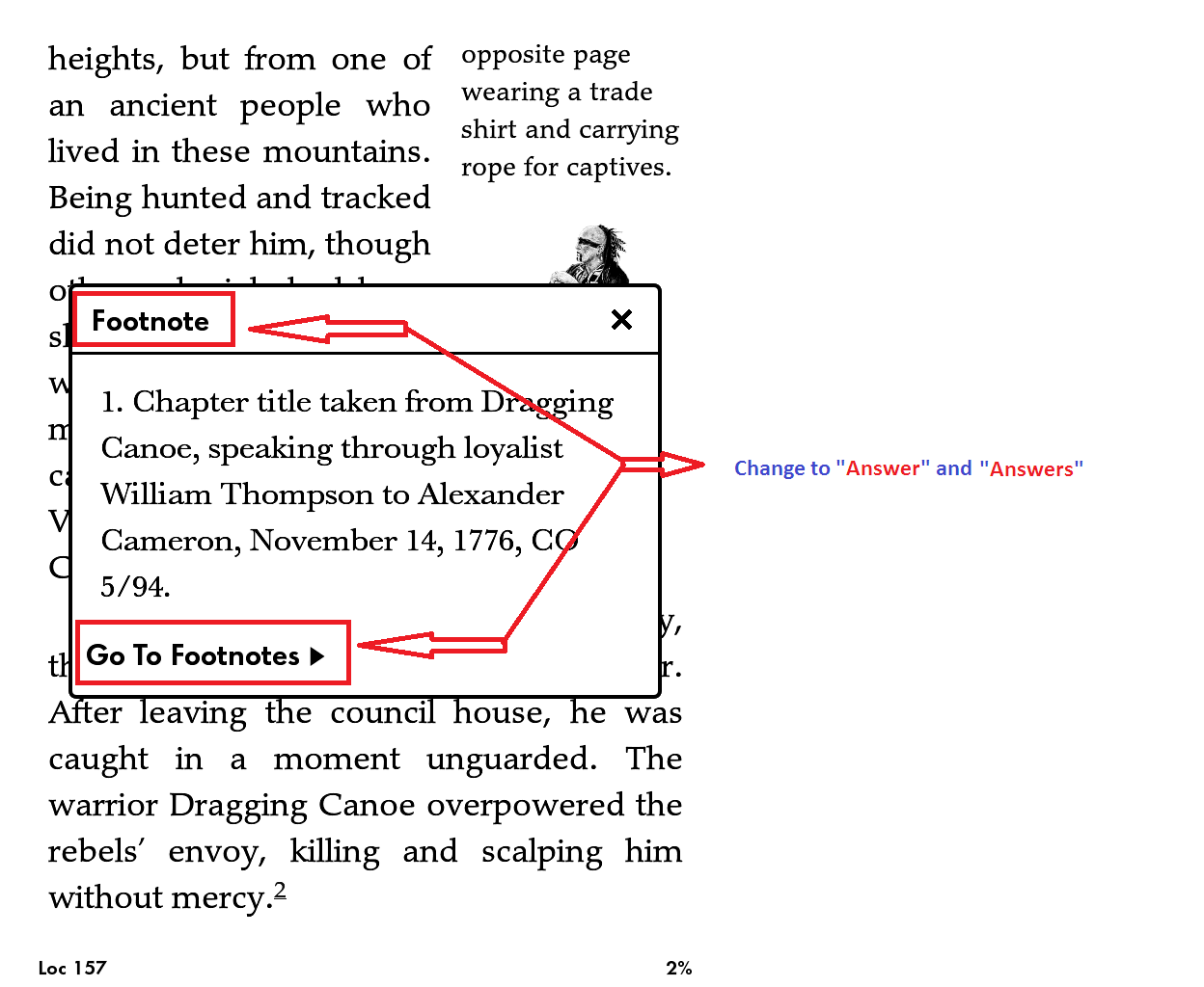

Possible to change the “FOOTNOTE” word to “ANSWER” in popup.
• Kindle paper white old device version 4.1.2: While clicking the question link, it will go to directly respective answers.
• Kindle paper white touch device version 5.6.1.0.6: While clicking the question link, first it will get a popup the respective answers. The “FOOTNOTE” words has shown as device default settings.
Please advise, If possible to change the “FOOTNOTE” word to “ANSWER” in popup in the device. Kindly review and share your observations.
*) No "Paperwhite" Kindle ever ran a series 4.x firmware.
*) If writing about the original PW-1, then you should consider updating to 5.6.1.1
Nobody will be interested in modifying out-of-date firmware.
Please do not hijack threads, start your own for your own topic.
Post (only) the first six (6) characters of the serial number of each device.
Someone will look up the proper nickname for the devices.
That is always the first step: Know what you have.
And have only one topic per thread title.

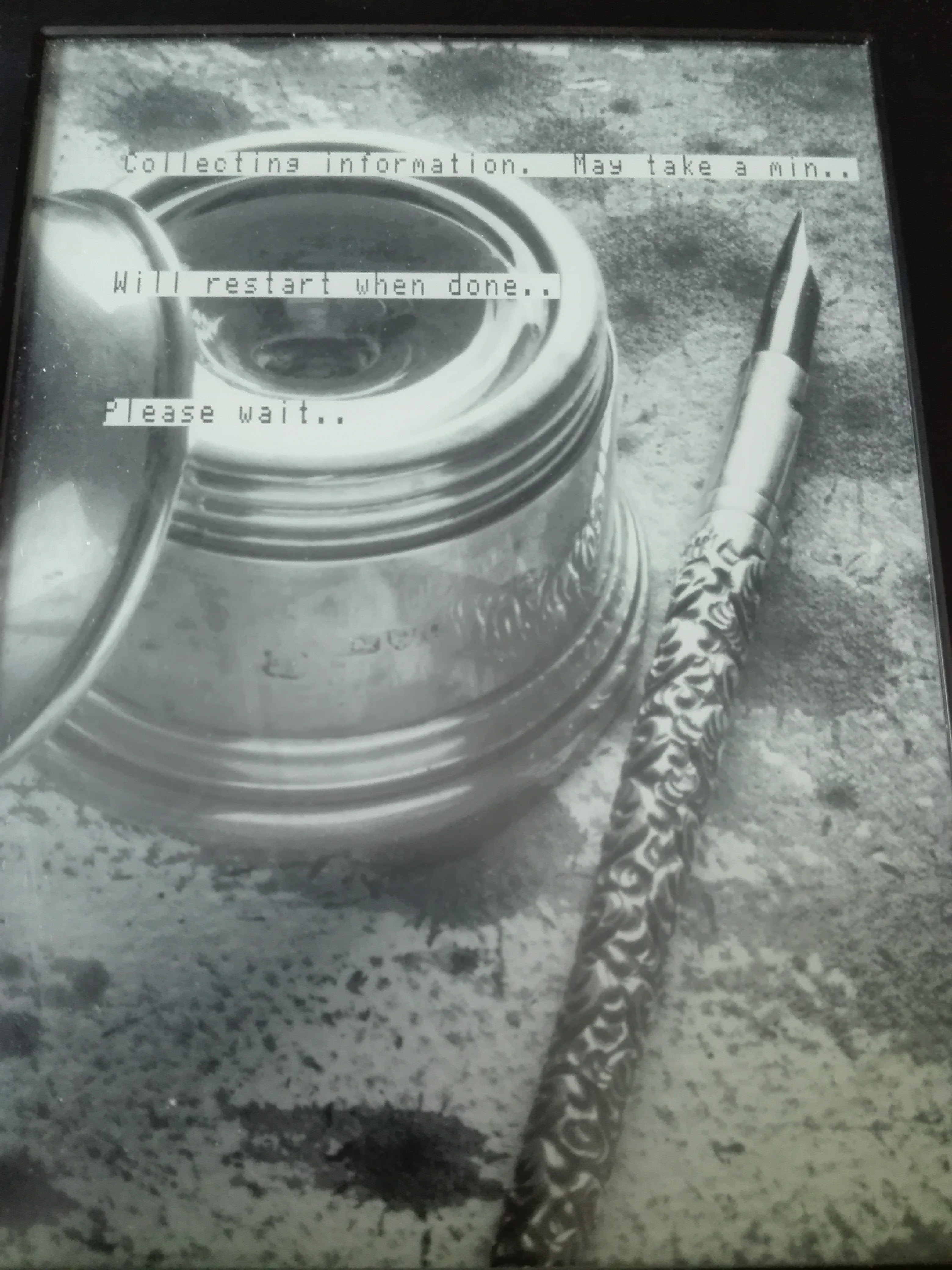

Hi, I have a question that I think is related to this jailbreak:
After downgrading and jaibreaking my PW1 I have noticed that cycling screen (double taping the power button) forces a reboot with information gathering. Is this a function of this jailbreak or normal kindle function that I didn't noticed before jailbreaking? Can it be deactivated (it's a bit frustrating accidentally cycling screen too fast and having to wait for a full reboot)?
bar1004 is offline   Reply With Quote

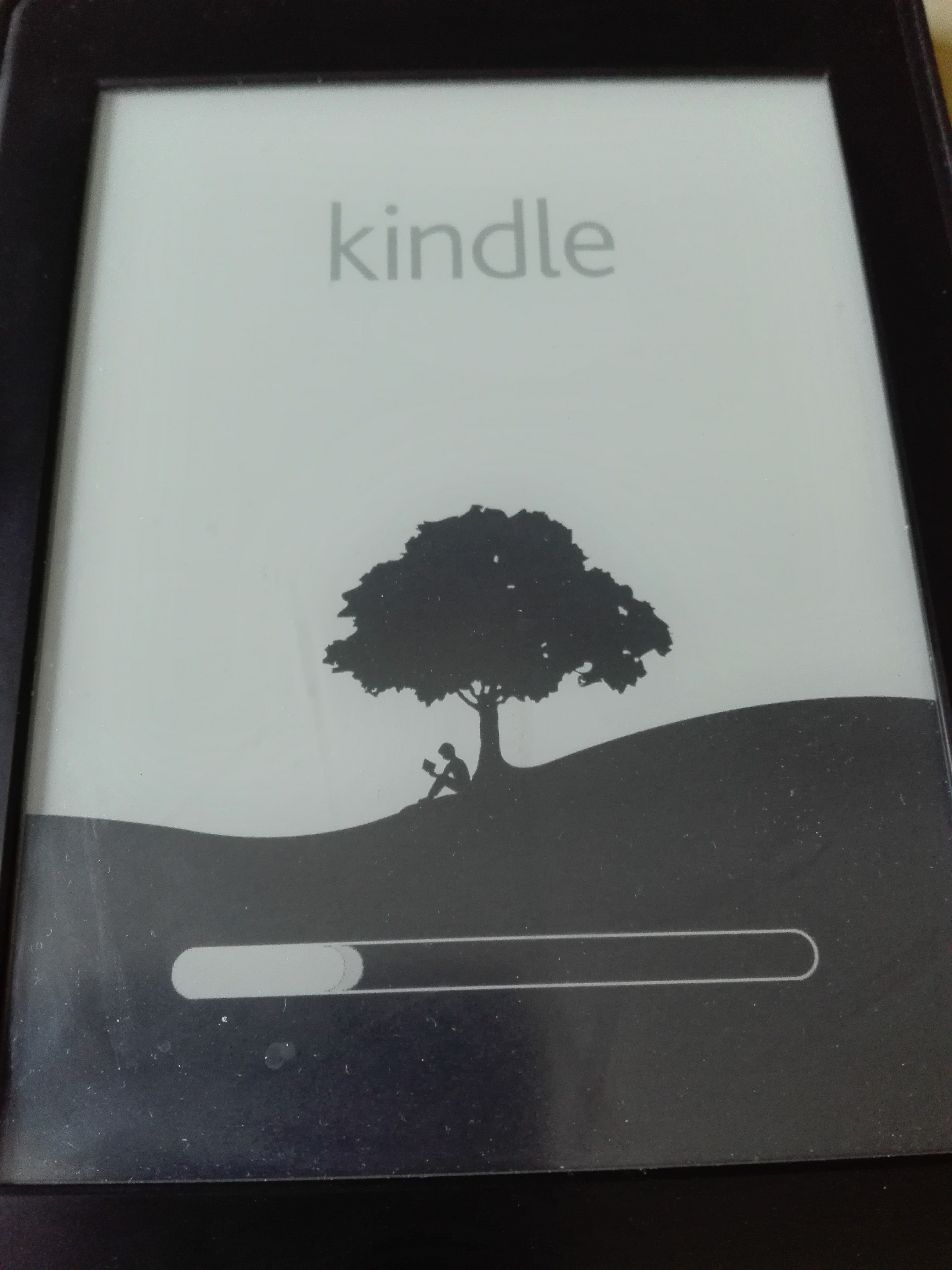

By double taping power button I mean double clicking, i.e. clicking power button and doing it again within ~1-2 seconds.
By information gathering I mean screen on the left below (sometimes it bugs out and displays text above 'screensaver' image, but most of the time the text is on blank screen), that looks like some sort of debugging reboot with logging capability. After that disappears Kindle performs normal power on cycle (on the right).
ID:	158322Click image for larger version

You are running a very old version of this jail break.
Perhaps even the original, which is now five years old.
What you see is the 'Bridge code' running, testing if the JB needs to be re-installed.
Go to the first post, find the section with the heading:
IMPORTANT NOTICE REGARDING JAILBREAK UPDATES:
Open spoiler.
Read.
Follow the directions, at least those in the summary at the bottom, inside of the spoiler.
Inside of the archive you download, you will find a document entitled: README.txt
Open, scroll down to section headed: *INSTALL Jailbreak*
Read.
Follow directions.
Among the changes, that message is gone, replaced by enhancements to the 'Bridge code'.
Once you have done that (re-installed the jailbreak with the current version), you should update your firmware version.
That **might** fix the problems which are causing you to re-boot the system.
**might**
But it sounds more like a hardware problem to me.
You will want to choose what newer firmware version you install if you are using CM.
Go the the end (most recent posting) of the CM thread and scroll backwards in time (posts) to see what the most recent firmware version CM supports.
There have been updates to CM since ixtab left, and you will find them attached to posts in his CM thread.
The only way to stop seeing the re-boot processing is to stop re-booting it.
