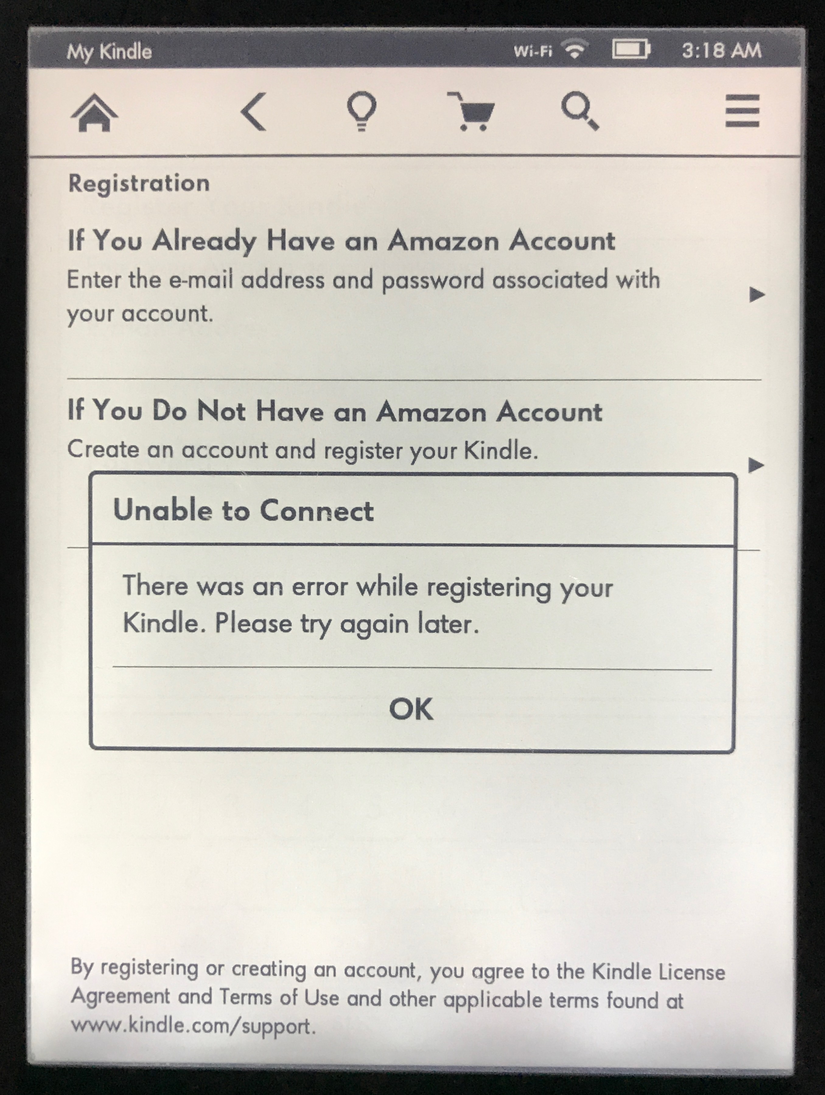

Hello,
I finally decided to pull the trigger and Jailbreak my PW1. I used the recommended method by downgrading to FW 5.3.3, then completed the Jailbreak. Installed JBPatch. Used it to modify the margins on the device. This is really mainly what I wanted to jailbreak for.
However, the Kindle PW1 lost the ability to download books from Amazon. I went to Cloud, selected a book (either bought at the store or a personal document). It said "downloading" briefly but nothing happened. I was able to "Sync and check for new items" without any error. I was able to go to the Experimental browser and browse the web.
So I decided to reset the Kindle. After doing so, I entered my local WiFi and tried to register. No luck. There is an "Unable to connect: There was an error while registering your Kindle" error. So I believe this is somewhat related to specifically connecting to Amazon.
Anyone had the same problem? Should I try to upgrade my Kindle to a newer firmware? What is the last version I can upgrade to without losing Jailbreak?
Thank you.

My understanding is that the Paperwhites require 5.6.1.1 or higher to support the new SSL certificates amazon has updated to.

Your firmware is too old to support TLS, which is the only secure protocol Amazon supports.
You need to be running the current firmware for the PW-1, 5.6.1.1
Kiss JBpatch goodbye, it has not been updated for 5.6.1.1
Check the thread about setting new margins without JBpatch.
It was yourself, pressing the 'reset' button that destroyed your jailbreak.
Follow the directions to jailbreak your device (again).
The jailbreak is viral (if you have installed the latest 'hotfix' from NiLuJe's snapshots, and you keep your finger off of the 'reset' button).

You also need support for TLS-1.0, so there is no 'partial' update possible since that requires code changes throughout the system.
Where did you get the idea that you would lose the jailbreak or the Amazon sync functionality if you updated to 5.6.1.1 ?
Just keep your finger off of the 'reset' button.
Just follow the directions (that is: be certain you have the most recent 'hotfix' installed prior to doing the update).
See my post above.

You can not jail break a PW-1 runing 5.6.1.1, but you can downgrade it to 5.4.3.2 (which is what the PW1 jb instructions have you do).
And 5.4.3.2 can be jail broken, ref:
https://www.mobileread.com/forums/sh...d.php?t=186645
You intend (to get TLS v1.0 working) to upgrade to 5.6.1.1 version firmware.
Version 5.6.1.1 is greater than or equal to 5.6.0 -
So read the section of the first post of the jb thread linked to above, entitled:
IMPORTANT notice regarding FW >= 5.6.0
Second sentence.
Now for the second part, you have to engage mind and solve a logic problem:
What is now labeled as 'Reset' translates to: 'Reset (to factory defaults)'
What part of Mobileread add-ins are part of the factory defaults?
