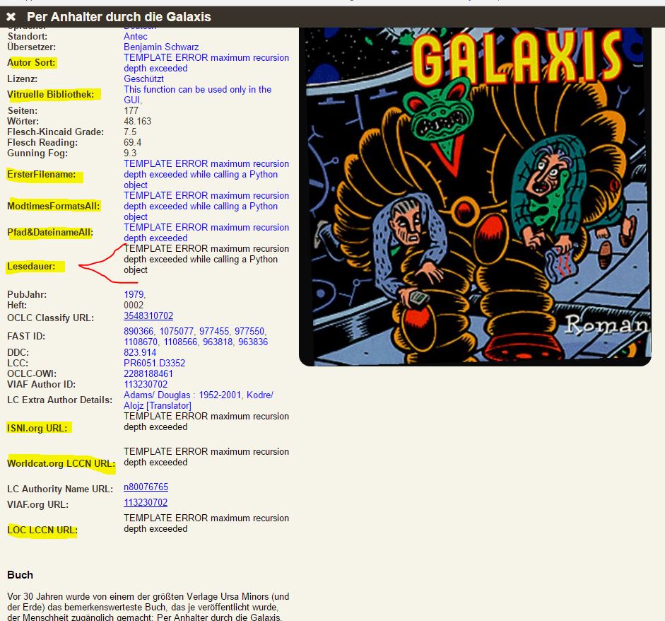

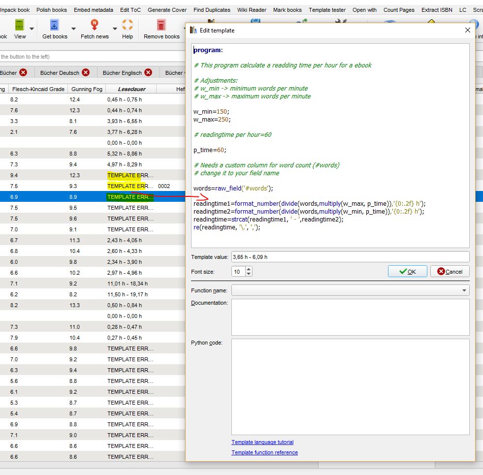

@Kovid,
I did a new installation with the actual version and made a new source clone.
Did you change something with custom column build from other columns? I have with the actual version 2.99.8 template errors in all custom columns with functions and program mode. I haven't check this before but see it now in the GUI library. Do I need to change something in the templates?
FWIW: Using the latest source (commit eeca0a8 at 18:02), binary 2.99.8 on Win10 with Chrome, all my test library composite columns display. My tests include custom template functions, GPM templates, TPM templates, and basic templates.

For custom column, have you a idea too?
It looks like this happen sometimes and sometimes not. See column "Lesedauer". I took a screen shot from normal GUI and Web-GUI attach it below as an example for one book

Old 05-27-2017, 02:16 PM   #341
chaley
Posts: 12,529
Karma: 8075938
Location: Notts, England
+@chaley
There isn't anything obvious there. If you are running on debug mode then there should be more info on the debug log.
If you are willing to send me the metadata.db file I will try to repeat the problem. Send it to calibre-logs at charles dot haleys dot org.

Old 05-27-2017, 03:11 PM   #343
Posts: 46,082
Karma: 29579912

Old 05-27-2017, 05:12 PM   #344
chaley
Posts: 12,529
Karma: 8075938
@chaley,
thanks for your offer. Very kindly. I will send you the file for this DB in a view minutes.
The debug-log is more or less the same as I have already post here. See attached.
Unfortunately it works fine on my machine. Every "Lesedauer" column has a value in the GUI. It also has a value in the books I checked using the content server, including the one that you captured.
The debug log says that the internal calibre data structure holding the names of custom columns is corrupted. This should be impossible. The only way I can see it happening is if the file system used for virtual memory support is corrupt, but that would break more than calibre.
I don't know what is happening.
