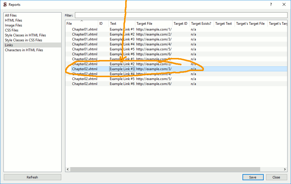

Open the attached sample EPUB with Sigil's Tools > Reports > Links. Double-click on any link:
If you click on any link in Chapter 1, Sigil will jump to the very top of Chapter1.xhtml.
If you click on any link in Chapter 2, Sigil will jump to the very top of Chapter2.xhtml.
(Not very helpful.)
Expected Functionality
Jumping to the link's exact location in the HTML file (see the way Calibre's Editor Tools > Reports > Links handles it).
If you click on "Example Link #3", Calibre jumps directly to the <a> containing "Example Link #3".
