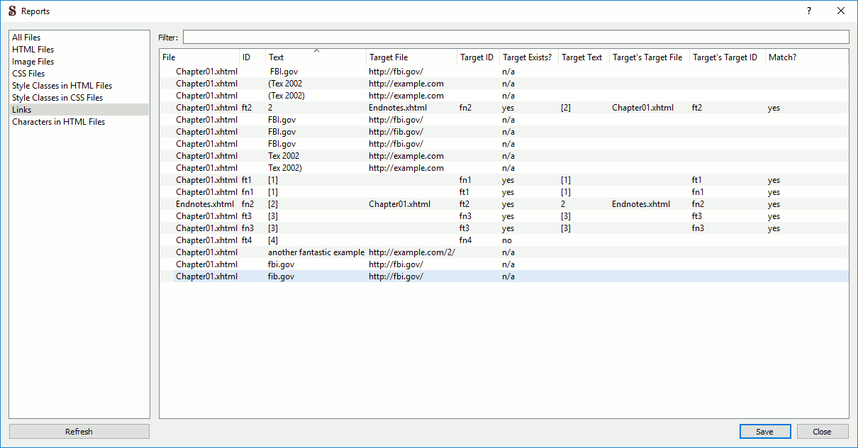

Example #1: Take your FBI example, maybe they link throughout the book as:
<a href="http://fbi.gov/"> FBI.gov</a>
<a href="http://fbi.gov/">FBI.gov </a>
<a href="http://fbi.gov/">FBI.gov</a>
<a href="http://fib.gov/">FBI.gov</a>
<a href="http://fbi.gov/">fbi.gov</a>
<a href="http://fbi.gov/">fib.gov</a>
Spaces very easily creep their way into <a> when using the mouse + WYSWIG editors. These things stand out like a sore thumb when sorted. :P
And a typo (fib.gov) can also easily sneak in the href (this is very hard to spot just looking through the Code View).
Example #2: In the case of this specific book I was working on, there was an article that referenced (Author Year) with a link to the specific book/paper:
(<a href="http://example.com">Tex 2002</a>)
(<a href="http://example.com">Tex 2002)</a>
<a href="http://example.com">(Tex 2002</a>)
<a href="http://example.com">(Tex 2002)</a>
After sorting, you could see it show up in the list as:
(Tex 2002
(Tex 2002)
Tex 2002
Tex 2002)
Example #3: It is also very helpful when you do things like changing footnotes from <sup>##</sup> -> [##].
If I sort and see a giant list of:
4
[1]
[2]
[3]
[5]
I can go take a closer look. That single digit number should not be there!
Example #4: The "Target Exists?" column is also fantastic for catching missing footnotes:
<p>This is the beginning.<a href="#fn1" id="ft1">[1]</a></p>
<p>And the middle.<a href="Endnotes.xhtml#fn2" id="ft2"><sup>2</sup></a></p>
<p>And this is more middle.<a href="#fn3" id="ft3">[3]</a></p>
<p>And this is the end.<a href="#fn4" id="ft4">[4]</a></p>
<hr/>
<p class="footnote"><a href="#ft1" id="fn1">[1]</a> Footnote #1.</p>
<p class="footnote"><a href="#ft3" id="fn3">[3]</a> Footnote #3.</p>
you can sort "Target Exists?" and see "no" in the column, then you can investigate.
Example #5: You can also sort all the links by "Target File" and take a very close look at external websites.
For example, if there are lots of Youtube links, you may want to check to see if those still exist, what the titles are, etc. etc.
(This particular article pointed to a Youtube Embed link instead of just pointing directly to the normal Youtube video.)
This sort of stuff is EASILY spotted in the Report.
Side Note: Calibre's Links Report also lets you click on the links right there and open them up in your browser. Pretty helpful.
Side Note #2: I don't know when it was added, but Calibre's Tools > External Links > Check External Links is absolutely fantastic for catching HTTP 403/404 Errors.
When you import/work from a collection of web articles it helps you can then go hunting and replacing with newer/working ones (for example, there may be broken Facebook/Twitter links, or a site has updated and hasn't redirected links properly).
