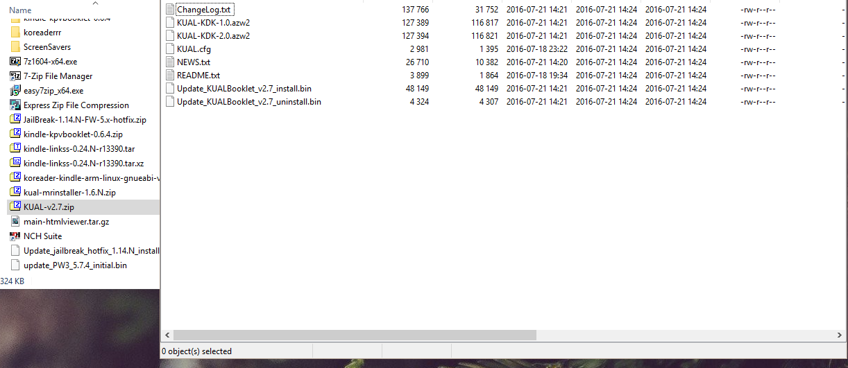

Yeah.. I had KUAL and mrpackages and etc. This is a current screenshot when I plug it in:
[Image violates Posting Guidelines for size - MODERATOR]
I checked again - no launcher in my kindle books anymore. That sucks!
Are you using the 'document' or the 'booklet' version of KUAL?
If using the 'document' version, it should be in /documents (which you do not show).
If that has disappeared from /documents during an update -
If you live in the USA -
Then you have caught Amazon committing a felony - notify Home Land Security and report their messing with your personal information and documents on your Kindle computer.

Looks like it was booklet:
So what should I do? Just delete everything and start from scratch?

No.
That looks like a view of the files on your PC, not on the Kindle.
Put:
KUAL-KDK-2.0.azw2 in the /documents directory of the Kindle.
That would be found at the topmost visible level of USB storage.
NOT in a /documents directory on the PC - (yes, some people have tried that )

In that case, you are using the "Document" version of KUAL, not the "Booklet" version.
Change the display filter to include all active documents.
Terms depend on firmware version, but most recently in the upper left of the home screen. What is the firmware version?
Do not start over, you can only make things worse.
