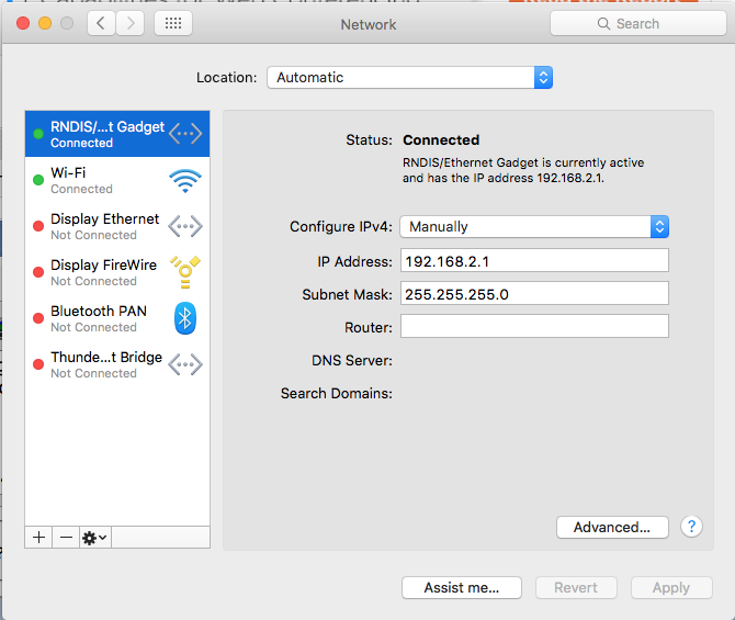

Looking for help setting up usbnet on Kindle PW1 and Mac OS X. It's installed and seems to work up until `ssh root@192.168.15.244` or `telnet 192.168.15.244`. Both of these just timeout.
What I've done so far. I installed from kindle-usbnet-0.21.N.zip in the OP and have been trying to follow what's in README_FIRST. Running ;un does change the mode - I can see RNDIS/Ethernet Gadget connected in Mac's network preferences (screenshot below). It's configured to IP 192.168.2.1, subnet mask 255.255.255.0. usbnet/etc/config is set to the defaults.
Name:	Screen Shot 2017-06-02 at 4.41.41 PM.png
Does someone know why the ssh/telnet won't connect at this point? Thanks for the awesome tools and in advance for any help.
Last edited by evanrmurphy; 06-02-2017 at 09:30 PM. Reason: finished attaching screenshot, tweaked text
Attachment 157153
Yes, you wrote the answer in your post above.
That means the numbers in each all 1 fields (255) must be the same at each end of the connection.
That is the Mac end of the connection's address.
That is the Kindle end of the connection's address.
Can you see the problem now?
Hint:
255.255.255.0
192.168.2.1
192.168.15.244
There is a tutorial here on how to setup USBnetworking on a Mac (with pictures IIRC), have you tried using that?
Hint:
255.255.255.0
192.168.2.1
192.168.15.244
knc1, thanks for helping me understand what the subnet mask is for. I changed the Mac's connection IP to 192.168.15.245, so that both IPs now have the first 3 fields in common (192.168.15). Now it's working! Both the ssh and telnet commands work now. Much appreciated.
Sometimes the answer can be right in front of you (or anyone).
It "just happens".
