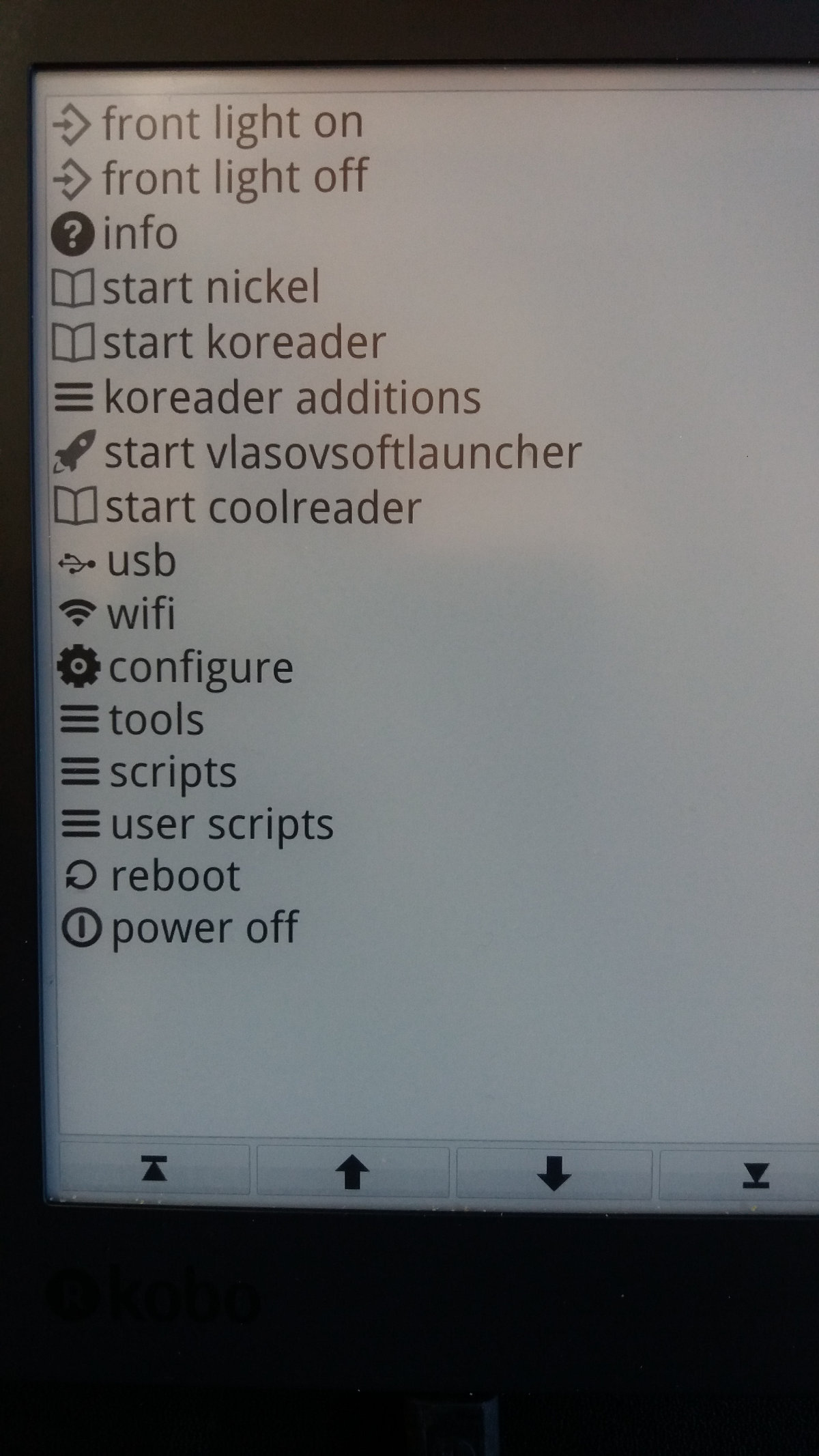

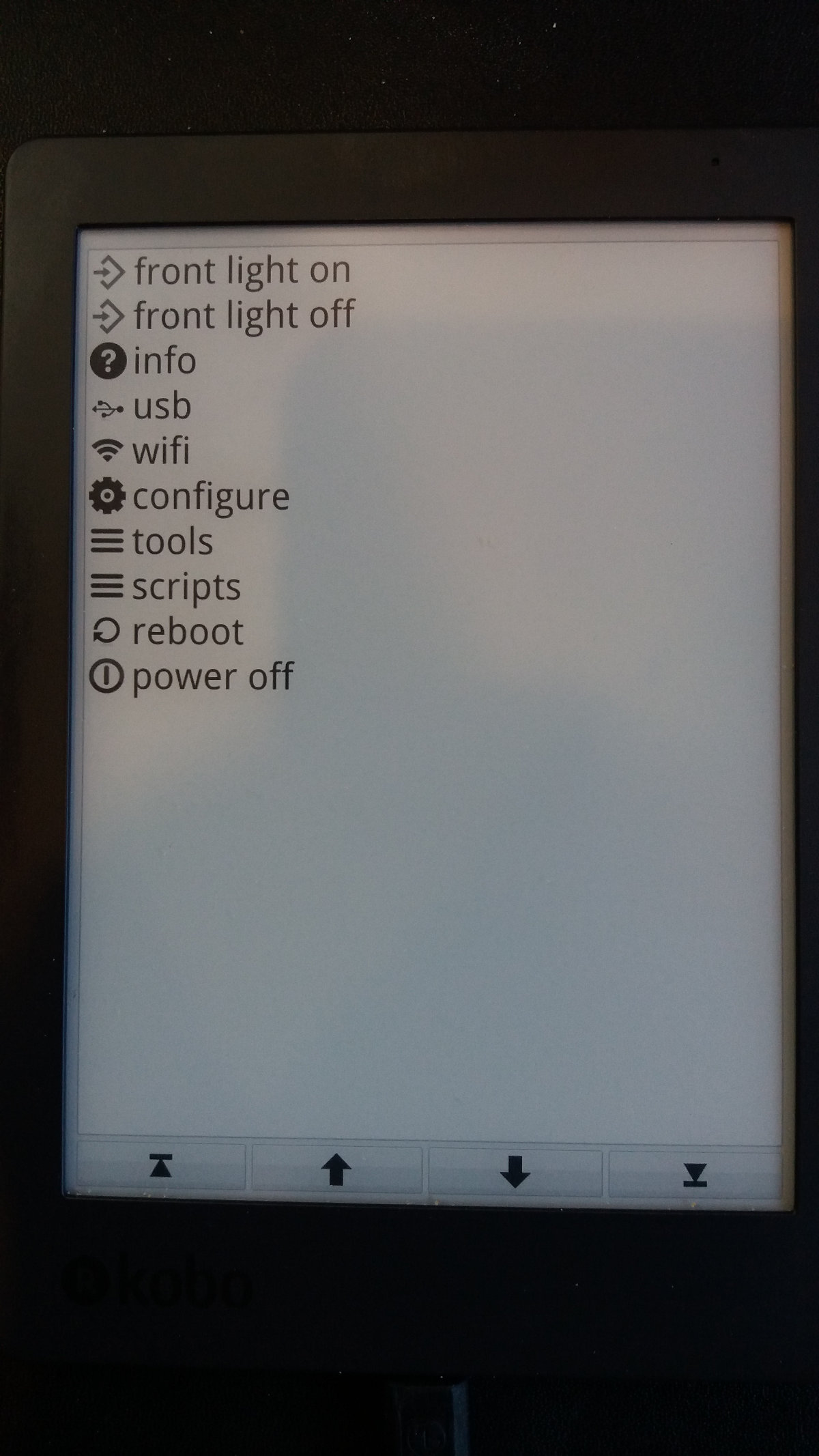

If I enable USB, and then do "return", the menu items I've added for KOreader, vlasovsoftlauncher, and Cool Reader all disappear. In addition, if I do "power off" with USB enabled, the poweroff_info.html file isn't visible (so the poweroff screen says "cannot open file: /mnt/onboard/.adds/kbmenu_user/txt/poweroff_info.html"). This is not affected by whether I've run "eject" from my desktop.
If I use the "explore_all.msh" script with USB enabled, /mnt/onboard appears empty.
If I run "disable USB" the missing menu items show up again.
Config is KSM 08 + patch 4c on a new Kobo Aura Edition 2 with the latest (4.3.8842) firmware.
Any ideas?
Thanks!
Dan

This is exactly as intended. The reason is that we have to unmount the user partition when we access it as usb storage. I hide those entries from the menu that might cause problems when the user partition is unmounted.

Cool, thanks - wanted to make sure it wasn't me :-)
