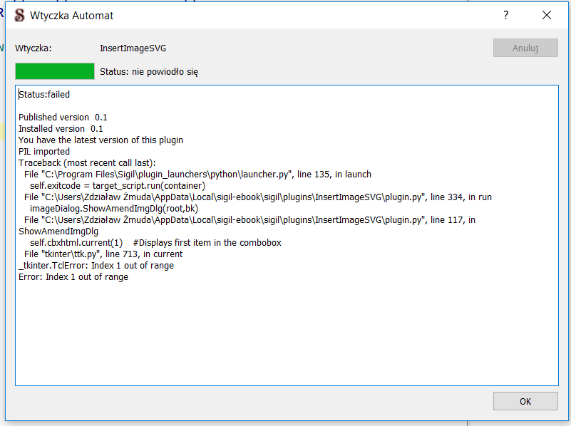

@CalibUser...
When you attempt to use the plug getting the message.
bravosx

@bravosx: The plugin works fine on my Windows 10 machine. Did you check the Use Bundled Python box in the Manage Plugins dialog box?
If so, you'll need to post the steps that caused this message to be displayed, unless it's being displayed immediately after running the plugin.

The epub he opened probably has no images in it. I get the same error when launching the plugin when no images exist (in the plugin). Works fine on Linux, otherwise.
Just needs a way to handle the empty list situation, is all.
EDIT: I take that back. It's not the images. The error happens when an epub only has 1 xhtml file. One of the combo boxes is set to default to the second entry in the list ... but a brand-new epub only has one xhtml file.

@Doitsu...
@DiapDealer...
Field: of Use Bundled Python box in the Manage Plugins dialog box is checked.
An error message is given a moment after starting the plug.
Images are included eo Images directory.
edit: The plugin works properly when epub is a lot of files in the folder text.
Sorry for my English.

Some suggestions in the attached patch.
In addition to the index error, I'd suggest populating the combo box with the xhtml file _names_, rather than their manifest ids. Many people won't recognize those offhand.
Also the image file filter is broken on the openfile dialog. My png files wouldn't show up unless I changed to "All files".
Yours to do with what you will, of course. Thanks for the plugin!

Thanks for the bug report and for the suggested patch - I have uploaded a correction in the first post of this thread

...I'd suggest populating the combo box with the xhtml file _names_, rather than their manifest ids. Many people won't recognize those offhand.
I am not sure what you were referring to - the combo box showed the names of the xhtml files when I ran the original plugin eg Section0001.xhtml. Was you referring to the Images\... reference in the listbox? The new version no longer shows Images\...

Originally Posted by CalibUser View Post
I have updated the plugin in the first post of this thread.
No. The first version I saw was populating the combo box with the manifest ids of the epub's text files. Many epubs made by Sigil will have ids that match the filename (Sigil creates new files with ids equal to the filename if it can, but this isn't always guaranteed), but others may not. When I opened some of my own epubs, the combobox was populated with entries like "nav, toc" etc. They didn't match what I was seeing in Sigil's Book Browser.
You're not doing anything wrong, it's just that the manifest ids of an epub's files won't always match what a user sees in Sigil's Book Browser.
I included a "fix" for it in my patch. Perhaps you already applied it?
EDIT: Yes, I see my patched code being used on line 139
for id, href in self.bk1.text_iter():
    self.xhtmlTuple=self.xhtmlTuple + (os.path.basename(href),)
Originally it was:
    self.xhtmlTuple=self.xhtmlTuple + (id,)
