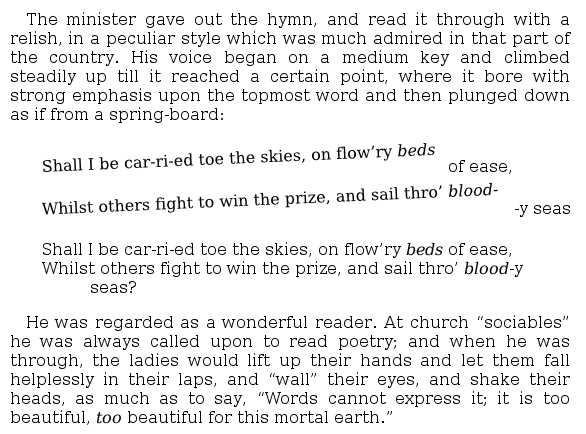

I've added a 4th test to the file in the first post. Here I've tried to code with SVG a feature found in the printed book, where two lines are slightly rotated... The attachment in this post shows how it should look (it's a snapshot of the text rendered by Opera).
I'd appreciate some feedback on how it work (or doesn't) in different readers.

Here comes screenshots from stanza. From your description, it looks like test 4 did not come out so well, but test 1 and 3 looks great. For test 2, the text begins below the image, and not on the side of it. The results from iBooks will follow shortly in a separate post

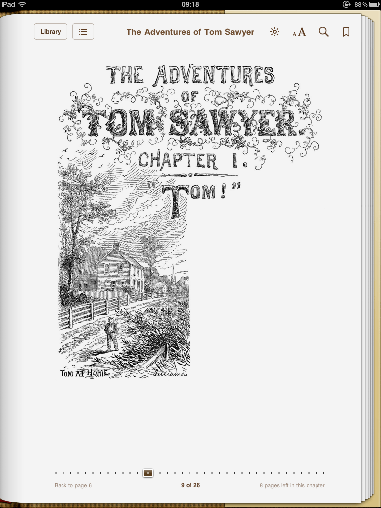

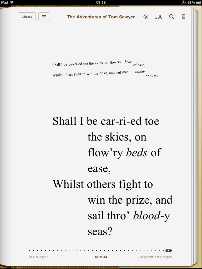

And here comes the results from iBooks. iBooks doesn't always handle svg-images in a good way, which could explain why the images are gone in test 1 and 3. In test 2, there is the image on the first page. The text begins on the second page.
Test 4 is more successful in iBooks than in Stanza, but with big font size, the illusion disappears (not unexpected).

I doubt it, those tests have no SVG at all. The illustration is simply placed in a 0-height box, maybe iBooks is forcing overflow:hidden or something...
