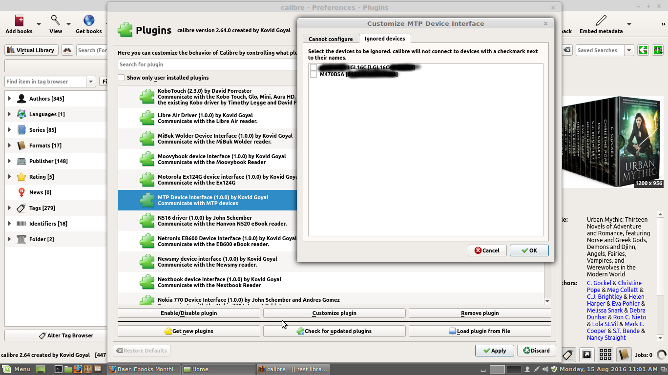

Make sure you have not told calibre not to mange your MTP device. See screenshot should not be any boxes checked.

OK, thanks. Checked, and that tab has only my Nexus 7 listed, but not checked.
