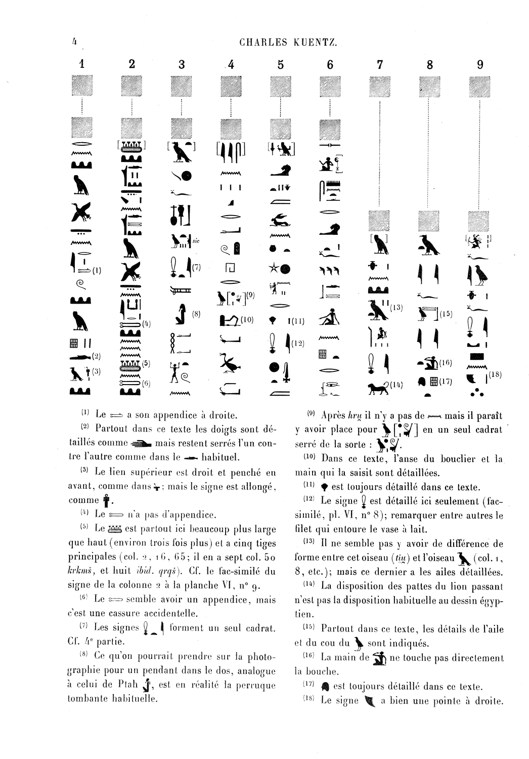

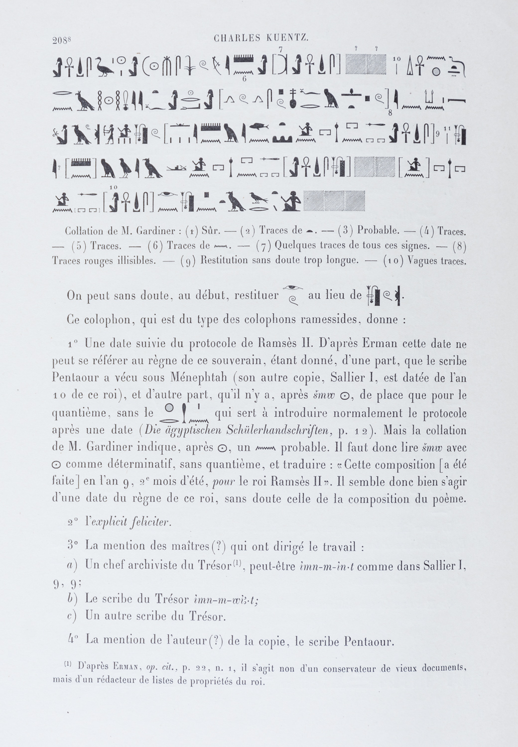

Please find attached a couple of sample pages. These are at the minimum resolution I consider to be readable. I need to have the hieroglyphs sharp and clear. Any suggestions for significantly reducing the size of the page image would be very gratefully received.

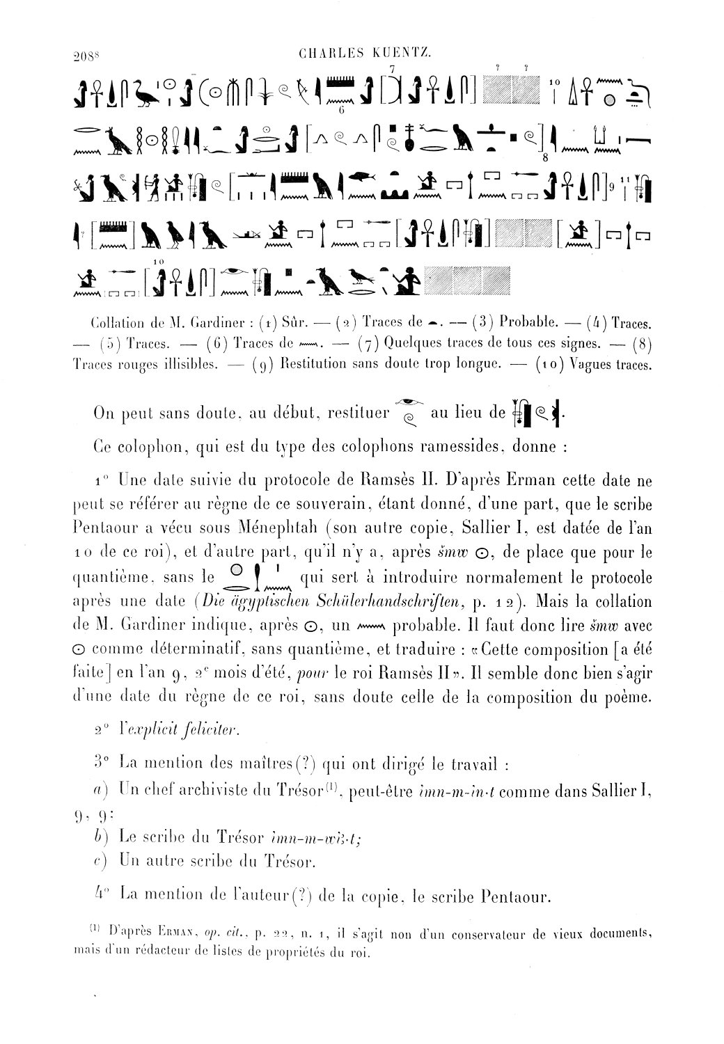

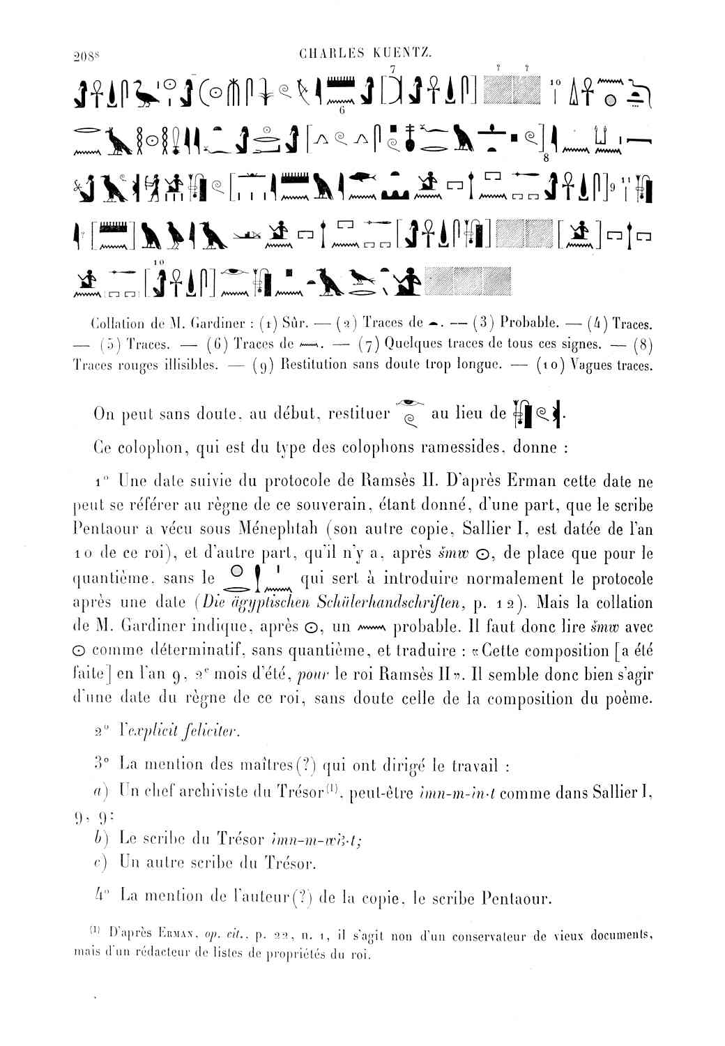

Let's see if this helps. I did this with gimp, which may behave different from photoshop.
015: Changed to greyscale mode. Adjusted levels: input levels from 70 (black) to 230 (white). Saved as JPG with 85% quality (my default). Result: 015 -_(2).jpg, 40% size. Saved as JPG with 30% quality. Result: 015 -_(3).jpg, 19% size. Changed to indexed color mode, 16 maximum levels. Saved as PNG, maximum compression. Result: 015 -_(4).png, 18% size.
225: Same process, but adjusted the levels between 85 and 215. 225 -_(2).jpg: 38%. 225 -_(3).jpg: 19%. 225 -_(4).png: 16%.
I think the 30% quality JPGs are too aggressive and blurry, but the PNGs look quite acceptable.

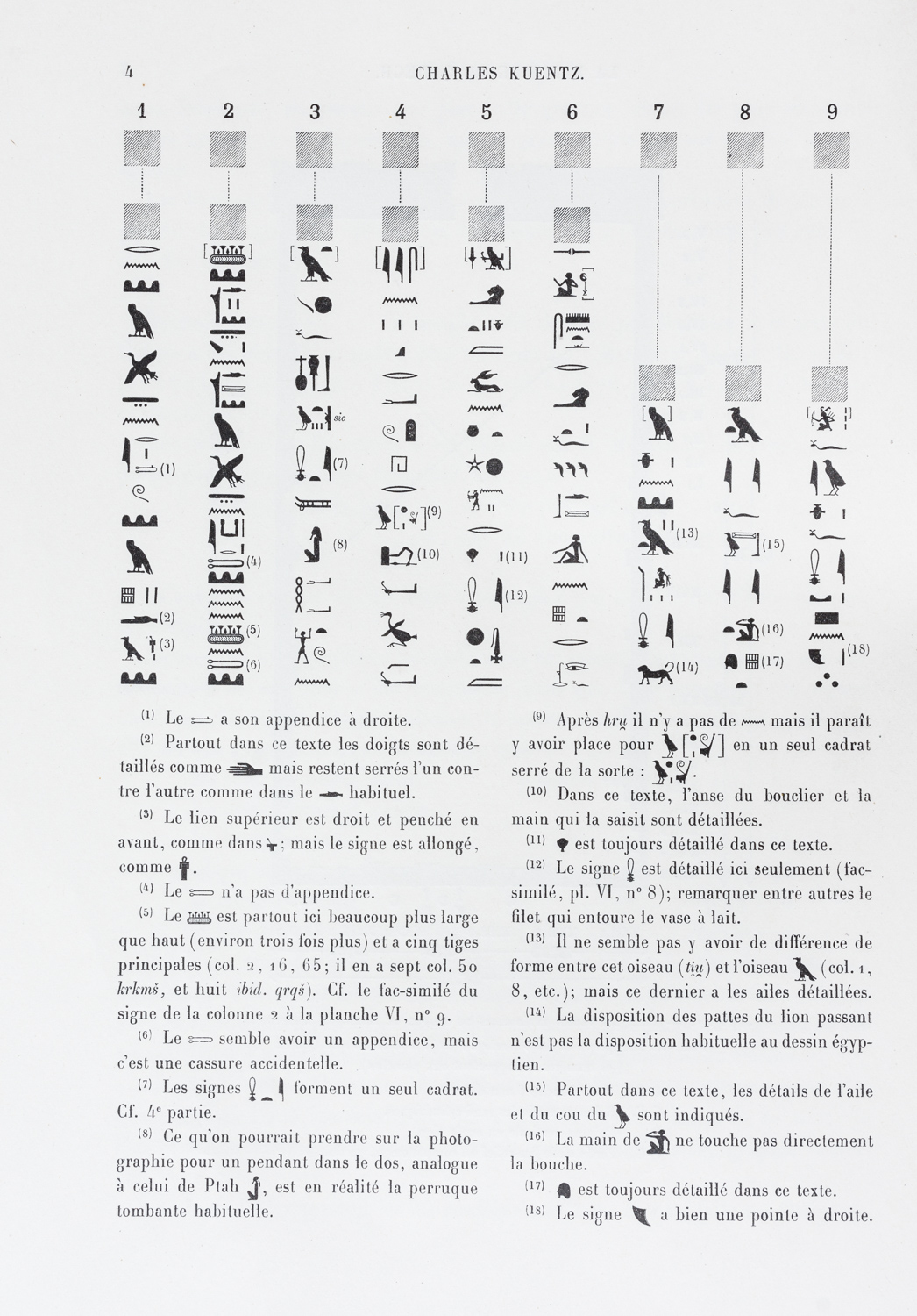

The original is a camera RAW file with a resolution of 6000x4000 pixels, and a 14-bit pixel depth (ie 16000 intensity levels). See the attached full-resolution sample: you can clearly see the fibres of the paper surface.
