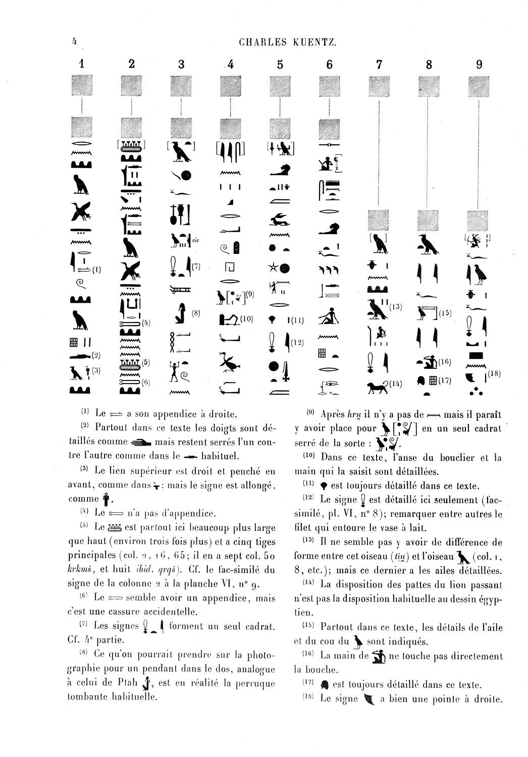

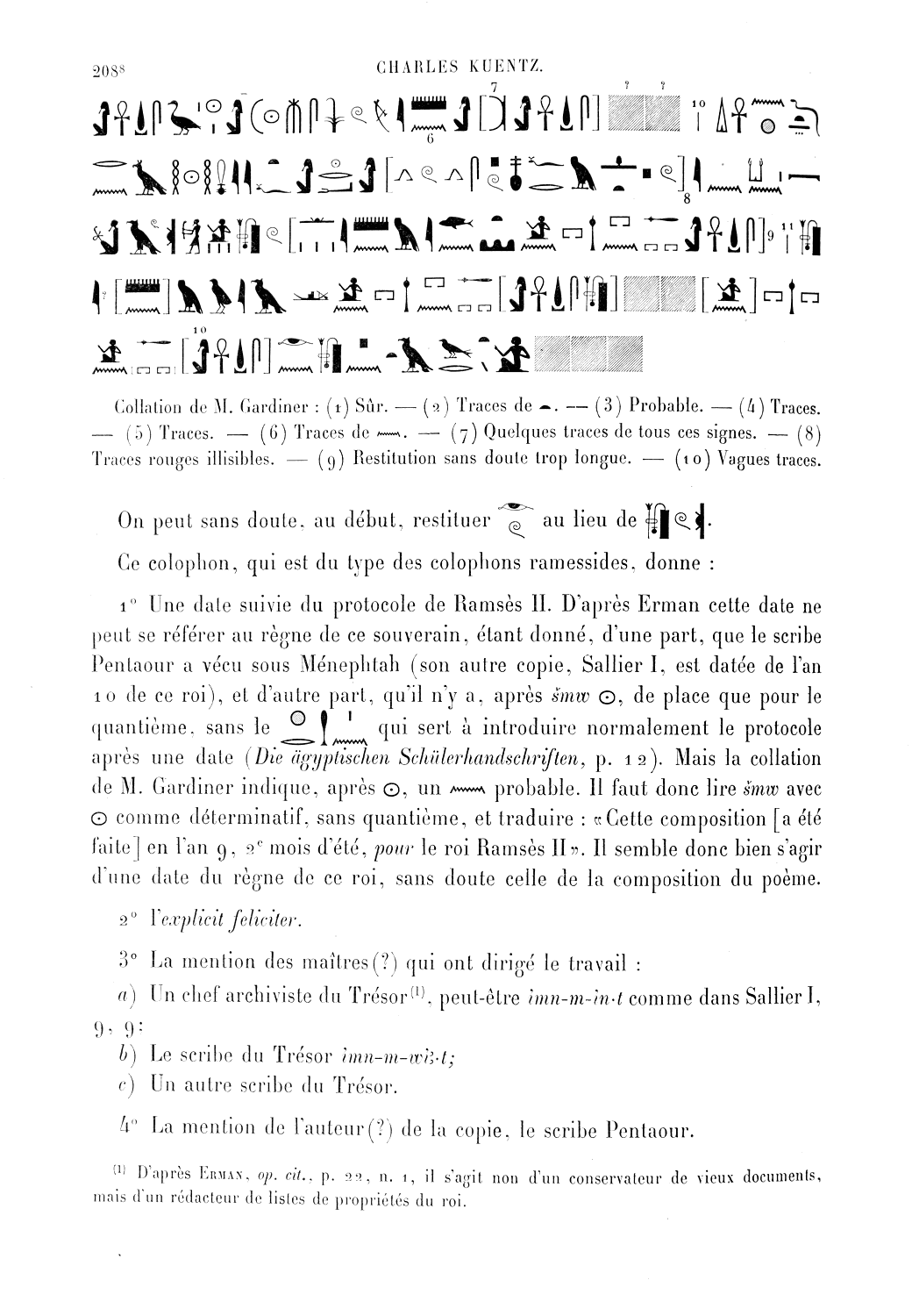

Please find attached a couple of sample pages. These are at the minimum resolution I consider to be readable. I need to have the hieroglyphs sharp and clear. Any suggestions for significantly reducing the size of the page image would be very gratefully received.

Let's see if this helps. I did this with gimp, which may behave different from photoshop.
015: Changed to greyscale mode. Adjusted levels: input levels from 70 (black) to 230 (white). Saved as JPG with 85% quality (my default). Result: 015 -_(2).jpg, 40% size. Saved as JPG with 30% quality. Result: 015 -_(3).jpg, 19% size. Changed to indexed color mode, 16 maximum levels. Saved as PNG, maximum compression. Result: 015 -_(4).png, 18% size.
225: Same process, but adjusted the levels between 85 and 215. 225 -_(2).jpg: 38%. 225 -_(3).jpg: 19%. 225 -_(4).png: 16%.
I think the 30% quality JPGs are too aggressive and blurry, but the PNGs look quite acceptable.

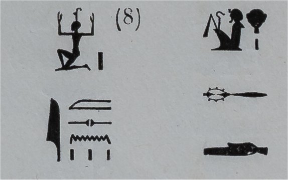

I'm sure if you enhance your contrast ratio via some of the suggestions already made, you should be able to compress to fewer shades of gray--maybe even 1 bit (just black and white), but I'm not sure you quite have the resolution for that.
The original is a camera RAW file with a resolution of 6000x4000 pixels, and a 14-bit pixel depth (ie 16000 intensity levels). See the attached full-resolution sample: you can clearly see the fibres of the paper surface.

I would aim at adjusting the level to make the background pure white. You should be able to do this by adjusting curves so that the text itself doesn't become too washed out.
Reducing to greyscale may make a JPEG a bit smaller, but if the page is all essentially text (not greyscale images), reducing the 4-bit greyscale and saving as PNG might work even better.
Could you attach full-size page images, not already reduced to a smaller pixel size? I'd be interested in having a play this evening.
