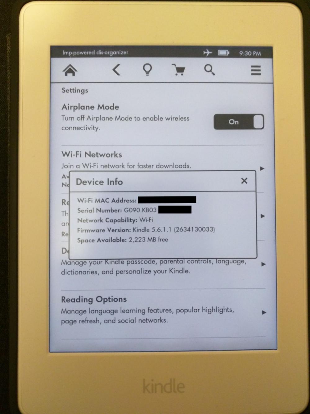

@dtrhino: Hmmm. That's annoying.
Sure it's G090KB and not G090JB?
Completely sure, I'm checking it right now, G090 KB, already downgraded to 5.6.1.1, bought from Amazon México a few weeks ago.
@knc1 I can go back to 5.8.1 without issues, in fact, I've already gone back to that version and downgraded again without any issues before I initially posted here, I just chose to remain downgraded for now.
The ;installHtml goes fine, the kindle reboots and loads something, but I don't know how to check if the key mentioned in the post is actually being created.
Do any of you want me to test anything in particular?
Edit: Added picture for proof, to keep NiLuJe's sanity

@dtrhino: Arggh. Thanks! I'll try to take care of it tonight .
Just to triple-check: That's WiFi only, right? (That, at least, appears to be consistent with my expectations, phew! ).
And, no, no need to try anything, what you're experiencing is perfectly normal, nothing you can really do (for now) on your end .

@dtrhino: On the off-chance something magical happened, could you PM me the *full* S/N?
Anyway, I've just mangled KindleTool to deal with that for now, but I haven't updated everything else yet. (And it requires an updated build of KindleTool for MRPI, which I'll launch overnight anyways).
