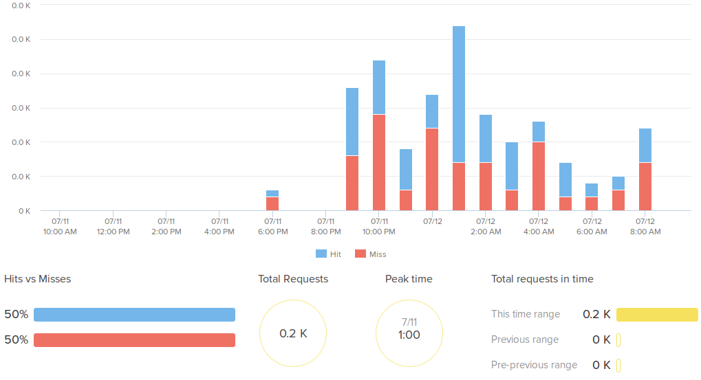

Please download this test picture:
http://cdn77.gunshi.org/testme/Alice.jpg
Everybody, all around the world, I need some test traffic on the CDN we plan to switch to.
And you can keep the picture, it is public domain.
Based on the content of that picture -
An analogy of a Content Distribution Network (CDN) with a network of rabbit holes.
In the post quoted, Alice went down the rabbit hole.
Presume all of the rabbit holes are 'watched'.
First picture, over a period of time:
Red, Alice was seen for the first time.
Blue, Alice had been there before (file was cached where seen).
Second picture, rabbit hole locations:
Gray, Alice was never seen.
The darker the shade of blue, the more often Alice was seen at that location.
And as an extra bonus -
The link in my signature once again works.
  • Usable as a 'quick check' if the network is serving your area.
  • As an explanation of my signature, for those who skipped 'Music History' (or slept through it).
ID:	150167   Click image for larger version
