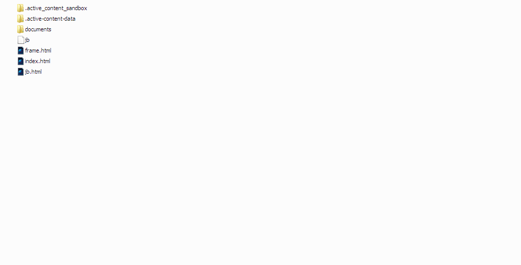

@Belenos:
Both of you -
follow the directions to put the required files in the visible root of USB storage and then take a screen shot showing what you have in USB storage.
post the screen shot.
Both of you.
Old 05-14-2016, 03:41 PM   #1008
Belenos
Belenos got an A in P-Chem.Belenos got an A in P-Chem.Belenos got an A in P-Chem.Belenos got an A in P-Chem.Belenos got an A in P-Chem.Belenos got an A in P-Chem.Belenos got an A in P-Chem.Belenos got an A in P-Chem.Belenos got an A in P-Chem.Belenos got an A in P-Chem.Belenos got an A in P-Chem.
Posts: 58
Karma: 6090
Join Date: Oct 2013
Device: PW
And:
@Belenos:
Both of you -
Both of you.
Thanks
Belenos is offline   Reply With Quote

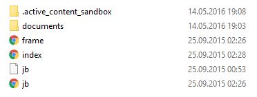

Old 05-14-2016, 03:52 PM   #1009
Vievioor
Vievioor began at the beginning.
Posts: 7
Join Date: May 2016
Device: PW2
After hard reset and jailbreak try I have this
ID:	148670   Click image for larger version

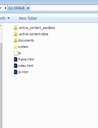

Originally Posted by geekmaster View Post
I just got a PW2 in the mail. The auction claimed "For parts or repair. The item was plugged in but would not turn on." I plugged it in, amber LED. After a few minutes it started boot looping. After about 15 more minutes it booted to the GUI. It has minor damage to the frontlight, but looks fine with the brightness turned way down. It has a LOT of books on it. It is still registered. It does not (yet) have a wifi connection. It has old firmware (older than 5.6.5).
I backed up the userstore. It is now updating to 5.6.5 (from my link above). As soon as that is complete, I will apply this JB. It worked on my PW3, so I am confident that it will work on this PW2 as well.
Update complete -- rebooting. FW 5.6.5 confirmed. Installing JB from first post in this thread. Opened experimental browser -- it is tring to load a "flight status" web page for spokaneairports.net -- interesting. Loaded file:///mnt/us/jb.html, long delay, no "jailbreak" message, but instead error popup "Application Error. The selected application could not be started. Please try again."
Device Info shows: FW "Kindle 5.6.5 (2730300038)", SN "B0D4************".
I will rerun the jailbreak. It worked on my PW3, so I wonder why problems on the PW2. His needs further study (or a serial jailbreak)...
My content is identical to the screenshot posted by Belenos above, except no ".active-content-data" folder, and an additional "system" folder.
I just restarted and then did the JB again. Same problem. A long delay followed by an error message. I wonder why this JB would work on my PW3, but NOT on my PW2. Perhaps the JB is dependent on a particular data alignment that is different on the PW2? If so, perhaps an "adjustment" might make the JB work for the PW2 as well...
The system folder is hidden, and here's the content of my wininfo
xwininfo: Window id: 0x51 (the root window) (has no name)
Root window id: 0x51 (the root window) (has no name)
Parent window id: 0x0 (none)
22 children:
0x1400004 "mesquite": ("mesquite" "Mesquite") 200x200+0+0 +0+0 MapState=IsUnMapped
1 child:
0x1400005 (has no name): () 1x1+-1+-1 +-1+-1 MapState=IsUnviewable
0x1400001 "mesquite": ("mesquite" "Mesquite") 10x10+10+10 +10+10 MapState=IsUnMapped
1 child:
0x1400002 (has no name): () 1x1+-1+-1 +9+9 MapState=IsUnviewable
0xc000bf "pillowd": () 10x10+-100+-100 +-100+-100 MapState=IsUnMapped
0xc00047 "L:C_N:searchBar_ID:system_SBTH:88_SBPH:88_SE:resu ltsPopupShow_TAP:search-bar_CMS~E:ss,cr": ("pillowd" "Pillowd") 758x88+0+37 +0+37 MapState=IsViewable
1 child:
0xc00048 (has no name): () 1x1+-1+-1 +-1+36 MapState=IsViewable
0xc00056 "L:C_N:titleBar_ID:system": ("pillowd" "Pillowd") 758x37+0+0 +0+0 MapState=IsViewable
1 child:
0xc00057 (has no name): () 1x1+-1+-1 +-1+-1 MapState=IsViewable
0x1200032 "L:A_N:application_ID:com.lab126.booklet.home_M:fa lse_PC:TS_RC:true_WT:true_ASR:true_O:U_WTNB:false_ WTPB:false": () 758x899+0+125 +0+125 MapState=IsViewable
0xc00003 "L:A_N:application_ID:blankBackground_WS:true" : ("pillowd" "Pillowd") 758x1024+0+0 +0+0 MapState=IsViewable
1 child:
0xc00004 (has no name): () 1x1+-1+-1 +-1+-1 MapState=IsViewable
0x1200050 "L:D_N:non-centered_ID:com.lab126.booklet.home_M:dismissible_ RD:false_FH:F_CD:true_TAC:search-bar_TAB:menu_RC:false_HIDE:background_BS:true_A:Ki ndleMenu": () 393x786+355+121 +355+121 MapState=IsViewable
0xe00003 "L:KB_N:keyboard_DMINSETRIGHT:5_DM:KB_DMINSETLEFT: 5_KBS:H_DMINSETTOP:54_LanH:352_PorH:352_DMINSETBOT TOM:5": ("kb" "Kb") 758x352+0+672 +0+672 MapState=IsViewable
1 child:
0xe00004 (has no name): () 1x1+-1+-1 +-1+671 MapState=IsViewable
0xc0004a "L:D_N:searchResults_ID:system_PILLOW:search-results_RC:custom_RCTL:0_RCTR:0_RCBL:11_RCBR:11_BW :2_FH:S_FS:S_CD:true_SE:resultsPopupShow_HIDE:back ground": ("pillowd" "Pillowd") 621x541+19+104 +19+104 MapState=IsViewable
1 child:
0xc0004b (has no name): () 1x1+-1+-1 +20+105 MapState=IsViewable
0xc00038 "L:D_N:pillowAlert_ID:system_PILLOW:simple-alert_M:true_SE:simpleAlertShow_HIDE:background": ("pillowd" "Pillowd") 575x314+87+411 +87+411 MapState=IsViewable
1 child:
0xc00039 (has no name): () 1x1+-1+-1 +90+414 MapState=IsViewable
0xc00044 "L:D_N:lightDialog_ID:system_PILLOW:light-dialog_M:dismissible_CD:true_HIDE:background_TAC:s earch-bar_TAB:light": ("pillowd" "Pillowd") 478x638+0+0 +0+0 MapState=IsViewable
1 child:
0xc00045 (has no name): () 1x1+-1+-1 +-1+-1 MapState=IsViewable
0x100003d "webreader": ("webreader" "Webreader") 1024x1024+0+0 +0+0 MapState=IsViewable
1 child:
0x100003e (has no name): () 1x1+-1+-1 +-1+-1 MapState=IsViewable
0x100003a "webreader": ("webreader" "Webreader") 200x200+0+0 +0+0 MapState=IsViewable
1 child:
0x100003b (has no name): () 1x1+-1+-1 +-1+-1 MapState=IsViewable
0x1000004 "webreader": ("webreader" "Webreader") 200x200+0+0 +0+0 MapState=IsUnMapped
1 child:
0x1000005 (has no name): () 1x1+-1+-1 +-1+-1 MapState=IsUnviewable
0xc00016 "pillowd": ("pillowd" "Pillowd") 200x200+0+0 +0+0 MapState=IsUnMapped
1 child:
0xc00017 (has no name): () 1x1+-1+-1 +-1+-1 MapState=IsUnviewable
0x1000001 "webreader": ("webreader" "Webreader") 10x10+10+10 +10+10 MapState=IsUnMapped
1 child:
0x1000002 (has no name): () 1x1+-1+-1 +9+9 MapState=IsUnviewable
0xe00001 "kb": ("kb" "Kb") 10x10+10+10 +10+10 MapState=IsUnMapped
1 child:
0xe00002 (has no name): () 1x1+-1+-1 +9+9 MapState=IsUnviewable
0xc00001 "pillowd": ("pillowd" "Pillowd") 10x10+10+10 +10+10 MapState=IsUnMapped
1 child:
0xc00002 (has no name): () 1x1+-1+-1 +9+9 MapState=IsUnviewable
0x400002 "L:SS_N:screenSaver_FH:F_module:screensaver_ID:bla nket-screensaver_FS:F_O:U": () 758x1024+0+0 +0+0 MapState=IsUnMapped
0x600001 (has no name): () 1x1+-1+-1 +-1+-1 MapState=IsUnMapped
0x600000 (has no name): () 1x1+-1+-1 +-1+-1 MapState=IsUnMapped
Old 05-14-2016, 04:09 PM   #1012
Vievioor
Posts: 7
Join Date: May 2016
Device: PW2
right, the same in my
Vievioor is offline   Reply With Quote

I always set all my WinBoxen to show file extensions, and to show all files and folders. If all user accounts need mostly administrative level user rights just to function, what is the point of hiding stuff from you?
Old 05-14-2016, 04:21 PM   #1014
Vievioor
Posts: 7
Join Date: May 2016
Device: PW2
My bad. I didn't think that there can be hidden folders, despite the selection "hidden folders" windows didn't show them to me.

https://www.mobileread.com/forums/sho...0&postcount=15
