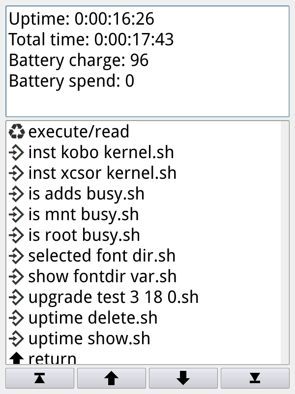

Whenever you want to check the status you have to goto KSM and navigate to scripts>tests>returntests.msh and execute the "show uptime.sh" script.
You will get a reading of:
Uptime: 0:00:01:56
Total time: 0:14:06:23
Battery charge: 65
Battery spend: 22
If you want to restart the measurements (after a partial or complete charge) you have to execute the "delete uptime.sh" (found in the same place) which deletes the uptime.txt.
You have to restart the device after that to start fresh.

Note: Looking at the screen shot again I notice that "battery spend" sounds strange.
It looks like your battery meter didn't change since the first entry in the uptime.txt.
Remember this is measuring the consumption of the "Total time" not how much is missing from the 100%
It should change.
If it doesn't, then there is something different in the environment variables of the touch (which I highly doubt)

I have no problem with the "0." I meant to say that the expression "battery spend" sounds strange to me. I would rather expect "battery discharge," "battery discharged" or something like that. But since I am not a native English speaker, I cannot really propose anything.
I'm also foreign to the English language.
I like the "discharge" version.
Maybe some native English speaker can enlighten us?

I couldn't find any way to do that.
If you find way for measuring suspended time, please inform and update script.
And about message, battery spent is correct. But it can be also discharged, it isn't that important.

I wrote some instructions for using the uptime.sh script with KoReader.
I tested them with KSM7 and it *should* work with KSM8, but if someone try it, please post the results.
