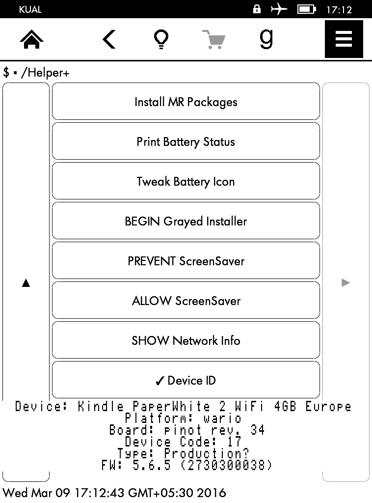

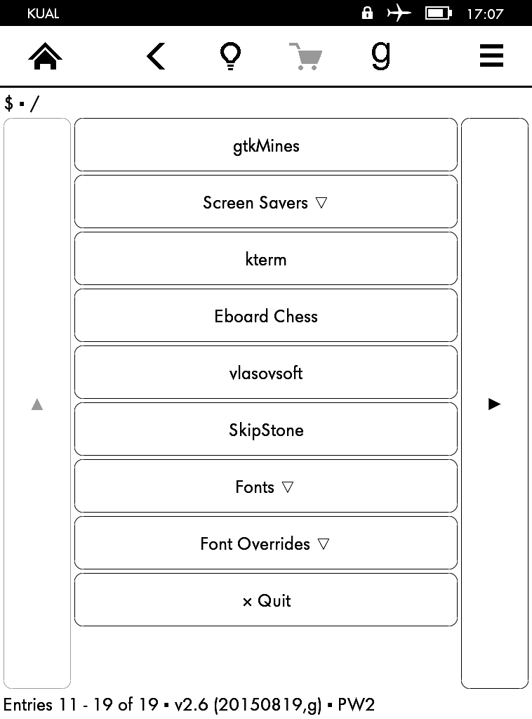

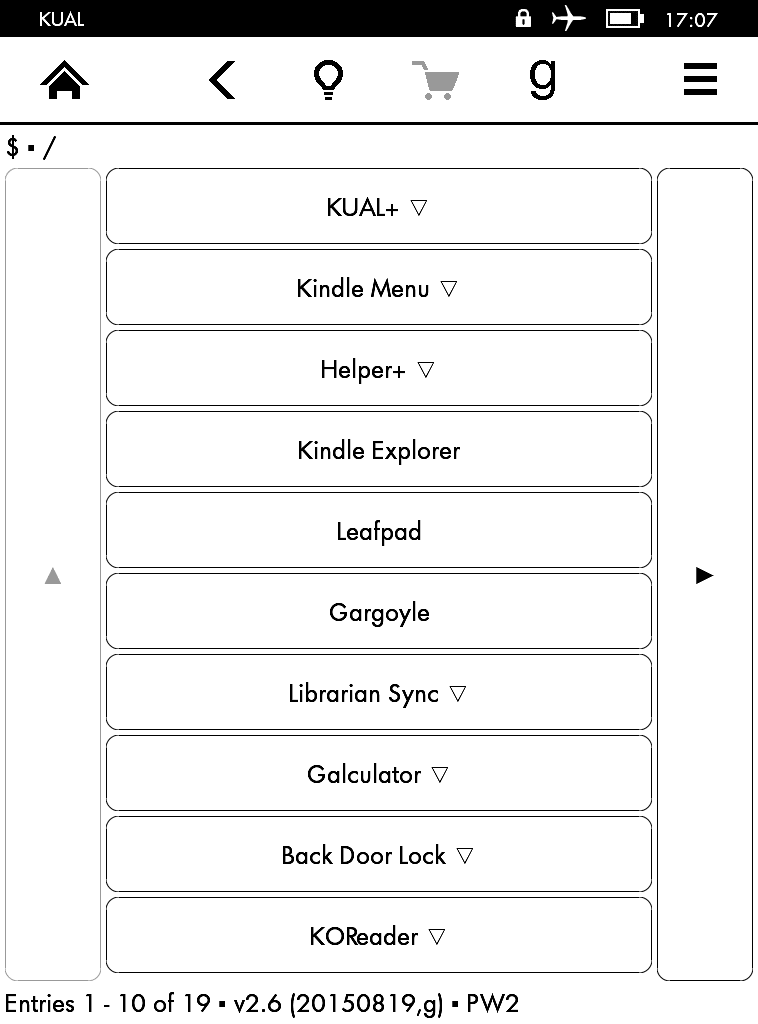

Please re-check what firmware version your device is running:
home -> menu -> settings -> menu -> device info
Please mention what other things of ours you have installed on your Kindle, and if they are all still working.
Old 03-09-2016, 07:02 AM   #225
mitra
mitra began at the beginning.
Posts: 52
Join Date: Jan 2016
Location: Mumbai
Device: Kindle PW2
That was quick.
FYI, I have attached the screen shot of all Kual extensions and firmware i run. I should say all are working fine except the librarian sync. I just double checked it now. I checked python from cover screen saver option is working fine.
Besides the Kual extensions, I have installed few .bin files installed.
Those are rescue pack, coward rescue pack, python pack, screen saver pack, font pack and mrpi pack.
In Vlasovsoft, I have the default basically i use cool reader sometimes. Still to name it includes Cool reader, file manager, Opds_alpha, chess, checkers, sokoban, reversi, gomoku, takuzu, sudoku, dictionary, notepad, calculator and wifi.
Basically, I have been running librarian sync for quite a while. I use it to update collections from calibre plugin. Whenever, i used to face such error while updating calibre collections plugin. I used to delete all collections and then run the folder directory collection, it always worked as a collection and then i use to update calibre collection smoothly. But today, it somehow did not work. Even yesterday, it worked fine.
Between today and yesterday, i did not install anything. The ones i installed today were after error from snapshot of niluje hacks. I saw every pack was updated so i installed all 5 bins again (same as above). Though, i must say i didnot uninstall any .bin hack before installing the new version. Also, I put all 5 .bin files together it ran beautifully in order of python, rescue pack, coward rescue pack, font and screensaver. Impressed!!!
Thank you.
