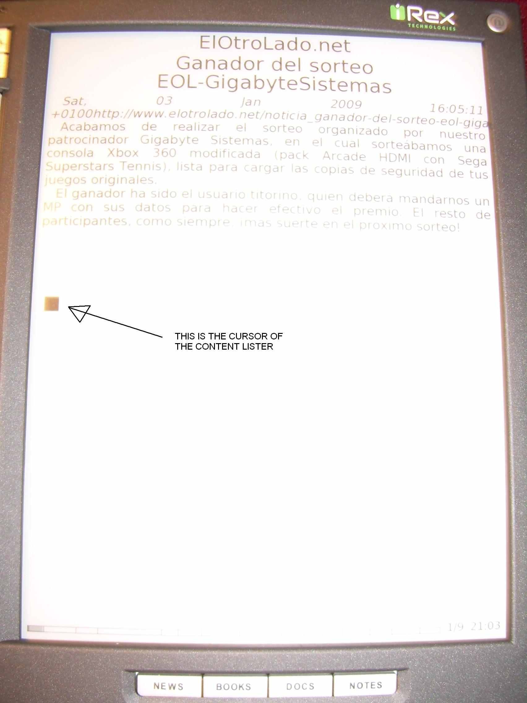

If I press the "Books" button, for example, the iliad "goes there" but without refreshing. You can see what I mean in the photo attached.
Name:	after pressing books button and arrow.jpg

The "books" button, and the other three below the screen, can't be used from FBReader (because FBReader never sees these button presses and so is still running). Usually the contentlister then comes up, but FBReader won't run correctly the next time you open it.
The only way to exit FBReader is the top left quit button. If you used the quit button and the 2nd zip did not work, then I am out of ideas. It is possible to change the registration so that HTML goes to FBReader (assuming the zip is the problem), but I am wary of changing the default entries.

PERFECT!!!
That was the problem: I kept pressing the "News" button to go out and choose another newspaper to read.
Now I know that I have to press the top left button to quit the fbreader.
Thank you, now the second zip opened without problem!
