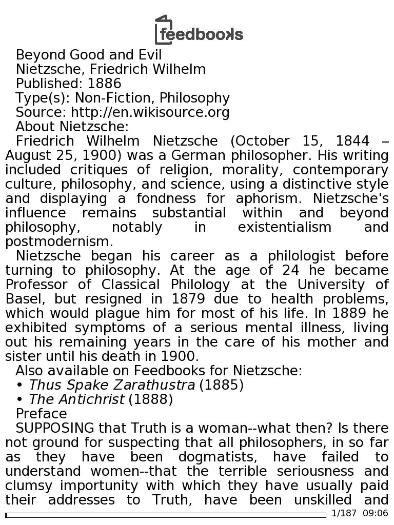

Based on a support thread I made, file extensions supported are:
  • chm
  • rtf
  • oeb
  • opf
  • epub
  • fb2
  • tcr
Because the toolbar is gone, most of the important functions can now be accessed by the hardware buttons:

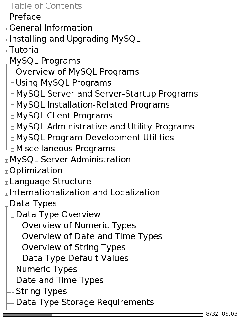

    • Short Press
      • Previous TOC Section
    • Long Press
      • Increase Font Size
  • Dot or "Enter" Button
    • Short Press
      • Show Table of Contents
    • Long Press
      • Rotate Page

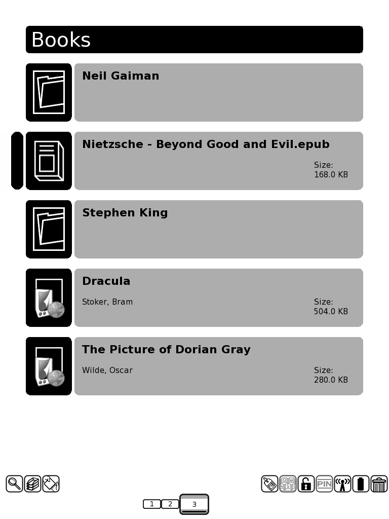

There will be no icon to run FBReader, you'll need to select a book from the contentlister with one of the file extensions listed above.
Supported books will have a valid icon.
ID:	10240   Click image for larger version
ID:	10241   Click image for larger version

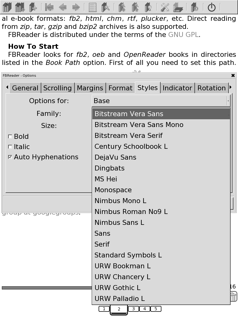

The first thing I changed was the default font. I don't like DejaVu Sans.
URW Bookman L looks much better, but tastes differ.
The information lives here: /mnt/settings/.FBReader/ui.xml
ID:	10332   Click image for larger version
ID:	10333   Click image for larger version
