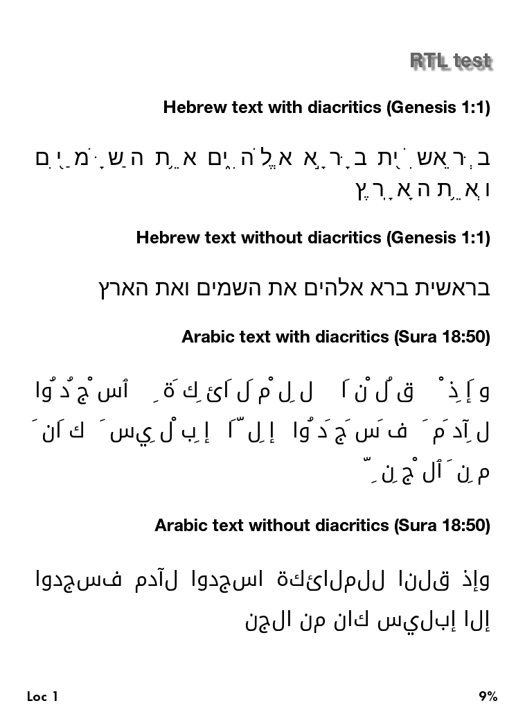

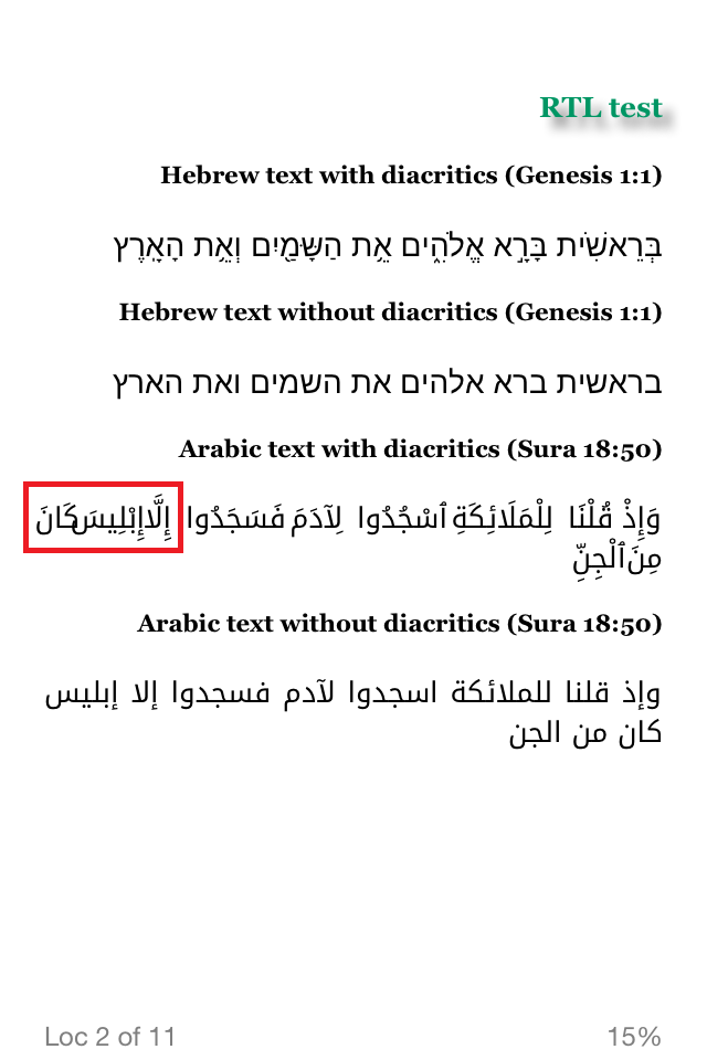

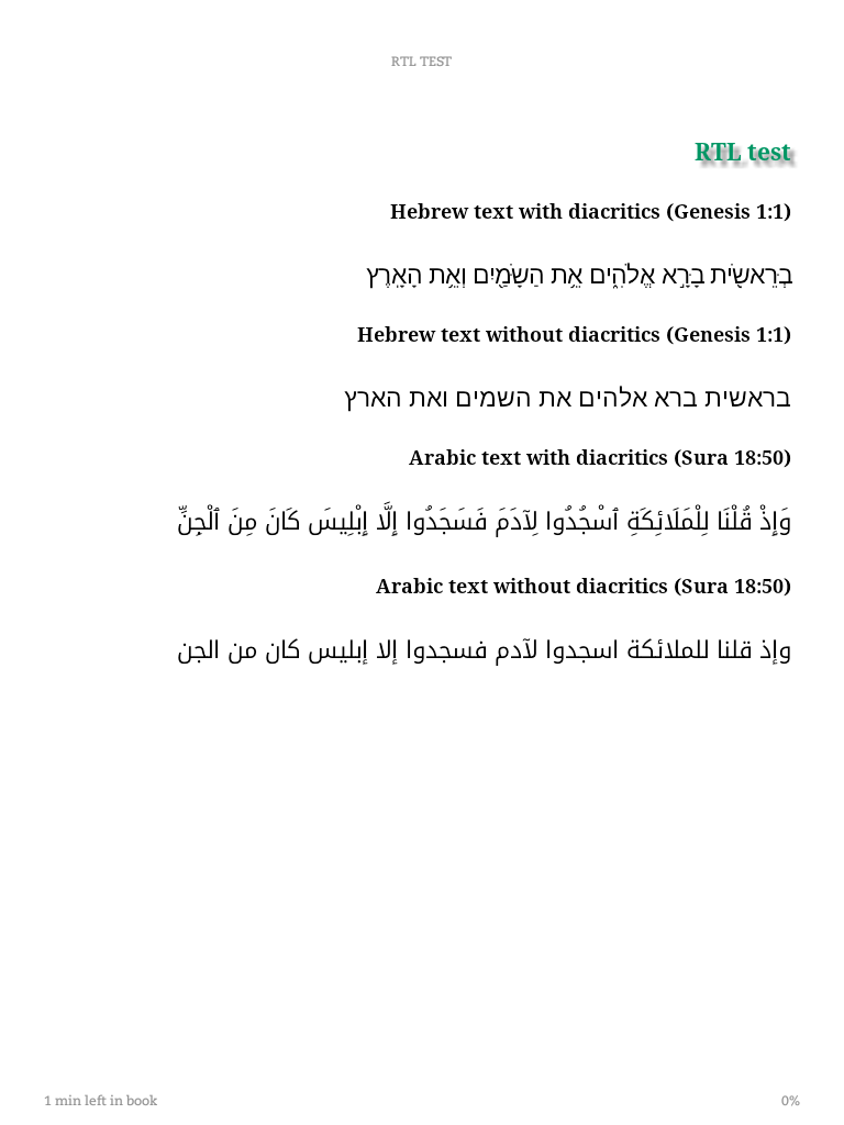

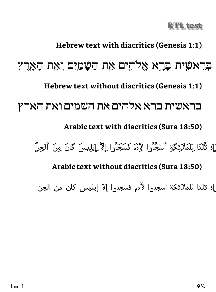

Old 08-25-2015, 08:27 AM   #300
Doitsu
Doitsu's Avatar
Posts: 5,804
Karma: 24088595
Device: Kindle PW2
Originally Posted by tomsem View Post
But kerning and ligatures should be rules that are declared in the font files themselves. My Paperwhite 1 doesn't do either, or maybe the font files on there have had these rules removed (noting that arabic and indic scripts require ligatures and these appear to render correctly).
5.6.5. firmware eInk Kindles display RTL text correctly in AZW3 files and files generated by KindleGen/Kindle Previewer.
However, they still don't display AZW3 Kindle books with embedded RTL fonts correctly: Arabic glyphs are being displayed as isolated forms and both Arabic and Hebrew vowel signs are being displayed next to letter instead of above or below them.
The Kindle for iOS app generally displays embedded fonts in AZK books fine, but has problems with some Arabic glyphs. (iBooks has the same bug.)
IMHO, the Kindle for Android app displays the embedded Arabic glyphs best.
ID:	141401   Click image for larger version
