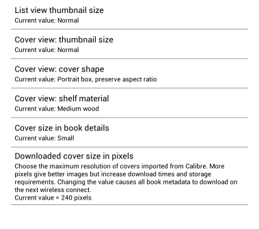

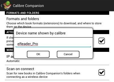

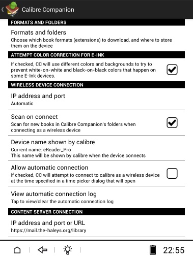

I did see some places where it's fixed, but there are still some places it didn't help. Like Device name shown by Calibre and everything under Covers and thumbnails. I didn't look much further.
Now that I have a separate option I can now use a bigger hammer to fix the preferences screens. I made the necessary changes. My T62 now shows the dialogs you mention, albeit with different "colors" than the rest of CC. Here are three screen captures from my T62+ with the setting checked:
ID:	138371Click image for larger version
ID:	138372Click image for larger version

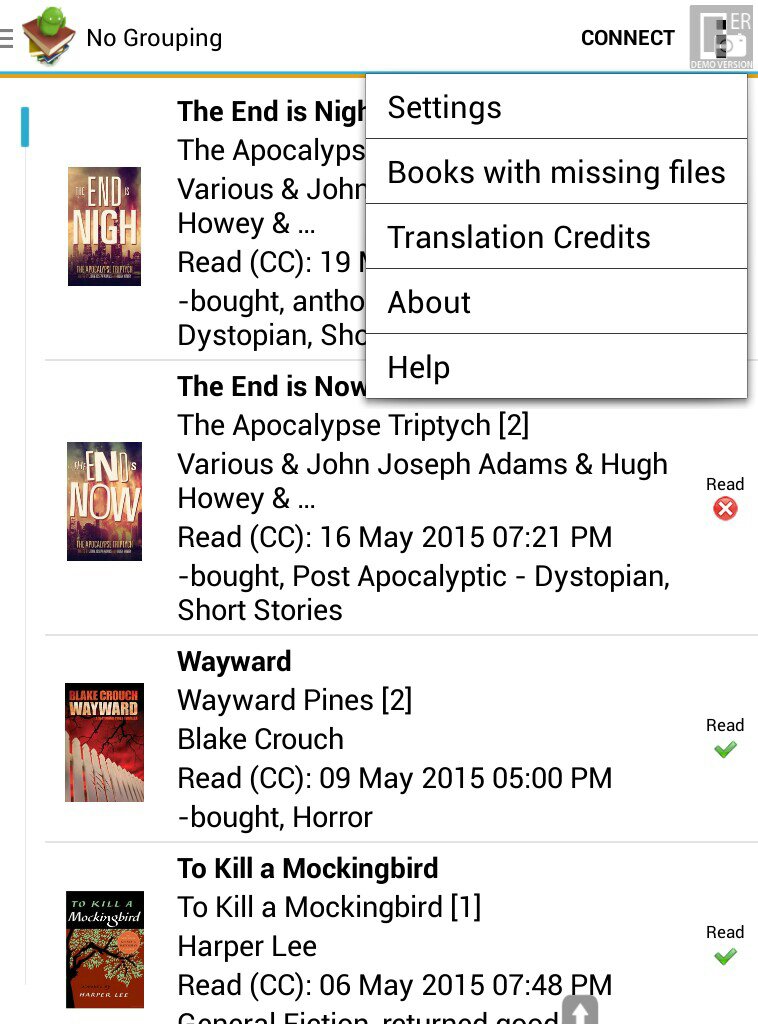

Location: Pennsylvania
I seem to have lost the sort and cover grid icons on my T62.
