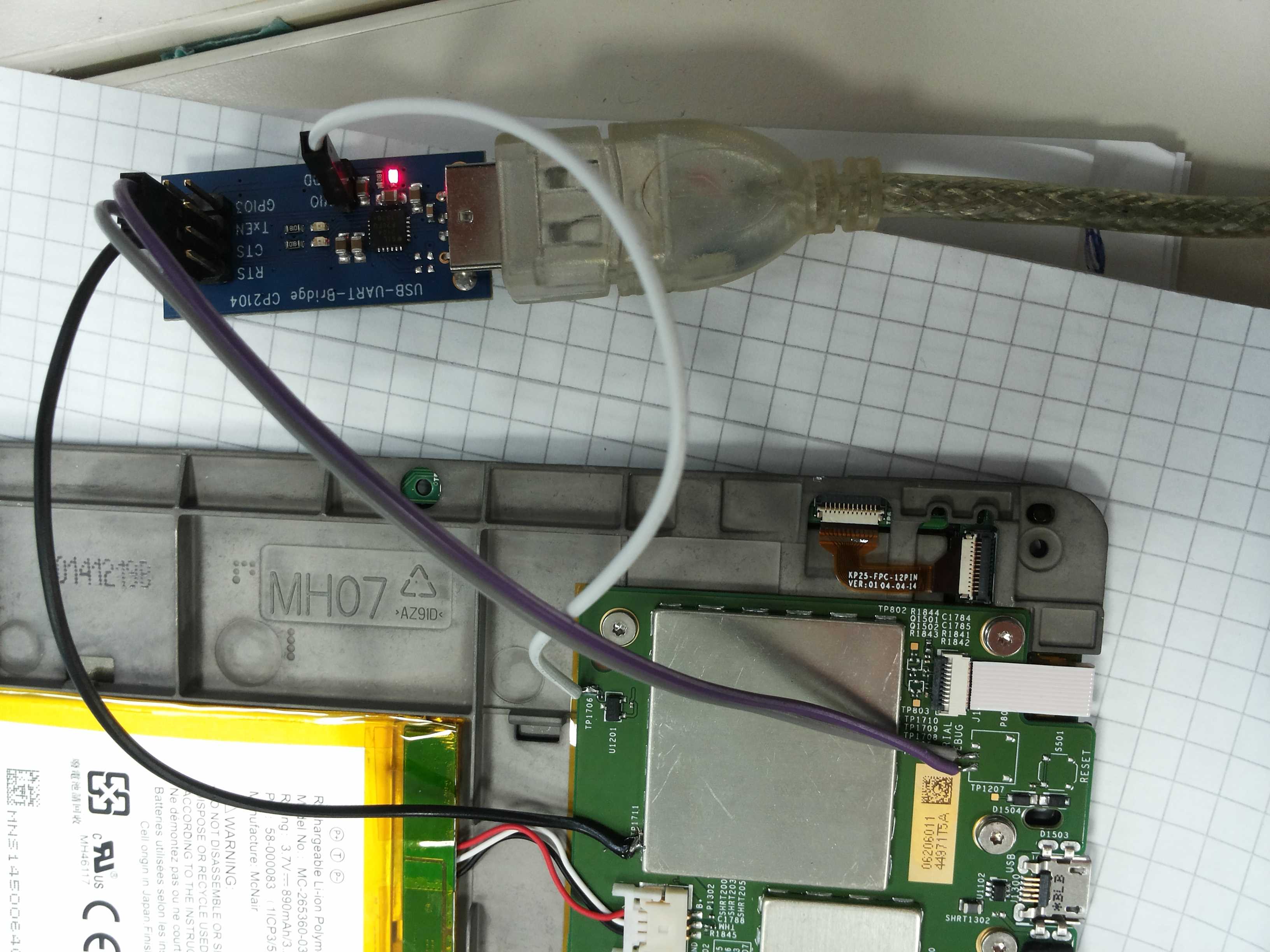

Nice work. How exactly did you do the 1.8v serial connection?

I used this device USB UART Bridge CP2104 its voltage level is adjustable from 1,8V - 5V over the VIO-pin.
Therefor I placed the missing 2,54 cm pinstripes and used jumperwires for the connections.
Normaly I playing around with microprocessors and arduinoboards, so I have plenty leying around...
I made the hack on a KindleTouch2 it has the same FW (5.6.1.) like a PW2 but a little different hardware, so Im afraid you have to get other solderpoints on the device.
and I took the lvl of the kindle, like knc1 told in his KT2 Exposed Thread
On the picture:
white cable = VIO (1,8V)
black cable = GND (getting same potentials)
purple cable = Tx
gray cable = Rx
Last edited by volkaoth; 01-23-2015 at 02:27 AM. Reason: answering for a PW2 owner

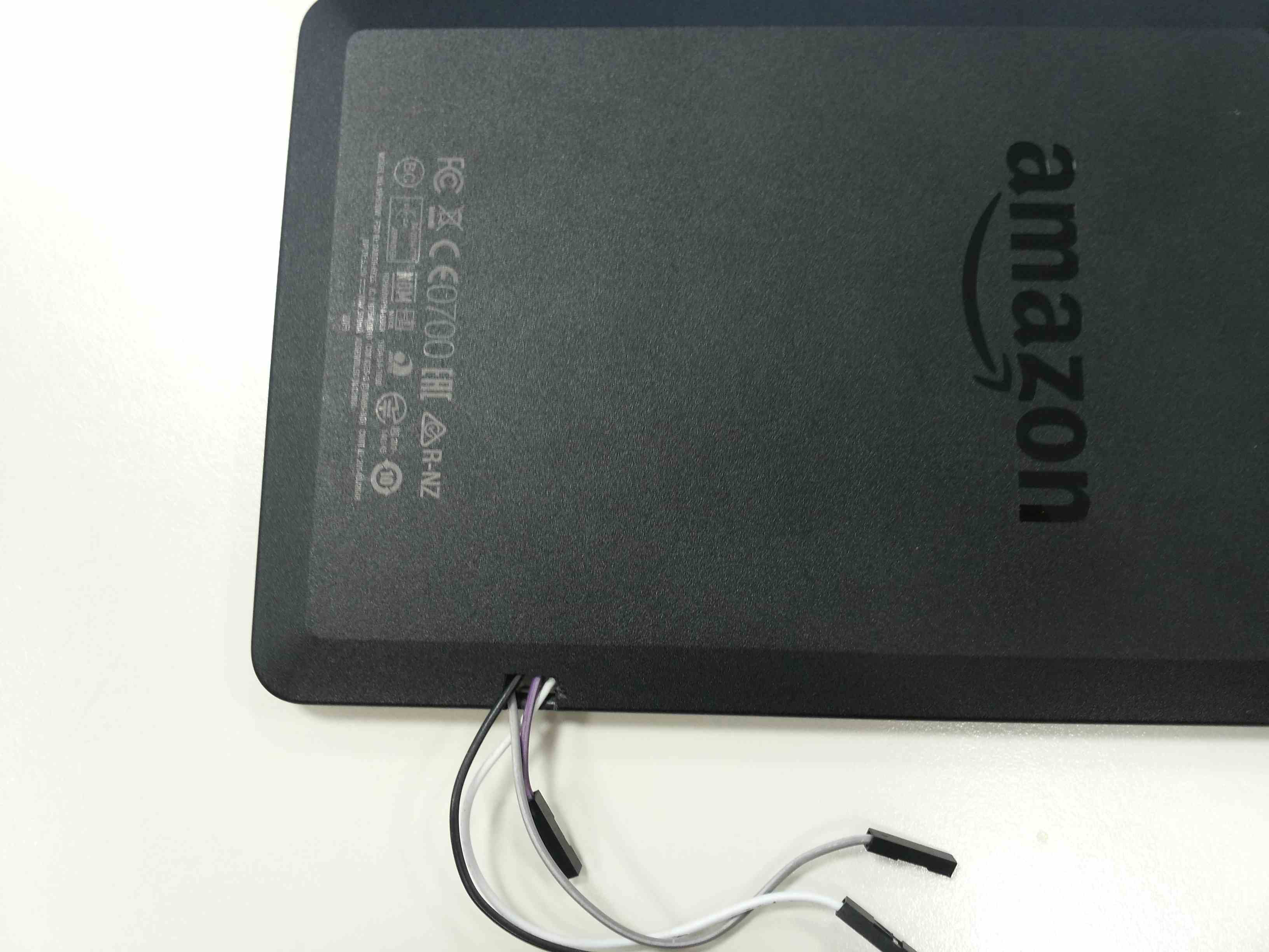

last part: remantle.
The place is good, there is enough space left placing the cables.
It looks a little sloppy but a 4-pole connector will change this also.
volkaoth is offline   Reply With Quote
Old 01-28-2015, 02:54 AM   #41
knc1
Going Viral
knc1's Avatar
Posts: 17,212
Karma: 18210809
Location: Central Texas
Device: No K1, PW2, KV, KOA
There is a thread here, well illustrated, of how one person added a connector to the bottom edge of a ....
Hmm... K5 I think (not that it matters, all the cases have a similar squared off bottom edge where the usb connector, charge light and power switch live) .
