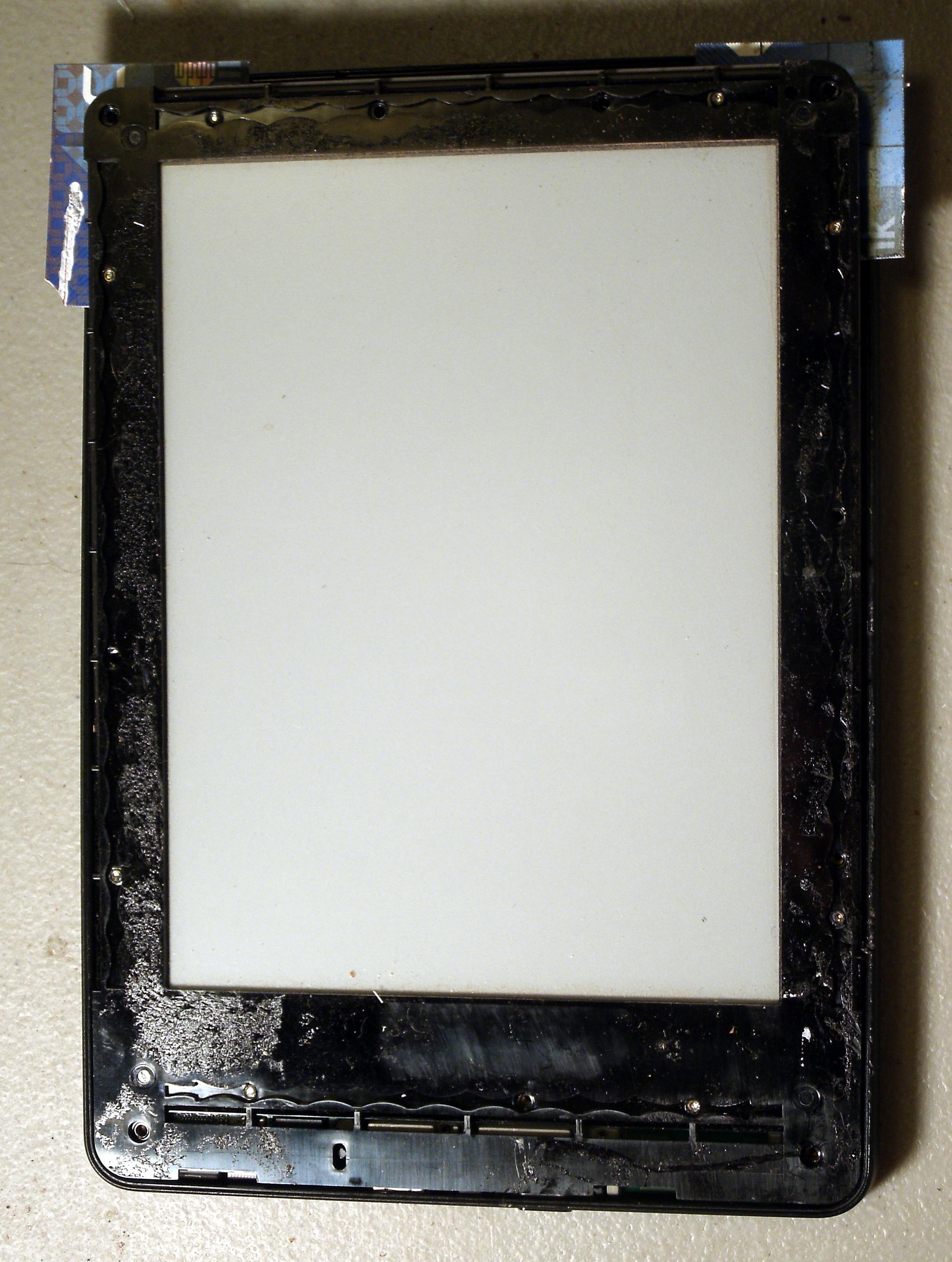

peel-1
Starting at an upper corner -
Using a thin, plastic tool (or credit card) -
Work down one side, work across the top, work down the other side.
Leave a trail of <something> (shown, glossy faced cardboard) behind so that the bezel glue doesn't grab the body again.
peel-2
Leaving the bottom for the last peel&pry effort, (gently) rip that little sucker off the face of the body.

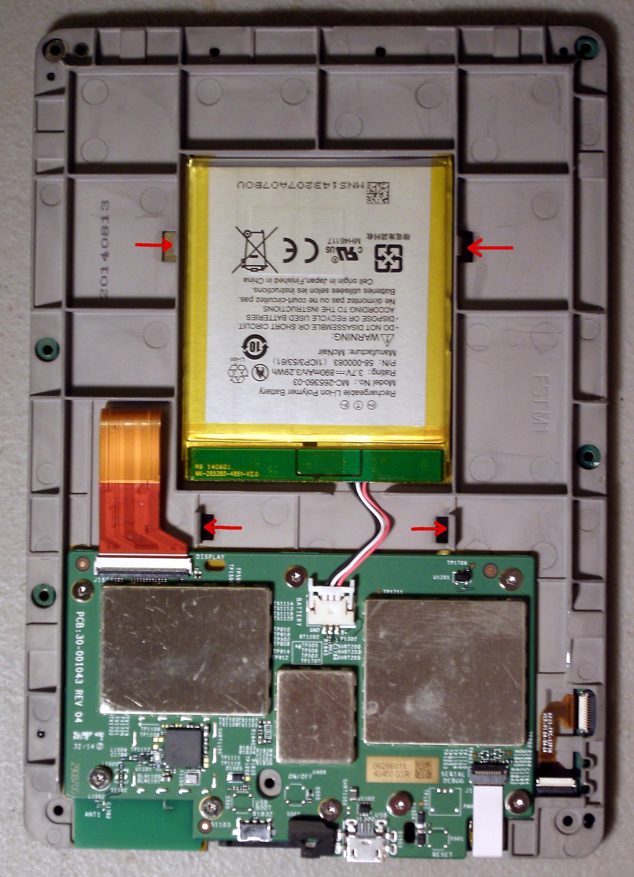

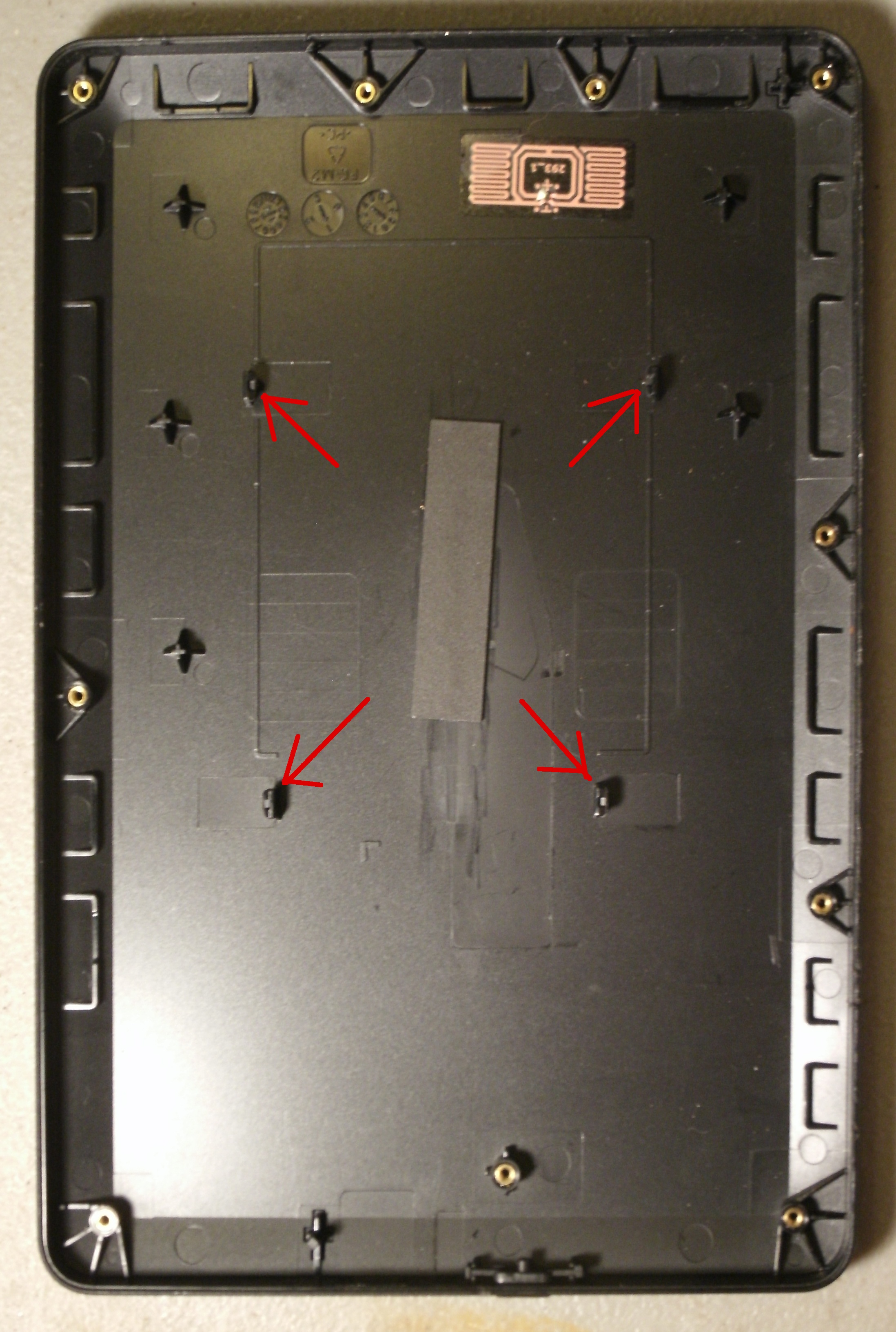

unscrew
The Kindle hardware assembly is held in the bottom (or back) case pan by 10, T-5 (torx) socket head screws.
The red dots are just below the ones you want to remove.

pry-it
Using your thin, stiff, plastic tool (or strips of credit card) - -
Work up the two upper corners enough so that you can "bridge" the corner radii with the cards.
This leaves the e-ink display frame sitting on top of the plastic wedges, which are resting on the top edge of the case pan.
Thou shall be gentle from this point on - since bending the e-ink frame is detrimental to the display's operation.
It probably will not do the touch screen any good either.

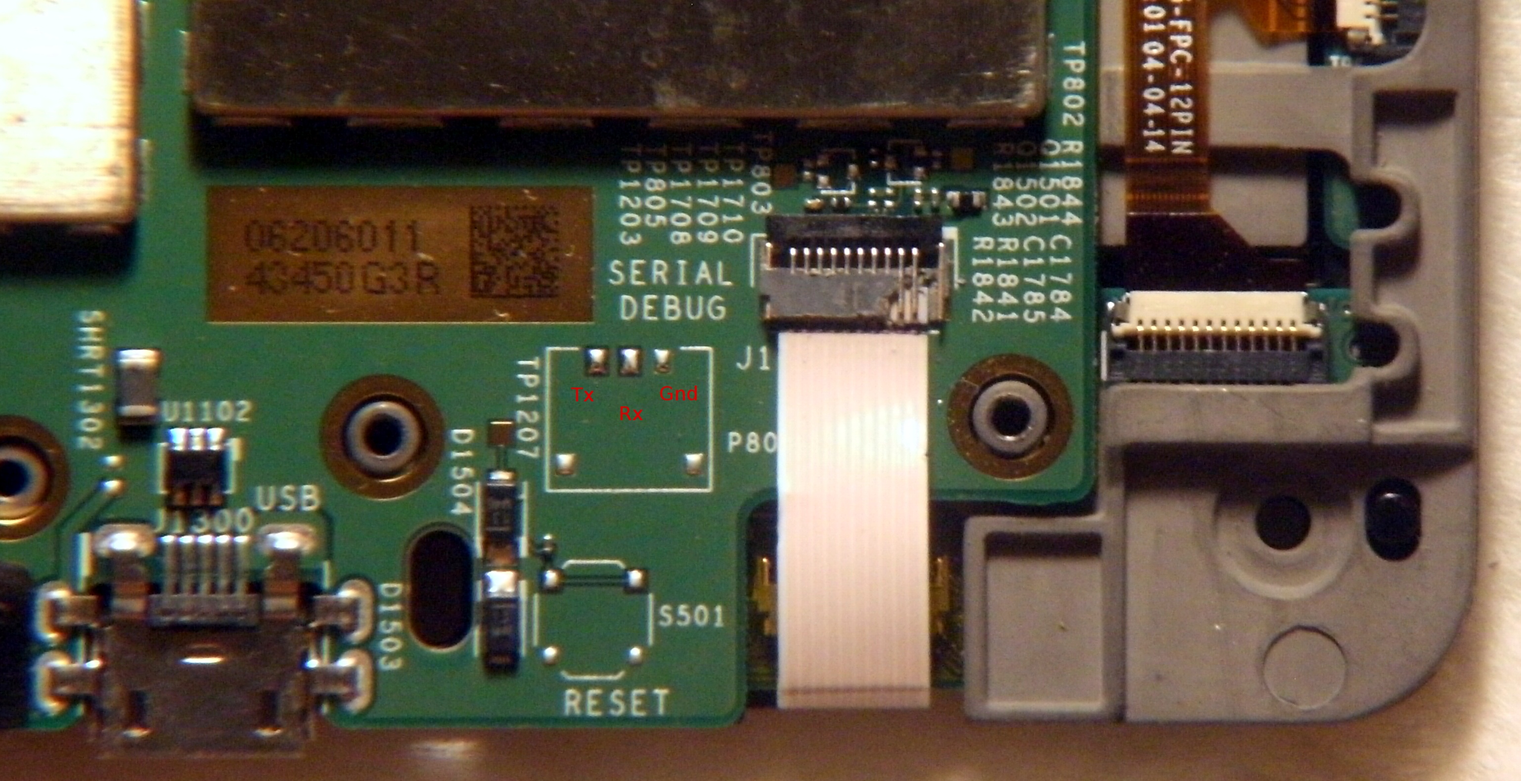

bottom-right
Here you will find two, unpopulated, pad sites.
The serial port connector pad (Kindle functions in red added) and a place for the hardware reset button.

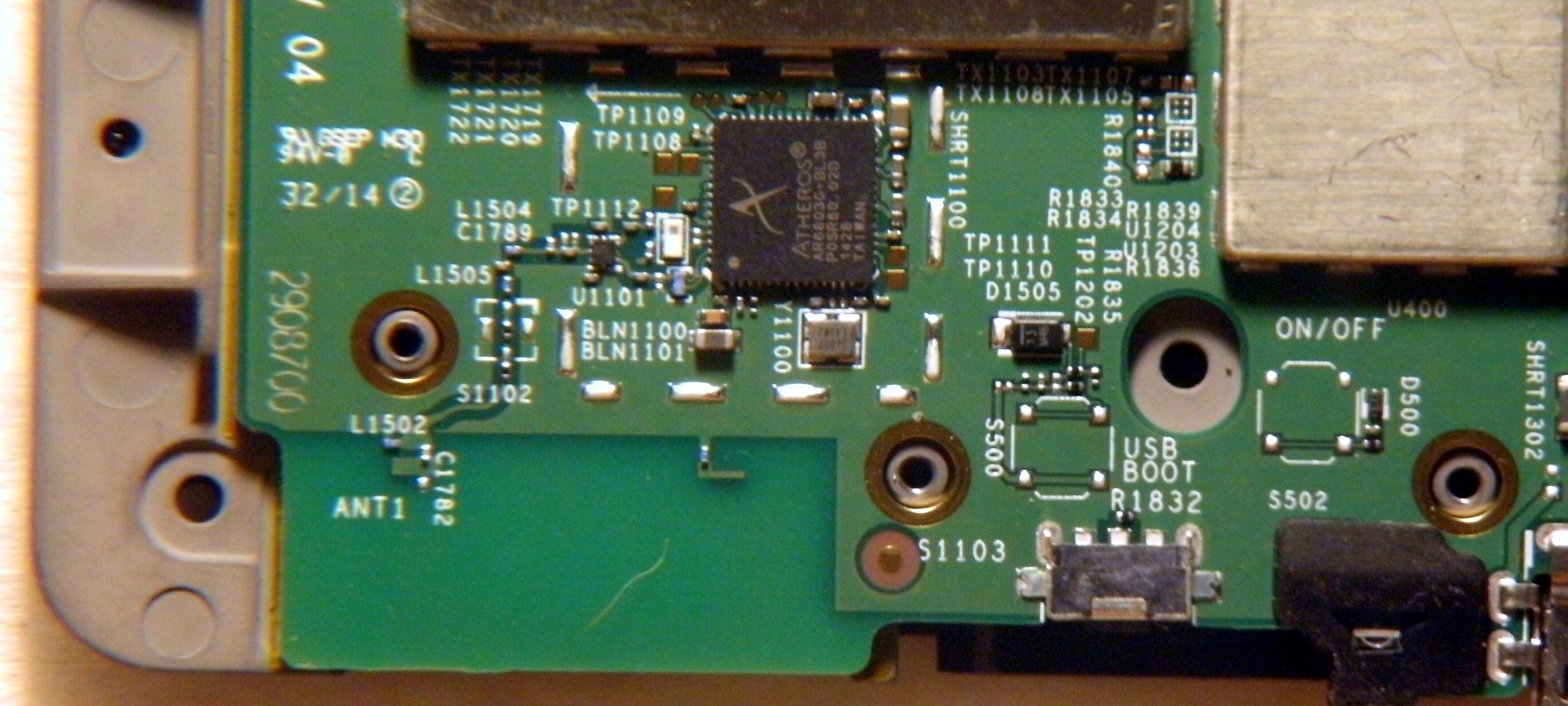

bottom-left
Here you will find two more, unpopulated, pad sites.
One for the power on/off toggle button and one for the switch to enable booting from the USB device.
And in the left-most corner of the board, the Wifi antenna.
Note that is the right-most corner of the Kindle when looking at the display.
ID:	130772   Click image for larger version
ID:	130773   Click image for larger version
ID:	130774   Click image for larger version
ID:	130775   Click image for larger version
ID:	130776   Click image for larger version
ID:	130777   Click image for larger version
ID:	130778   Click image for larger version
ID:	130779   Click image for larger version

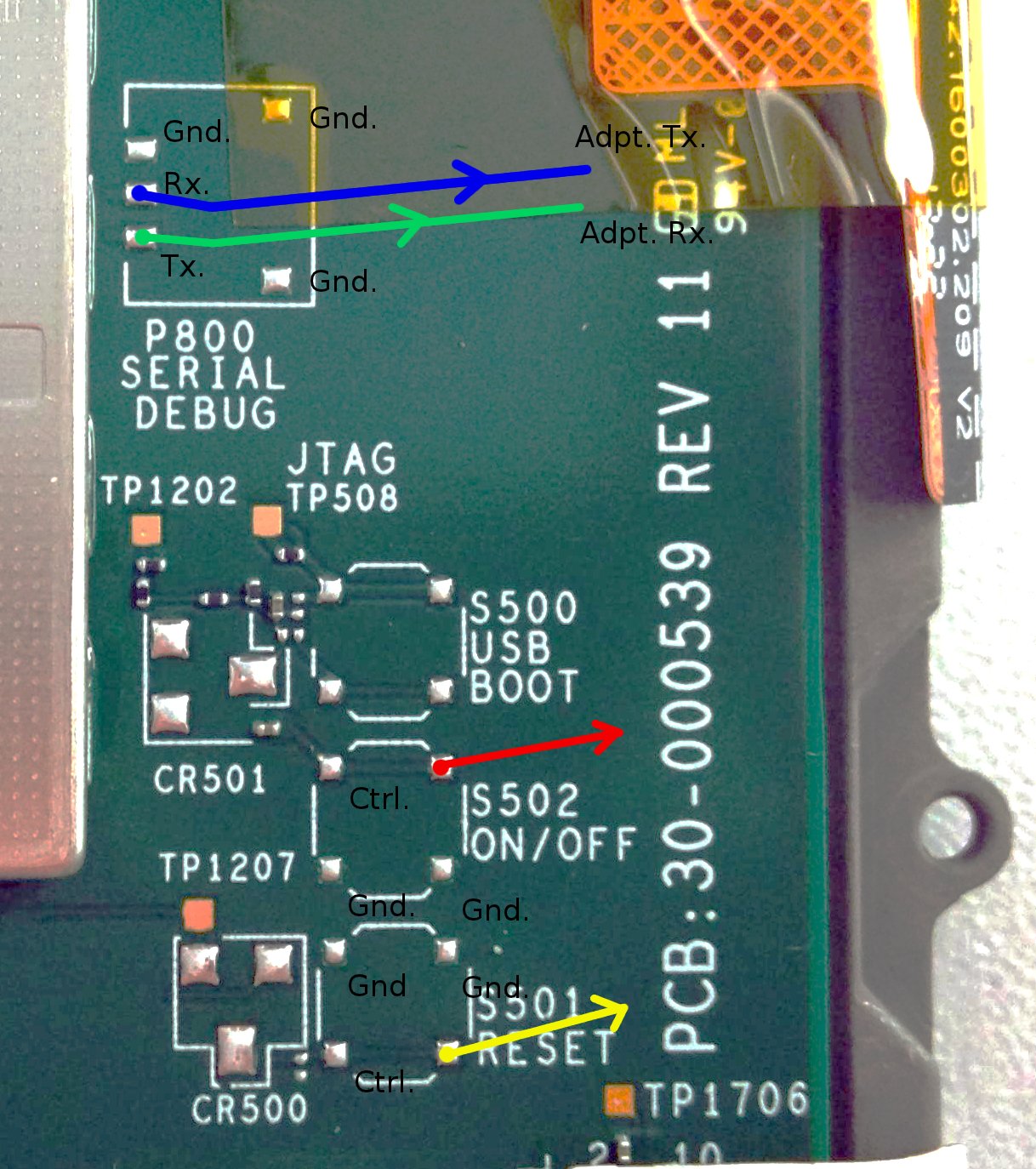

KT2 - Controls

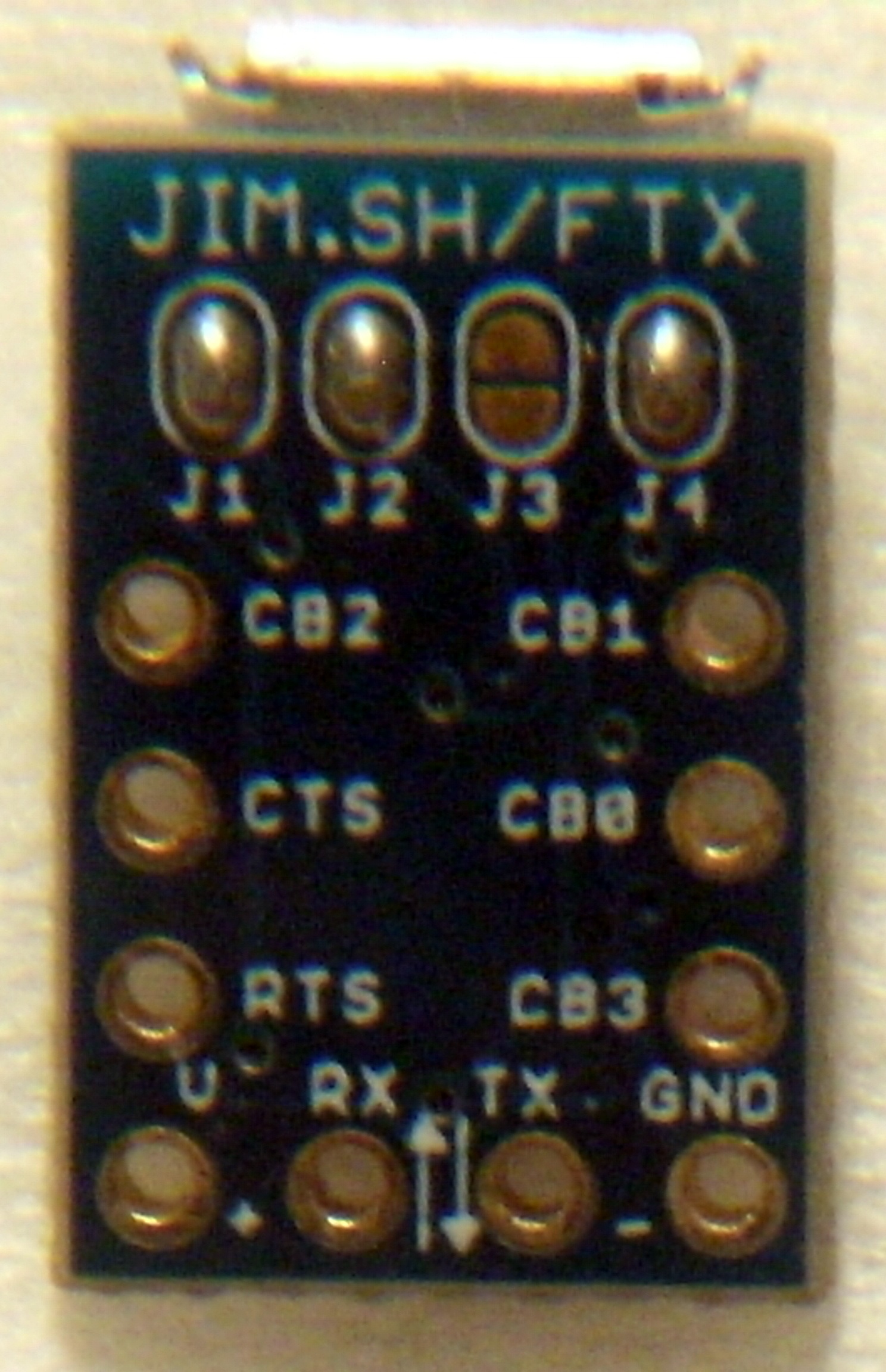

Micro-FTX
As shipped, unless otherwise requested, is configured for 5v0 i/o levels.
(Attach-1: ftx-bottom)

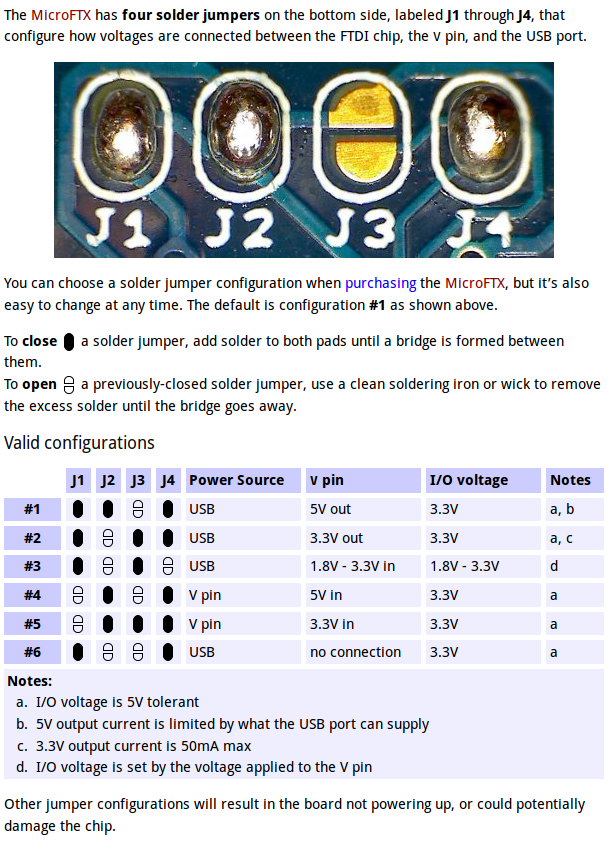

FTX Jumpers
Since the Kindle uses 1v8 for its serial port, and other controls, the jumpers have to be changed to configuration #3.
(Attach-2: ftx-jmpr)
FTX I/O References
A usable (very quiet) ground and a 1v8 reference for the FTX can be found at the top right of the KT2 board.
(Attach-3: adptr-io-ref)
Serial Port
The "Serial Debug" pad site is wired to the FTX (only Rx and Tx) in the usual manner.
(Attach-4: serial-port)
Hardware Reset (reboot)
This control lead is pulled up to 1v8 and protected from noise by the adjacent resistor, capacitor, and diode combination.
Either pad on the cntrl lead could be used, but to spare some possible grief the pad furthest from existing parts will be used.
(Attach-5: reset-cntrl)
Power on/off
(Attach-6: power-cntrl)
USB Boot
This control pair require a more sophisticated handling than a simple connect to ground (like the two controls above do).
Also, these control leads from the SoC are driven by one of the 3v3 supply rails.
The result of those two facts will require a few parts to interface the boot-mode leads to the FTX bit controls.
FTX CB Leads
These leads will have to be re-configured from the factory default by re-programming the chip's on-board eeprom.
But the Micro-FTX board supplies 4 such control bits and we need only 3 of them.
The re-programming of the Micro-FTX will be the next step in taking control of the KT2. Ah, which is the reason I did not indicate which of CB0 ... CB3 will be used on the pics. ('cause I don't know yet )
PS:
Yes, the power on/off and the reboot (hardware reset) have been confirmed to be working as expected.

PW2 - Controls
I took leedjc's PW2 picture from: https://www.mobileread.com/forums/sho...96&postcount=9
(Attach-1)
And GIMP'd it almost to death to supplement this thread for the PW2 owners.
(Attach-2)
Not shown is a good place to pick-up the 1v8 interface reference lead.
Someone with an open'd PW2 please assist in finding a good reference point to use.
Edit:
One 1v8 location shown in this post:
https://www.mobileread.com/forums/sho...25&postcount=3
(Attach-1)
(Attach-2)
After GIMP'ing that PW2 pic some more (see attachment), I am not sure if the control leads have been de-populated or not.
Someone with an open PW2 please check S501 and S502 pad sites for me.
Hint: helps if you have a mirror so you can watch both the display and what you are doing on the back-side.
Tests:
Use a short, stiff, length of light gage, insulated wire - stripped bare at both ends. Something like 20 .. 24 gage solid wire will do fine.
Hold by remaining insulation (I.E: protect Kindle wiring from human body static).
Momentarily connect one of the called out, proposed, connection points to gnd.
S501: Expect an immediate, hardware triggered, full re-boot.
S502: Expect the Kindle to "turn off" (with cleared screen) or to "turn on" (I.E: resume).
If the missing CR500 and CR501 are required, nothing will happen (nor will any harm be done).
If they **are not** required - then the controls should work as expected (and no harm will be done).
Note: the above tests have been performed on the KT2 and they work exactly as labeled.
Note: You might want to forego the coffee for a few hours prior to the above testing - -
The test points are a tad bit smaller in real-life than shown in the picture attached.
Steady hands are required.

Due to the overwhelming non-response from PW2 owners, I will drop that from consideration for now at least.
For use in the KT2 - the MicroFTX board really needs to be built in a low profile version.
I.E: Currently has a surface mount micro-usb connector, needs to have a micro-usb connector that mounts with its centerline on the board centerline (like at least some kindles have).
For now, I will just fake it by physically hacking up a high profile version into a low profile version.
Lucky for us, Jim Paris has OpenSourced all of his design files:
http://jim.sh/ftx/#design-files
The PCB board layout requires (at least) Eagle V.6:
http://www.cadsoftusa.com/download-eagle/?language=en
But I think that the "Freeware" version should also work:
http://www.cadsoftusa.com/download-e...e/?language=en

Added drawing of typical mid-mount, micro-usb connector for the low profile adapter board as attachment-5.
Edit-3:
Added tech. sheet on switch chip.
The MicroFTX "cb" outputs are open-drain with a 75k ohm pull-up.
So far, the chip's I/O cells are referenced to 1v8 (since that matches the serial port I/O levels).
But the boot-mode lines need to be connected together (I am assuming here) to emulate a mechanical switch.
Plus, they are running on the 3v3 supply rail(s).
Hence, the added-in, switch chip.
And since they come in four per package ...
There are enough for all four "CB" outputs, if required by another project.
Edit-4:
Added tech. sheet on level translation chip.
Decided on setting up the layout to hold 2, 2 bit wide, level translators.
Which seems to be the most generally useful layout, even though we only need one (or maybe two) bits worth (I.E: a single chip) worth of translation.
This chip will handle any (common) logic level found in today's logic (except 1v2 and 1v5 cell phones) and translate it to any of the choosen adapter chip's i/o levels (1v8, 3v3 or 5v0).

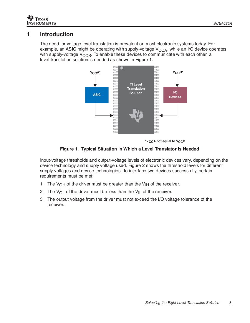

Overview, Level Translation
An overview of current level translation challenges in modern digital devices.
This overview is two pages from a TI technical note, so just ignore the "buy TI" bias, its the overall situation that I am presenting here.
ID:	131068   Click image for larger version
