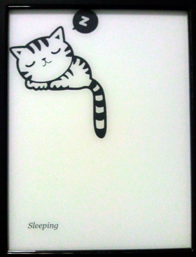

  4. let the device go to sleep (by either setting timeout, or pressing power button)
    (mod should display an automatically detected scanline for standby)

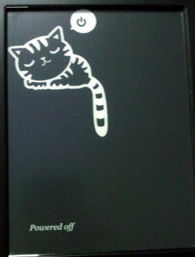

  5. let the device power off (by either setting timeout, or holding power button)
    (mod should display an automatically detected scanline for poweroff)
