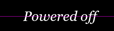

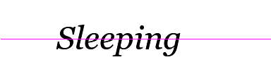

It was more annoying to implement than anticipated but there you have it. Another mode of operation, another way to detect nickel going to sleep (or powering off), and it supports different sets of images for sleep/poweroff states, too. On the downside it requires manual setup.
What's scanline mode? When Kobo goes to sleep, it executes a command (dd) before doing so and the screensaver hooks into that. Since that command is also executed at other times, screensaver then "scans" a "line" (of pixels) on the screen in order to "read" whether it says "Sleeping" or "Poweroff". And then it displays a sleep or poweroff image.
ID:	141783 Click image for larger version

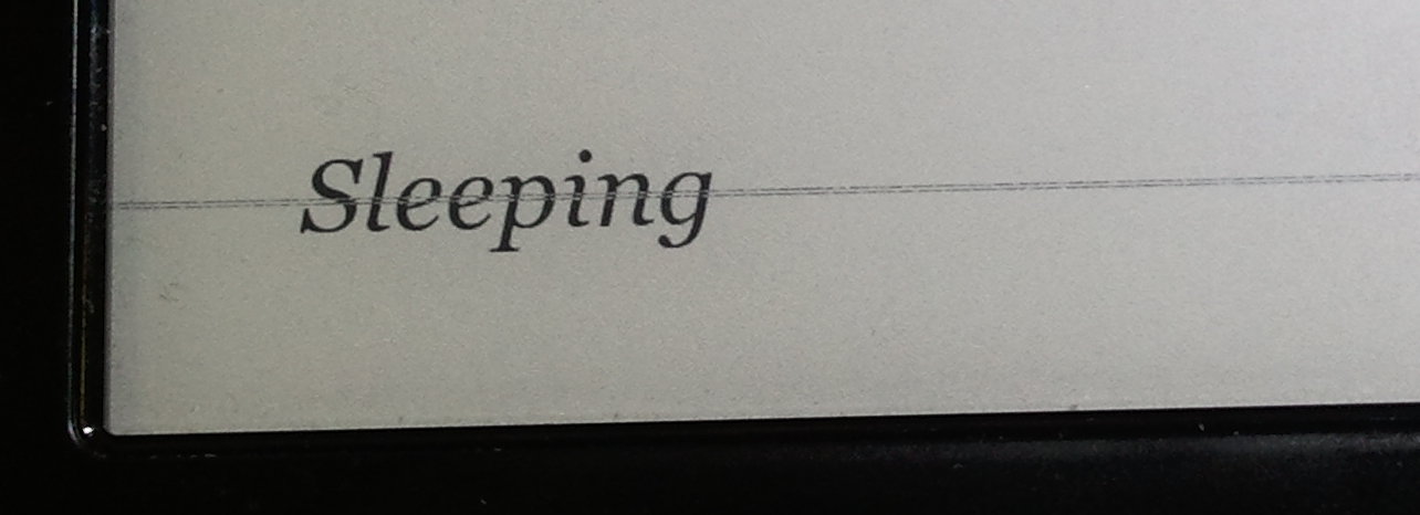

You'll have to find your own signatures, and that can be achieved by setting debug=1.
With debug=1 you get two things:
1) The scanline will be visually displayed on the screen. If it does not appear in the correct place, adapt the offset accordingly until it crosses the Power/Sleep message.
2) The detected signature will be stored in a file called scanline.txt. It will also include the date and time the signature was detected, so you can do the following:
So to get your own scanline standby/poweroff signature,
  • Go into settings, set sleep timeout to 5 minutes and power off timeout to 5 minutes.
  • Enable debug,
  • Check the time, for example, tap the screen at 20:30 and then let it idle for ~15 minutes. The device should go to sleep and subsequently power off in that time.
  • Turn it back on and check the scanline.txt. If you went idle at 20:30 then there should be a signature around 20:35 and another around 20:40. If there is more than one signature for each of those time slots, the last one is probably the good one.
  • set standby= and poweroff= to the signatures you discovered, set debug=0, and see if it works.
Sorry it's complicated.
If you try this let me know how it works out for ya. Also share your device / language / signatures that work for you.
PS: I should add that if there is any other mod trying to hook into the dd command, it would probably be a conflict of interests with that mod. Right now I simply assume no one else is crazy enough to do that.

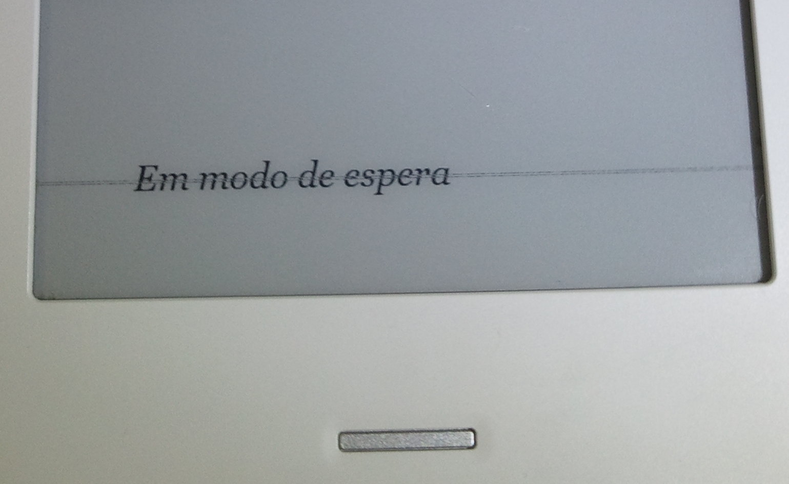

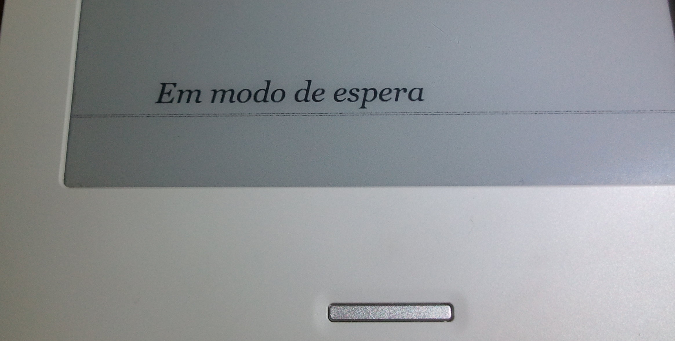

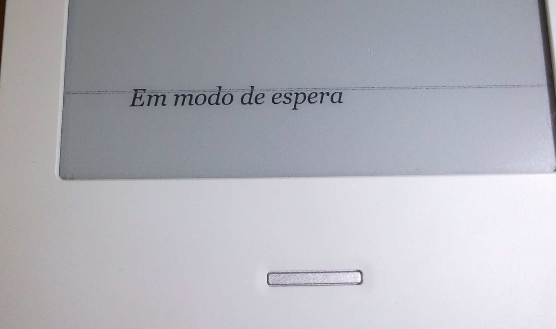

Example for the scanline debug mode on a Kobo Touch - bought it on Ebay, broken substrate, lower third of the display still operational. No idea what language it's set to.
With offset=105 the scanline is a tad too high: Click image for larger version
It might work but it's not optimal.
With offset=75 it's too low: Click image for larger version
With offset=95 it's okay: Click image for larger version
The scanline should cross the letters in as many places as possible.
Note I had to reboot the device between each offset change that should not be necessary, I'm still looking for that bug.
