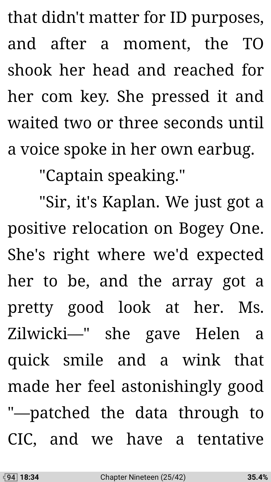

chaley
Posts: 12,528
Karma: 8065948
Location: Notts, England
Originally Posted by DoctorOhh View Post
If it worked before then I'm guessing there must have been a change to the FFDL plugin or calibre because all of the books I tried have a proper TOC and the title shows fine.
Interesting. I see the current chapter. I wonder what is different between our two configurations.
I see what you see. But when I first open the book the status bar says the title of the book.
