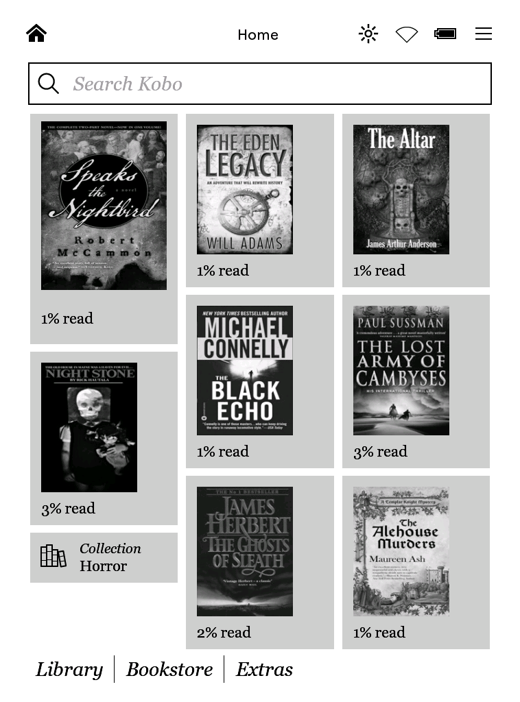

Compact homescreen layout for Glo
I've updated the `Compact homescreen layout (Glo only)` patch in post #2, I reduced the margins even more and also reduced the spacing between tiles, so now it is possible (only just) to squeeze in three rows of book tiles.
(Edit: Updated the patch again to reduce the size of the % read font, which was making tiles for partially read books a bit larger than the tiles for new or finished books.)
This patch will probably only work on the Glo, as the Aura has a slightly shorter screen.
See this post for how my Glo's homescreen looks without the patch. Attached is a screenshot with the patch:
Thank you! That is awesome!!!
I'm going to point out though that the Glo will only show the last 6 larger book tiles. If you hide most tiles like I do, you can't have it show the last 8 books.
It must also depend on when you open up the other smaller tiles as well for their placement. When I added 2 smaller tiles for a collection and for a game, it dropped a book tile so only 5 were visible instead of keeping all 6, even though it easily should have fit 3 down as you show.

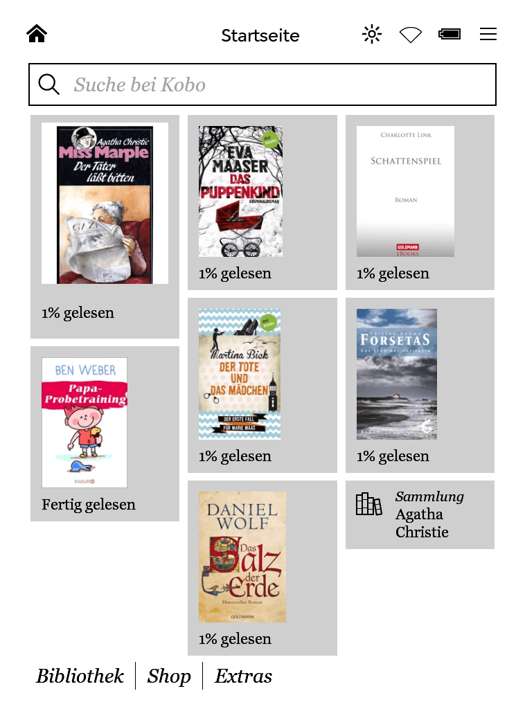

Thank you for this patch, GeoffR. It looks great.
Please take a look of my new Homescreen with the patch.

Remember the colour is from use of the Kobo snapshot; the actual screen will still be gray
I have seen this before... making a screenshot and it is full color, offcourse the screen isn't capable of display color,but for some reason i was thinking that the reader process everything in grey.. until I saw the color screenshot, so the 16 shades of grey (ehh the book has more and i am not referring to it) are color displayed in grey.. interesting..

Yes I know, PeterT.
