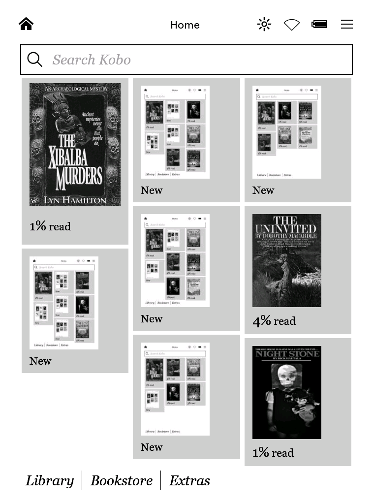

After 10 tries fiddling with various spacing for the homescreen, I finally got 8 book tiles to fit. My tiles seem slightly longer than others in screenshots, and I'm pretty certain it's because the text is slightly larger than what I see in other screenshots. And I have no idea how or where I might have changed that.
This is the spacing I used that finally allowed 3 rows of book tiles showing. Anything smaller and the top line of the search bar was cut off, or the y in Library at the bottom was missing. You can see wherever the % sign is used that it forces the tile to be slightly taller than those without the %. I had set Avenir font for the footer for the page numbers within books, could that also be what is used for the text in the tiles on the homescreen?

Edit: I put any font changes in the patch back to the original settings and I still can't get 3 book tiles with a % read in the description to fit going down. I still think it has to do with the slightly larger text I'm showing than others, but I really have no idea how I ended up with the larger text.
I noticed the same thing and updated the patch to reduce the height of the font that is used for the reading percentage, you must have been using the patch from before the update.
There seems to be limits on how many tiles can be in each column (two in the first column, three each in the other two columns?), so it is not possible to fill the screen with small tiles. I guess the patch will not be very useful if you like to have a lot of collection tiles.
The patch is not ideal, it would be better if there was a way to change the size of the tiles.
I probably copied your patch about 4 hrs before you updated it to include that change hehe. It's now gorgeous and a homescreen I can live with between your terrific patches and the Kobo Utilities plugin. Thanks for all your work making reading more enjoyable for the rest of us.
