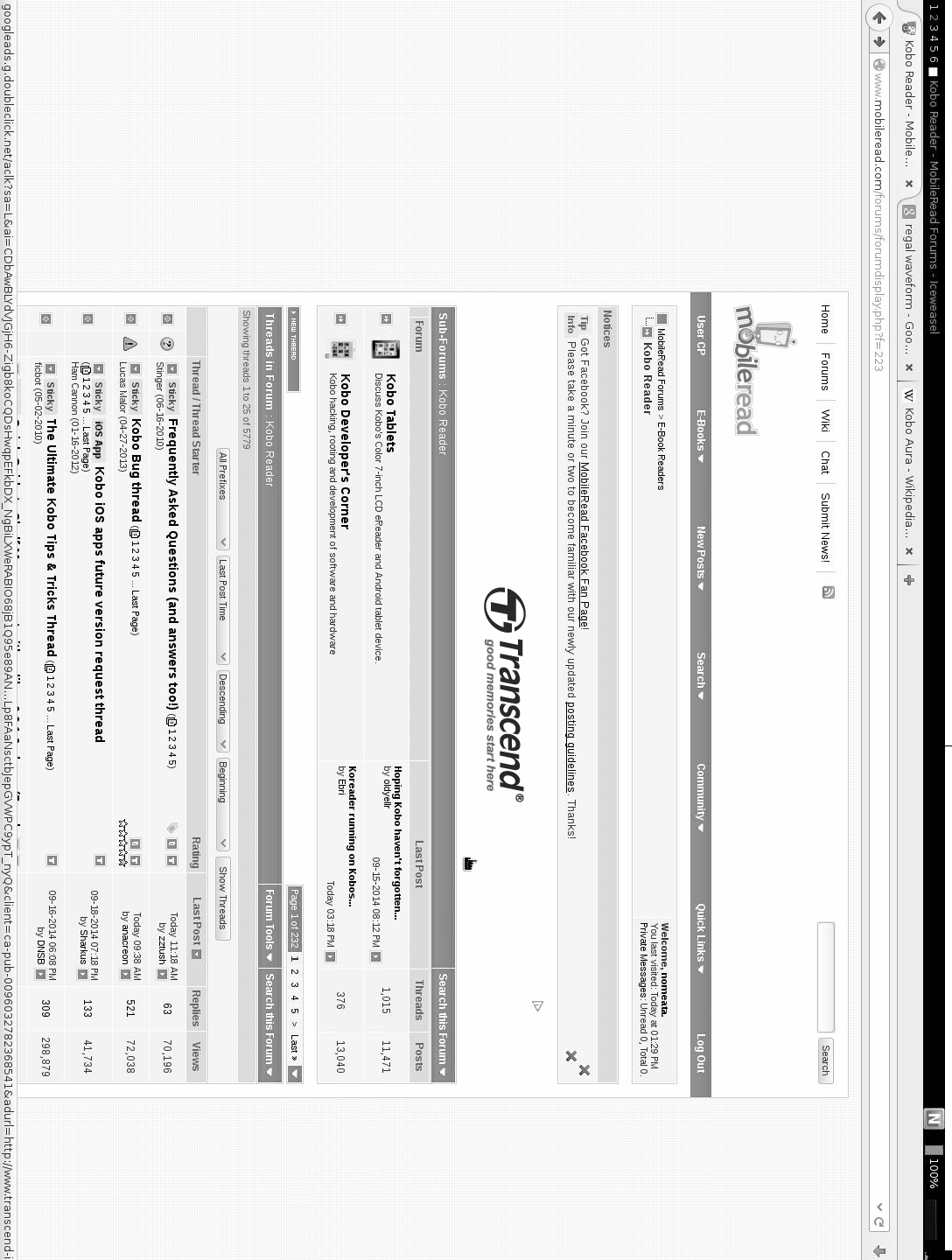

Update: It seems that the noise is an artefact from VNC compression. Attached is a dump from /dev/fb0 converted to PNG, and you can clearly see noise around anti-aliased fonts and pictures. This comes out horribly on the Kobo.
Maybe I can use VNC in a lossless format somehow? Have not yet figured out how, though.

With -encodings Hextile passed to the vnc client the image gets better, but grey scales are still wrong. It seems that kvncviewer uses the wrong pixel layout. And indeed, koreader (which works great) uses B.TYPE_BBRGB16 in ffi/framebuffer_linux.lua.
Unfortunately, when I change that in kvncviewer, the whole screen layout breaks. Maybe I should try to change more of these files.
Hans-Werner, are these files taken from koreader, or do they have another, common source? Dou you know what was modified in these files for kvncviewer?
nomeata is offline   Reply With Quote

Ok, got it to work:
* I replaced ffi/blitbuffer.lua and ffi/framebuffer_linux.lua by the version in koreader
* In vncviewer.lua, I replaced blitbuffer.TYPE_BBBGR32, by blitbuffer.TYPE_BBRGB32.
I’m not exactly sure what that means, and what I broke for others.
Last edited by nomeata; 09-21-2014 at 03:20 PM. Reason: Didn’t see the previous post, sorry.
