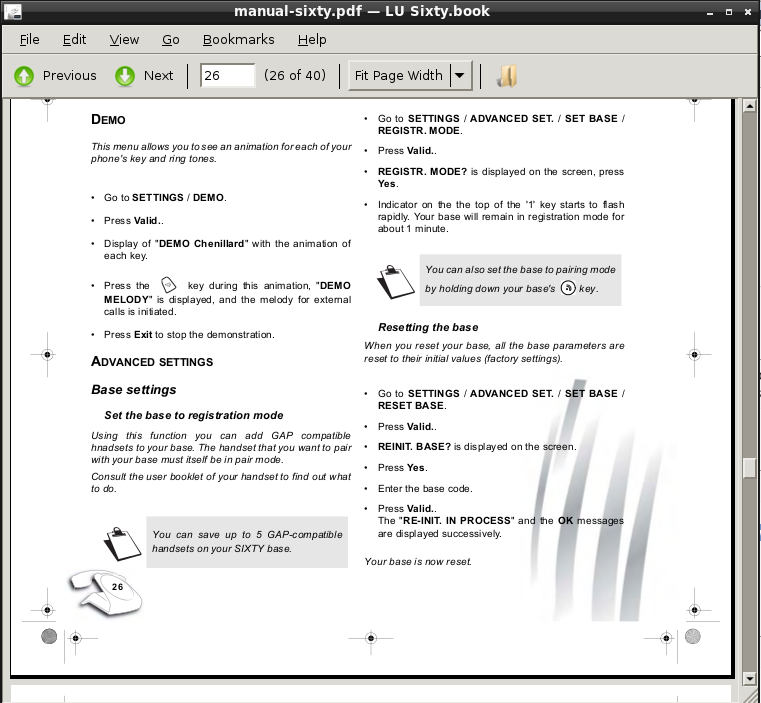

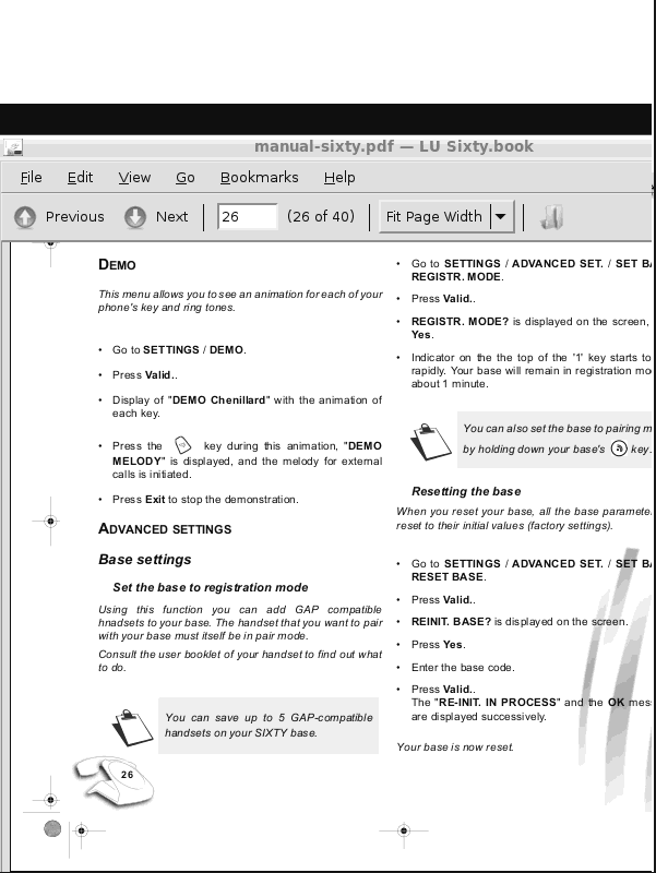

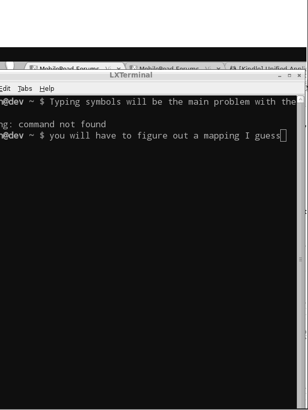

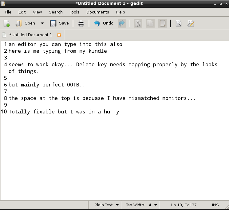

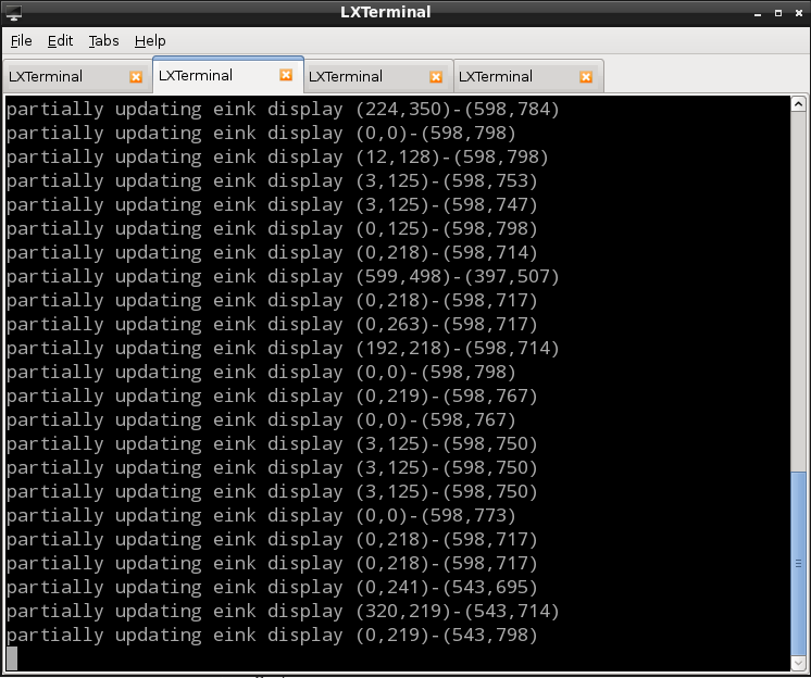

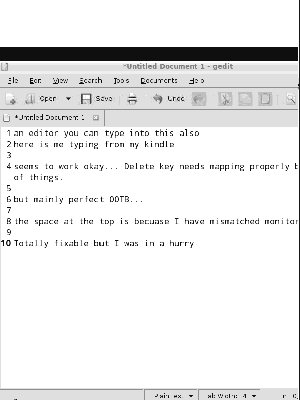

right then... gimme a minute..
Things typed:
ON PC:
vncpassword (enter 8 digit password)

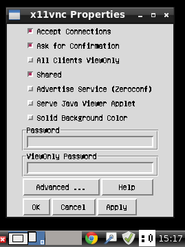

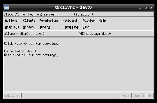

x11vnc -rfbauth ~/.vnc/passwd -bg -accept "popup" -gone "popup" -rfbport 5900 -gui tray=minimal,iconfont=14x17 -forever -noxdamage -shared &
(I also pictured a few variants of the x11vnc interface)

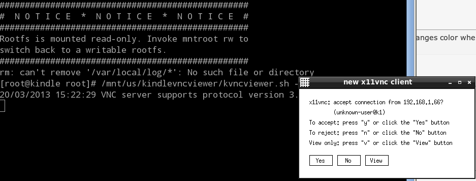

ON PC: ssh root@kindleIP
(now we are in kindle terminal effectively)
then killall -stop cvm (to stop keystrokes from being swallowed)
then
[root@kindle root]# /mnt/us/kindlevncviewer/kvncviewer.sh -password password PCipaddress
now we are rolling...

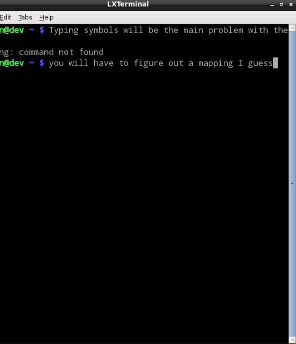

the rest is pictured...
I showed also the likely kindle TERMINAL output (the eink update messages in the shell)
And the PC side... then the kindle side...
You could convert this to scripts... or whatever...
CONCLUSION:
mainly worked. keystrokes and special symbol might be a PITA in the beginning until you get a config.LUA you like... I never bothered playing with that but feel with a little determination this could be a complete solution.
EDIT: I NOTED THAT SYM+ some KEY does not produce a symbol... just fix that up...
ALT + something did work but left you in an odd location.
Tabbing wasn't immediately obvious how it might work and that would need love.
Delete key didn't seem properly mapped OOTB
Moving the cursor was entirely in-obvious.
These are all setup issues though. perhaps with time they could all be configured in the config.lua. Didn't play around any further...
Alternately you could go down the OTG usb route WITH THE KINDLE 4 and invert the colors PC side to fix the inverted framebuffer colors... either way. in a pinch this would work.
Hope that helps.
CNTRL +C
then
killall -cont cvm
and press HOME on the kindle or...
echo "send 139" > /proc/keypad
(same thing)
to get the kindle back to normal.

the vnc connection broke down regulary and I had to renew it per dialog window
but...
i wanted to end the vncviewer and hit Shift T A and went into the myterminal thing. Now iam on homescrren and it is frozen.. seems bricked... fuck
fonzie4msg is offline   Reply With Quote
