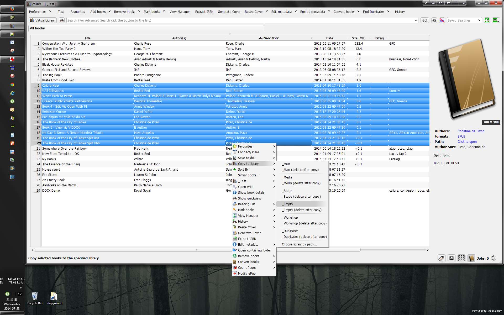

Merge Libraries
Create a new library called say 'TestLibrary'
Now Open one of your existing libraries and select say 10-15 books, right click the selected books and you should see a context menu with a Copy to Library-> item, click it and you'll get a flyout menu with two options for each of your other libraries - one which does a copy, and another that does a copy and then a delete - click the one for TestLibrary - ie the one without the delete . See screen shot
If you have any custom columns, it will ask if you want them in the TestLibrary - tick them all - see my previous post for a screen shot. If you now go to the TestLibrary the books will there.
Repeat for the other Libraries.
If you tag the books with with the current library name (ie Main, Fiction, Read etc) before you copy them then in the merged library you can easily create corresponding Virtual Libraries.
The main advantage of a merged library is that you can see all your books and include them all in searches.
Once you decided which libraries you want to merge, I suggest you throw out the TestLibrary and create a fresh library.
