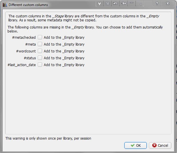

An enhancement to the Copy to library feature was added to help take care of that - see screen shot and Release: 1.4 [20 Sep, 2013] - What's new.

If you have any custom columns, it will ask if you want them in the TestLibrary - tick them all - see my previous post for a screen shot. If you now go to the TestLibrary the books will there.
