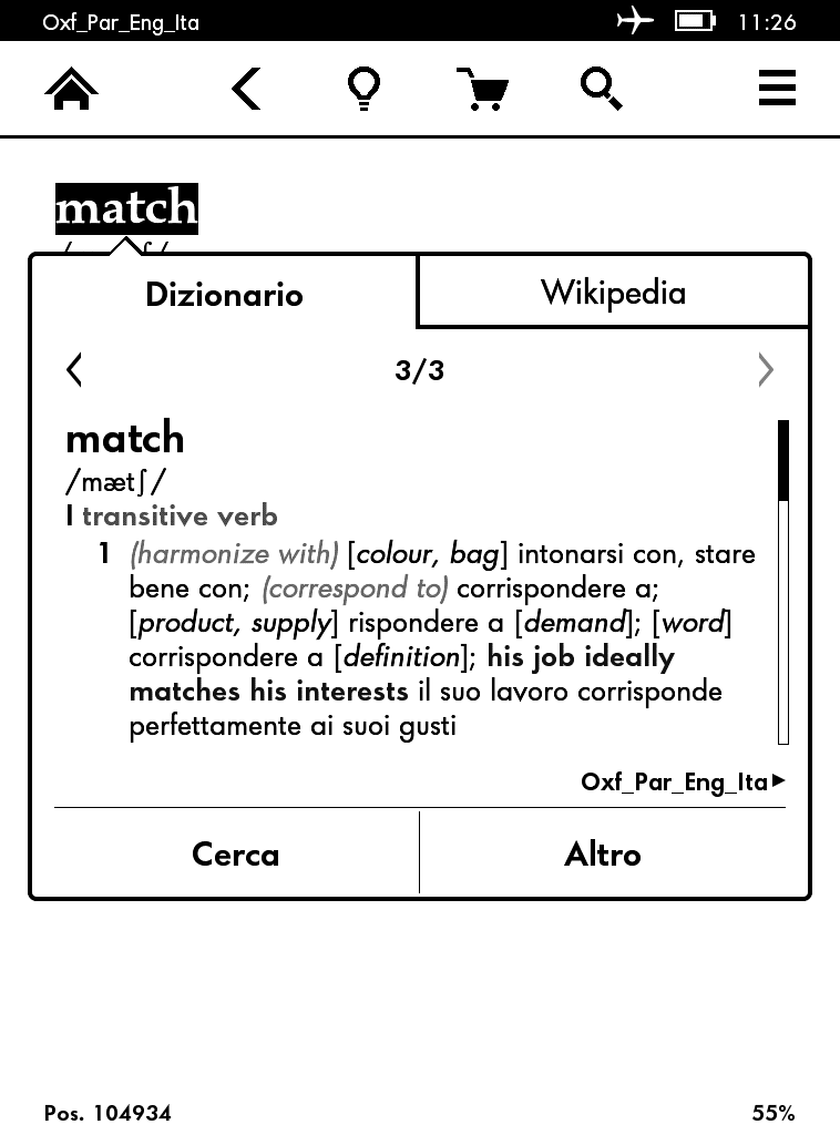

Kindle Touch's dictionary
As you can see in the attachment, with the Kindle Paperwhite you can scroll through the various definitions of the word "match" (three in this case) by tapping on the arrow keys. This is not allowed on the Kindle Touch. Do you think it is possible to achieve the same function? Maybe, with a jailbreak.
My KT is updated to the last firware (5.3.7).
Thanks!
Thanks!
Maybe you could do this via an ACX, I think that may be how Amazon manages it. See here: https://www.mobileread.com/forums/sho...d.php?t=235859
No one has written such an acx yet, however.
I took a look, eschwartz, but I do not think that hack could help me. Thanks a lot, anyway.
