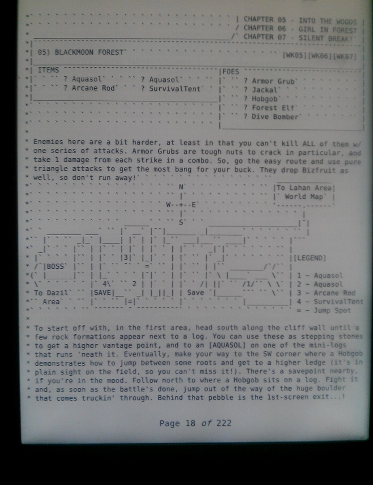

2: i also need very bad to be able to use monospaced fonts (fixed width) since i need to read schematics drawn with ascii art..
is there a converting trick (txt>pdf?) that could could help keeping monospaced fonts or isthere any other way ?
I haven't tested this with a monospaced font, but have you tried simply sideloading a monospaced font?
- Plug your Kobo in to your computer, and Connect.
- Create a folder at the root of your Kobo, and call it
fonts
(exactly that, no capital, no other changes)
- Drag and drop your font in there,
- safely eject the Kobo from your computer,
- then reboot the Kobo (not just sleep/unsleep: a full turn off with a long hold of the power slide button).

When I wanted a monospaced font, I used the Dark Courier font I downloaded from HP's site (lj611en.exe). I had to rename the 4 fonts files that were extracted. The internal font name was Dark Courier so I renamed the 4 font files as follows:
dour45w.ttf => Dark Courier-Regular.ttf
dour46w.ttf => Dark Courier-Italic.ttf
dour65w.ttf => Dark Courier-Bold.ttf
dour66w.ttf => Dark Courier-BoldItalic.ttf
After added those files to the fonts folder on my Kobo and power cycling the Kobo, I was able to use those fonts to display computer/teletype style text.
And yes, resetting or power cycling after adding a font is necessary unless you are very fond of "interesting results".

thank you guys for your answers
thank you DNSB i could successfully install and use dark courier
but i still have a problem..
the schematics in ascii art are still not good.. all messed up
1: left justification is used no matter what option i choose..(off center etc)
2: and also a lot off characters are replaced with question marks "???"
3: justification is suppressing any blank space that is preceding other characters.
and since all the document relies on preceding "spaces" to create margins..
so it's messing all the document..
is there nay way to replace spaces with other special characters (in hex editor maybe ? since it's a .txt)

I think the problem is the multiple space are being displayed as a single space. Converting them to epub would only fix this if the conversion replaced the extra spaces with   or the equivalent character. Replacing the space with the appropriate unicode character in the text file might work.

findings:
* epub's conversion messes dark courier's implementation, it's not anymore monospaced or even the same font..
* inserting a non ascii character through HEX editor makes it no longer treated as TXT and dark courier (monospace) is lost.
i tried inserting a '*' at the start of every line (notepad++ rows mode) but didn't work,
thx davidfor for the hint on merged spaced you were right i made several test to find that,
more than two spaces are merged into one (no matter their position in the text),
so,
i replaced every 2 spaces ( ) with (` ) special ascii caracter decimal code 60 AND 1 space.. (notepad++ replacing function)
it looks now perfectly aligned i am satisfied with how it looks even if it looks rainy
still got some "???" caracters i would like to know if there are more tested monospaced/fixed width font on the kobo
i will be AFK please feel free to answer thx in advance..

re: the ??? characters. Dark Courier may not have very good coverage of many of those ascii-art unicode characters. Try a few more Mono fonts to see if you can find a better one. DroidSansMono and LiberationMono both have more glyphs than DarkCourier, but whether they are the glyphs you need, I don't know.

a list of monospaced fixed width fonts with Glyphs count,
i tried fonts with good counts:
courier new is too thin, droid is clean,i suspect that lekton isn't fully monospace.. other fonts are just weird looking or too fat.. tried also M+ and everson are not recognized as monospaced..
renamed as follow in the "\fonts" directory:
Courier New-Regular.ttf
Droid Sans Mono-Regular.ttf
M+ 1m-Regular.ttf
DejaVu Sans Mono-Book.ttf
Everson Mono-Regular.ttf
Fixedsys Excelsior 3.01-Regular.ttf
i like DejaVu
finally i could get rid of the "????" by saving the TXT as unicode rather than ANSI
thank you

for the sake of sharing
these operations are required to be done if you wanna read specially formatted (79 characters wide articles) gamefaqs.com game's walktroughs on kobo aura hd..
1: use monospaced fonts (ex:dejavu sans mono)
2: insert a row of asterisks in the first leftmost position in all documents. (insert row function notepad++)
3: replace all two concatenated spaces ( ) with (` ) through all the document in order to do it you must run the operation twice or thrice (replace function notepad++)
4: save the document in unicode not in ANSI..
