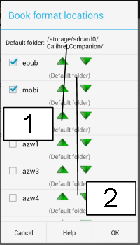

Next, scroll through the long list of extensions and check the ones you want calibre to be able to send to your device. Don’t try to order them at this point, it is easier to do in a second pass.
After you have "checked" all the extensions you want to use, it is time to set their priority. This is easiest to do if you close and reopen the dialog, because all the checked extensions will be at the top. So press OK, then reopen the dialog. Now use the arrows to move the selected extensions up and down. The higher an extension, the higher its priority.
You can use this dialog to change the folders where extensions are stored. See the following image of the extensions dialog.

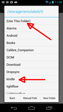

To change the default folder (the one used if no specific folder is chosen for an extension), open the extensions dialog and click where the "1" points. To change the folder for a specific extension, click below the arrows on that extensions line. Number "2" in the dialog image shows where you would click to change the folder for epubs. You will see a dialog that tells you where the files are currently stored. Click the "Change" button if you want to change it.
If, for example, you are changing the storage folder for mobi books to the folder used by Kindle for Android, scroll the list of folders until you see the "kindle" folder. Tap that folder to enter into it, then tap the "Use this folder" line at the top of the list.
In the Kindle for Android case, after having changed the storage folder, selecting K4A as the reader will start K4A at its home screen. It will import the books you have sent to Calibre Companion so you can read them. Please see this post for more information on integrating with Kindle for Android.
