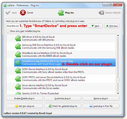

    Important: K4A does not support subfolders in the "kindle" folder. Because of this, when using K4A you must not use a calibre save template that sends books to subfolders. The default calibre save template for smart phones does not use subfolders. If you have changed the template using the preferences for the "smartdevice", you must change it back or use CC's setting to use the calibre "book identifier" as the filename. To change the save template in calibre, click on Preferences, then Plugins (on the last line of icons). Enter SmartDevice into the search box as shown in the following image then press Enter.

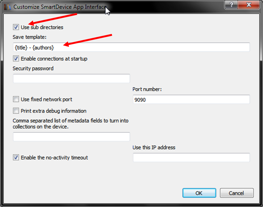

    Double-click on the Smartdevice line. The following dialog will open.
    You should uncheck the box "Use sub directories", and you should also change the template to something that has no slash characters ('/') in it. The example in the image, "{title} - {authors}" typed without the quotes, should work in most cases. If you have different books with the same title and authors, then use "{title} - {authors} {id}", again without the quotes.

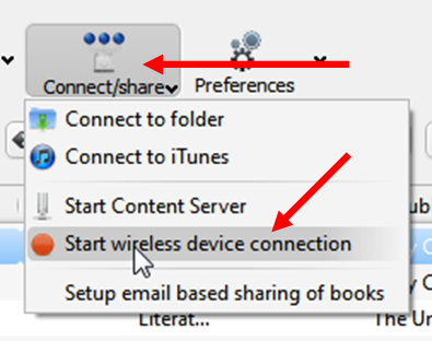

We have tried very hard to make Calibre Companion able to automatically connect to calibre in many different network setups and situations. Unfortunately there are as many different network setups as there are networks and operating systems, and some combinations are unusual or complicated enough to defeat auto-connection.
First, try setting up automatic connection. To do this, first ensure that you have started the wireless device driver in calibre. Click on Connect/Share, then “Start wireless device connection”.
Now attempt to connect CC to calibre. In CC, tap Connect, then As Wireless Device. Normally this is all you will need to do.

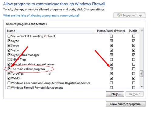

  1. Check that your firewall is allowing calibre to send and receive messages. For example, in Windows 7, go to the control panel, select Windows Firewall, and click "Allow a program or feature through Windows Firewall". Scroll down the list until you see "The main calibre program". Ensure that it has a check mark on the left side and (at least) in the "Home/Work (Private) column.
    Some firewalls don't support application-based permissions, in which case you will need to use a fixed port (see below) and open that port in your firewall.
    As there are many firewalls, most of which we do not have, we are unable to give more instructions for opening a port in the firewall. However, if you have McAfee, user feedback indicates that two settings must be checked: which programs are allowed to access the internet and whether the "home network" is trusted. Calibre should have "Full" access to the internet and the home network should be marked as fully trusted. If you look at the network map in McAfee, you should see your device and it should be trusted.

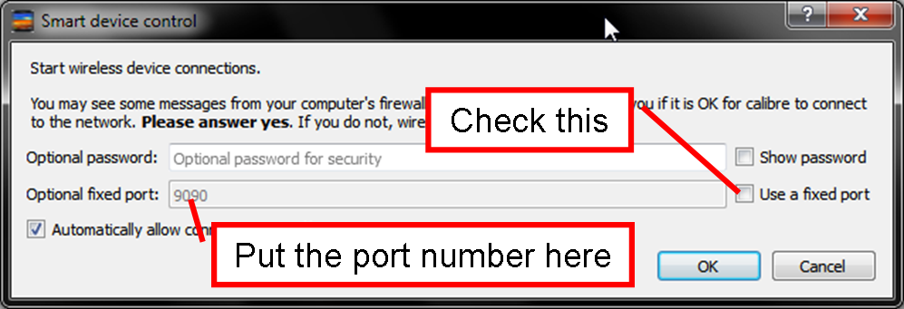

  1. In calibre, go to wireless connection menu shown above. If it says "Stop wireless device connection", click it and answer the question about auto-connection (however as you wish), then click the menu "Start wireless device connection" again. You will see the following dialog box.
    Check the box "Use a fixed network port". Change the default port number (9090) if you wish. You must not enter the same port used by calibre's content server. Press OK. Calibre will complain if there is a problem with the port, for example if it is being used by another application on your computer.
  2. Be sure that any firewall you are running on the computer running calibre allows incoming connections to the chosen port.
Before going on to the next steps, try to connect Calibre Companion to calibre. In many situations, simply setting a fixed port in calibre and opening that port on your the firewall will be enough to permit Calibre Companion to connect.

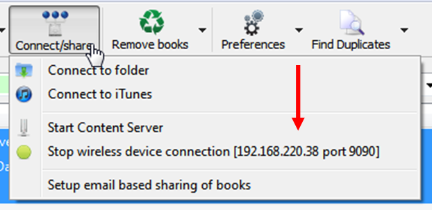

  1. Click again on calibre's connect/share menu. Assuming that the wireless driver is running (a green dot is shown next to the menu line), you will see calibre’s IP address and port on the menu line. If you do not see the port then something went wrong when you checked the "Used fixed port" box as described above and you should follow those instructions again. If all went well, you should see something similar to the following:
    Make a note the displayed IP address and port.Important note: If you see more than one IP address, read the answer to "My computer has more than one IP address. Which one do I use?" below.

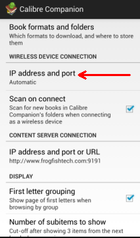

  2. Enter calibre's IP address into Calibre Companion on your device. To do this, click CC's “Settings” menu item.
    then click the wireless device connection line

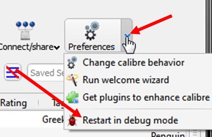

It could be that we will need a calibre debug log to help analyze the problem. You can get a calibre debug log by running calibre in debug mode. Start calibre, then click the small down arrow next to preferences as shown in this screenshot.
Click on "Start calibre in debug mode". Let calibre restart and answer OK to the dialog that confirms that calibre is in debug mode. Attempt to connect CC to calibre. Get to where you are having the problem, then close calibre. You will see a debug log in a new window, probably in a text editor. An example is

CC connects but then sits there doing nothing. What do I do?
Calibre Companion connects to calibre as a "device", which means that calibre is in charge. After Calibre Companion connects, you use calibre to send books to your device and delete books from your device, just as if your device were connected using a cable.
After connecting, go to your computer running calibre, select some books, then click on the "Send to device" button.

I am a Sony user and I want my collections. What do I do?
First, check if the grouping and sorting features available in CC don’t already provide an alternate way to get the same information. If they do not, then you can enable collections for the Smartdevice driver in the same way you did for the Sony driver.
Go to the device preferences (in calibre, go to preferences -> plugins -> device plugins -> Smartdevice App Interface), and enter the lookup names for the columns for which you want collections. The Sony collections tweaks work here as well. Reconnect the device and your collections will appear under the group menu item “User Collections”.
