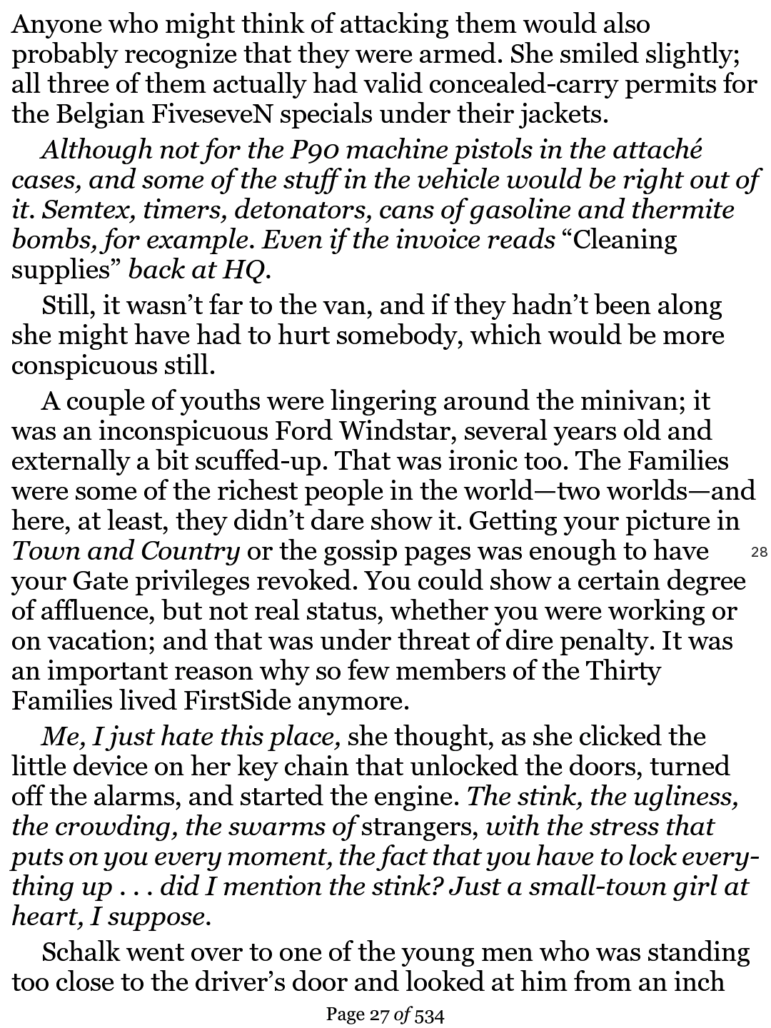

I played with it since the defaults set a page number that was half off the screen and so small that what I could see was unreadable. After playing a bit, I found 60 for the min and max height and 10 for qproperty-footerMargin was about the best compromise for me basically losing 1 line at the bottom of the screen.
Regards,
David

Perfect! Thanks for the posting your settings and the excellent screenshot. The tiny page number was my last concern.
I guess I wouldn't mind adding a percentage to show book position, i.e, 63 of 564 (11%), but fixing the margins is much more significant. Once my Aura finally arrives I'll be applying this patch.
