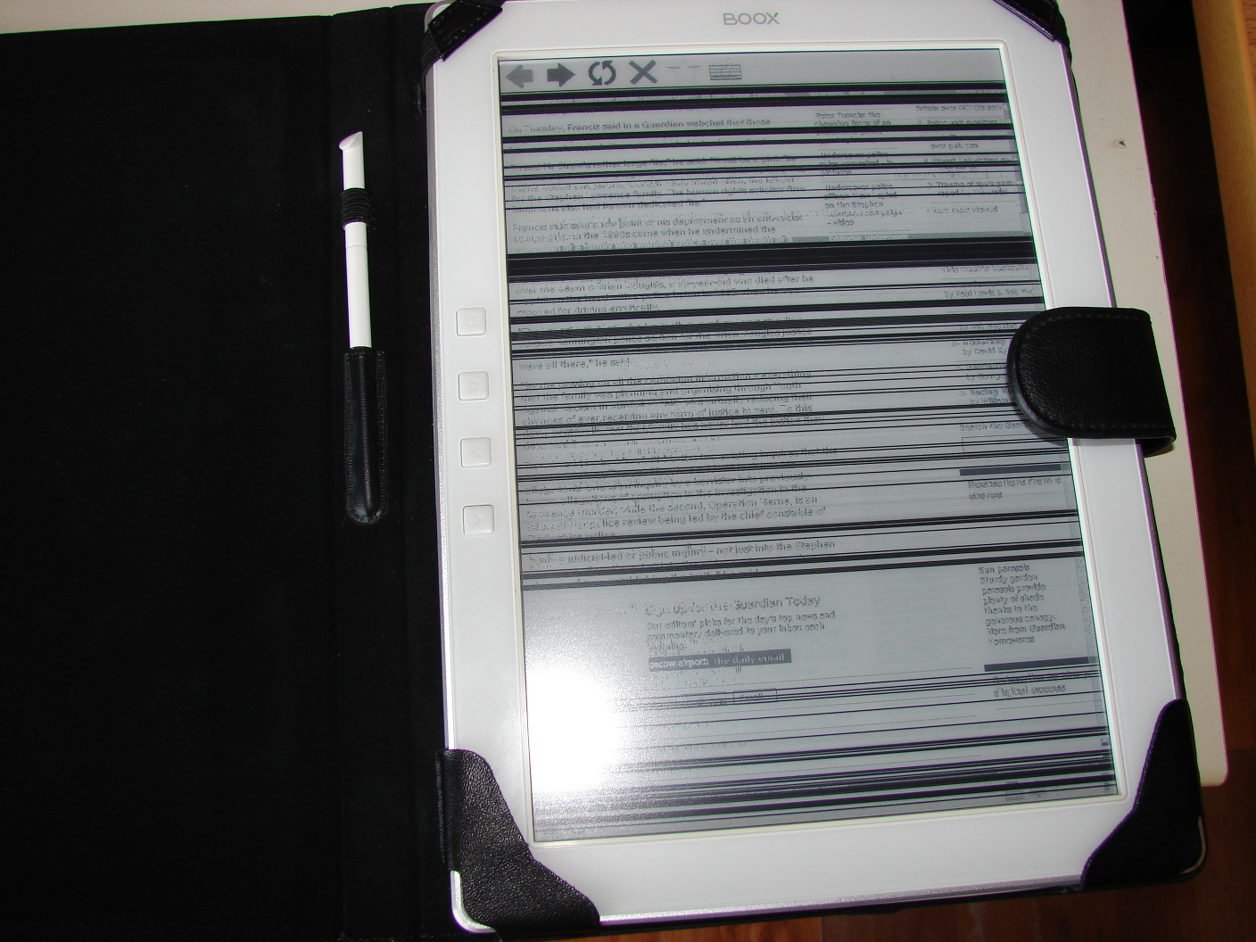

M92 broken - again?
This morning, my screen stopped being responsive, i.e. it now constantly show the same image - and a bad one at that.
The reason I write about it here is that this is the third (!) time this has happened within a year and a half.
Now I am beginning to worry about the cost of repeatedly shipping this unit back to Booxtor... it shall end up costing me more than the unit itself, and I cannot keep paying this 're-activation fee'; and if this keeps happening every half year, well, my warranty shall run out.
Here are the symptoms (throughout which the screen stays the same - see image.):
* Browsing yesterday, used the back button, gave this screen.
* Can switch off the unit holding the button down. Light come on a while
* Can switch the unit back on, light come on for some 10 secs.
* Tried reset, no difference.
* Tried charging again (unit was charged almost fully when this happened, though).
* Tried hitting the screen refresh button on-screen (where I know it should be); no reaction.
* The screen does not appear physically broken in any way.
I always - and only - keep the unit on my bedside table, always in the cover, and there is no misuse, bad treatments, drops onto the floor, or any other abused. Short of keeping it in cotton wool and not using it, it could not have been more carefully treated.

Hi,
sorry you are hit by this bad luck again.
In you case I guess the problem is not in the screen but most likely in the main board (PCB). I saw already such a picture a couple of times. It would be a warranty case and could be repaired for free. Please contact our maintenance office.

When the unit arrived in Booxtor's capable hands, weirdness ensued and the thing just worked... just like that.
Anyway, Booxtor checked it out, changed a few components (one big one, actually) just in case, and shipped it back.
I just got it back today, and it seems to work just fine.
Of course, I still worry that I shall have an issue again in half a year's time, but I have to say that I am happy that I bought from Booxtor, as he has been absolutely splendid throughout this ordeal. It has been fast, competent, and with no expenses for me at all, so a big cheer for that!
