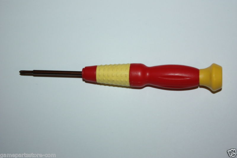

Anway, the screwdriver I use is the one for really tiny phillips screws. It's the same one I bought for opening my Nintendo DSi. They advertise the screwdriver as "PSP DSi XL Repair Tool Phillips Screwdriver".
I have attached a copy of the screwdriver, if that helps.
