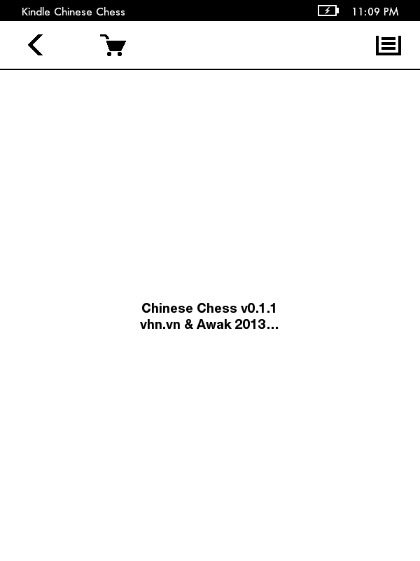

I can not run it. It just stop at the beginning , like this: Click image for larger version
ID:	102523 What's the problem?

Originally Posted by yahwing View Post
I can not run it. It just stop at the beginning , like this: Attachment 102523 What's the problem?
It could be anything - But my best guess is "you are run out of memory"...
This program use a lot of resources as it need to store the Chess graphic images.
The first thing I would do is turn off the WiFi (airplane mode), it can save some memory and see if the program work.
The second thing is check if your Kindle has enough space in storage. The program required at least 512 bytes to save the stage of the Chess Game so that you can carry on the game even it has been power off (sleep) and on again. I have used three of those bytes to store the Game Time so that the Time counting can be continued (this fix will be included in the next release...)
Delete some files and run the game again to see if it works.
Last but not least - Recharge your battery! Your screen dump show your battery level is low, the Kindle may not have enough power to run the chess game!...
Awak is offline   Reply With Quote

Posts: 127
Karma: 6744
Device: Kindle Touch, PW2, PW5
I also encountered this problem before. but after upgraded to the latest version, it runs without problem. not sure what's the cause. is there a way to capture an error log?
yiming is offline   Reply With Quote

Originally Posted by yiming View Post
5.3.2.
When I said version, I meant latest version of Chinese Chess.
I still can't run the lastest version in 5.3.2.1 . Click image for larger version
Here's the crash.log :
[3/8/13 11:24 PM] Kindle Chinese Chess (v. 0.1.1)
java.lang.NullPointerException: null
at com.amazon.kindle.kindlet.internal.security.Kindle tSecretKey.ZDb(euc:937)
at com.amazon.kindle.kindlet.internal.security.Kindle tSecretKey.Fgb(euc:614)
at com.amazon.kindle.kindlet.internal.security.G.Fgb( vrc:1410)
at com.amazon.kindle.kindlet.internal.security.G.ieb( vrc:773)
at com.amazon.kindle.kindlet.internal.security.G.OEb( vrc:1320)
at com.amazon.kindle.kindlet.internal.security.G.getC hars(vrc:1333)
at vn.vhn.amazon.kindle.chinesechess.posCollection.lo calIsSolved(Unknown Source)
at vn.vhn.amazon.kindle.chinesechess.posCollection.po pulateSolvedArray(Unknown Source)
at vn.vhn.amazon.kindle.chinesechess.posCollection.<i nit>(Unknown Source)
at vn.vhn.amazon.kindle.chinesechess.Main$1$1.run(Unk nown Source)
at java.awt.event.InvocationEvent.dispatch(Compiled Method)(Unknown Source)
at java.awt.EventQueue.dispatchEvent(Compiled Method)(Unknown Source)
at java.awt.EventQueueProxy.dispatchEvent(Compiled Method)(Unknown Source)
at java.awt.AGUIEventDispatchThread.pumpOneEventForHi erarchy(Compiled Method)(Unknown Source)
at java.awt.AGUIEventDispatchThread.pumpEventsForHier archy(Compiled Method)(Unknown Source)
at java.awt.AGUIEventDispatchThread.pumpEvents(Unknow n Source)
at java.awt.EventDispatchThread.pumpEvents(Unknown Source)
at java.awt.EventDispatchThread.run(Unknown Source)
at java.lang.Thread.startup(Compiled Method)(Unknown Source)
Could you help me fix it? I like the idea of playing chinese chess. Thank you very much!
Thank you very much! Download the latest version from this post and see if your problem has gone:
https://www.mobileread.com/forums/sho...7&postcount=48
The reason may be I am using the latest version of library from KDK (version 2.2) while the first version of Chinese Chess is using an older version of library which may not be able to run if you have just updated the firmware...
Sorry, there is NO error log - I have add some debug routines already in the program, but don't think you can use it easily...Hope this can be improved later.
From the look of crash log, it mentions "KindletSecretKey" has returned a null exception...
There are a few possibilities - Most likely is you don't have the correct developer store.
Each application used in Kindle require a developer key to match with it, the process are done automatically if you purchase the items via Amazon using the WiFi.
But because you just copy this Chiness Chess to your Kindle, the Developer Keystore will missing the correct developer ID unless you have added it yourself manually!
Search through the various threads from this forum to learn how to add the Developer Key (For the required Key here - See first post of this Chinese Chess thread) to your Developer Keystores in your Kindle.
Or if you have NOT bought anything yet from the Amazon's store, just use the attached "combined" developer store - It works for me...
