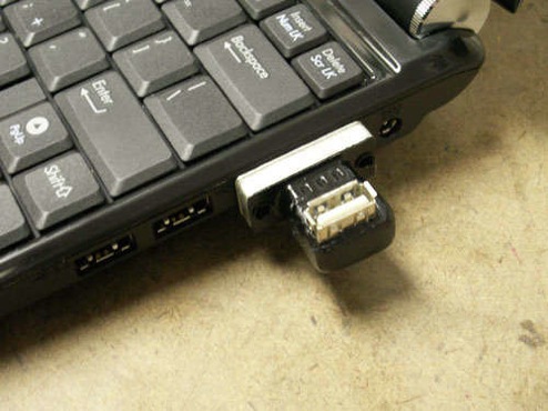

19. Kindle as External Monitor:
<This is just an idea for future>
To transfer VGA data over Mini-USB cable to Kindle Touch. This should not be confused with eMonitor.
Two components:
1. a software driver that will format and compress the video data and send it to a USB port
2. decode the video data on the USB cable and display it on KT
Needed:
VGA to USB converter
</This is a placeholder>
