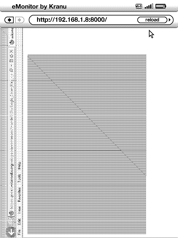

eMonitor with Support for Dithering
Hi All,
Please find the enclosed version using wxpython with support for Dithering with geekmaster's formula 42 translated to python.
The screen size can be reduced to 800x600 for Kindle easily.
The dithered variable is set to True or False to turn on or off.
Dithered images are saved as png - for smaller size
Grayscale images are saved as jpg - for smaller size
Thanks,
James
#!/usr/bin/python
#eMonitor
#Version 3 modified by jmseight for Kindle/Story (4-25-2012)
#  Rotate screen 90 deg
#  Support Dithering if turned on (no flash on videos)
#    support cropping of dithering table
#    saves as png for dithered
#    saves as jpeg for grayscale
#  Reduce quality for faster load
#  Uses GeekMaster's Dithering Formula (MIT license)
#  Set to Story HD resolution
#based on eMonitor by Kranu
#Version 2 (9-1-2011)
#Tested on Windows 7 x64, Python 2.7.2, wxPython 2.8
#For more information, see: http://goo.gl/rJoLp
#BEGIN SETUP
#HTTP Server
port=8000              #port of http server (http://127.0.0.1:8000/)
#capture region
#l,t=(1680,1050-800)
l,t=(0,0)              #left and right offset from primary monitor
w,h=(1024,768)          #width and height of capture region
fn ='shot.png'         #file name of screenshot
quality = "50"
dt = [
    3,129,34,160,10,136,42,168,192,66,223,97,200,73,231,105,50,
    176,18,144,58,184,26,152,239,113,207,81,247,121,215,89,14,
    140,46,180,7,133,38,164,203,77,235,109,196,70,227,101,62,188,
    30,156,54,180,22,148,251,125,219,93,243,117,211,85 ] # 0-255 dither table
white = 255     #white threshold
black = 0       #black threshold
dithered = True  #dithered or not
#//END SETUP
import wx,socket
from BaseHTTPServer import BaseHTTPRequestHandler, HTTPServer
class serv(BaseHTTPRequestHandler):
  def do_GET(self):
    self.send_response(200)
    if self.path.startswith('/'+fn):
      self.send_header('Content-type','image/jpeg')
      self.end_headers()
      app=wx.PySimpleApp()
      context=wx.ScreenDC()
      bitmap=wx.EmptyBitmap(w, h, -1)
      memory=wx.MemoryDC()
      memory.SelectObject(bitmap)
      memory.Blit(0, 0, w, h, context, l, t)
      memory.SelectObject(wx.NullBitmap)
      image=wx.ImageFromBitmap(bitmap)
      data=list(image.GetData())
#      for i in xrange(0,len(data),3):
#        data[i]=data[i+1]=data[i+2]=chr(int(0.2989*float(ord(data[i]))+0.5870*float(ord(data[i+1]))+0.1140*float(ord(data[i+2]))))
      i=0
      if dithered:
        for y in xrange(0,h-1,1):
          for x in xrange(0,w-1,1):
#            i = (y*w + x)*3
#            j = ((y&7)<<3)|x&7
#            intensity = int((298*ord(data[i])+587*ord(data[i+1])+114*ord(data[i+2]))/1000)
            if dt[((y&7)<<3)|x&7] < (ord(data[i])+(ord(data[i+1])<<1)+ord(data[i+2]))>>2:
              data[i] = '\xff'
            else:
              data[i] = '\x00'
            i=i+3
      else:
#            i = (y*w + x)*3
            data[i] = chr((ord(data[i])+(ord(data[i+1])<<1)+ord(data[i+2]))>>2)
            i=i+3
      image.SetData("".join(data))
      image = image.Rotate90(False)
      if dithered:
        image.SetOption(wx.IMAGE_OPTION_PNG_FORMAT, str(wx.PNG_TYPE_GREY_RED))
        image.SetOption(wx.IMAGE_OPTION_PNG_BITDEPTH, "8")
        image.SaveFile(fn,wx.BITMAP_TYPE_PNG)
      else:
        image.SetOption("quality", quality)
        image.SaveFile(fn,wx.BITMAP_TYPE_JPEG)
      f=open(fn,'rb')
      self.wfile.write(f.read())
    else:
      self.send_header('Content-type','text/html')
      self.end_headers()
      self.wfile.write('<!doctype html>'\
        '<html lang="en">'\
        '<head>'\
        '<title>eMonitor by Kranu</title>'\
        '</head>'\
        '<body style="margin:0px;">'\
        '<img id="pic" src="'+fn+'" style="float:left;width:100%;height:100%;">'\
        '<script type="text/javascript">'\
        'document.getElementById("pic").onload=function() {'\
        '  document.getElementById("pic").src="'+fn+'?"+(new Date()).getTime();'\
        '</script>'\
        '</body>'\
        '</html>')
try:
  print 'eMonitor by jmseight (based on Kranu)'
  for j in xrange(0, len(dt)-1, 1):
    if dt[j] < black:
      dt[j] = black
    if dt[j] > white:
      dt[j] = white
  #Amazon's website is used here for its reliablity. Feel free to change it.
  s = socket.socket(socket.AF_INET, socket.SOCK_DGRAM)
  s.connect(("amazon.com",80))
  print 'Starting.. ',
  server=HTTPServer(('',port),serv)
  print 'Press Ctrl+C to stop'
  print
  print 'On your Kindle/Story, visit http://'+s.getsockname()[0]+':'+str(port)+'/'
  server.serve_forever()
except KeyboardInterrupt:
  print 'Stopping.. ',
  server.socket.close()
  print 'Have a nice day!'

[UPDATE] I found out that there is a little bug in my code, and these are actually kind resize artifact.
Thanks,
James
Hi Geekmaster,
I don't know if I am doing something wrong, but I am getting some dithering artifacts. Please see the attached screen capture on my K3G.
This is a single cyan image. Please see the diagonal line I can actually see it when I use Youtube video, and the vertical lines (showing as horizontal).
These images were transfereed with lossless PNG so these are not JPEG compression artifacts.
Thanks,
James

Hi,
I removed the K3G browser resize artifact by setting the screen to 706x600.
This makes perfect dithering.
