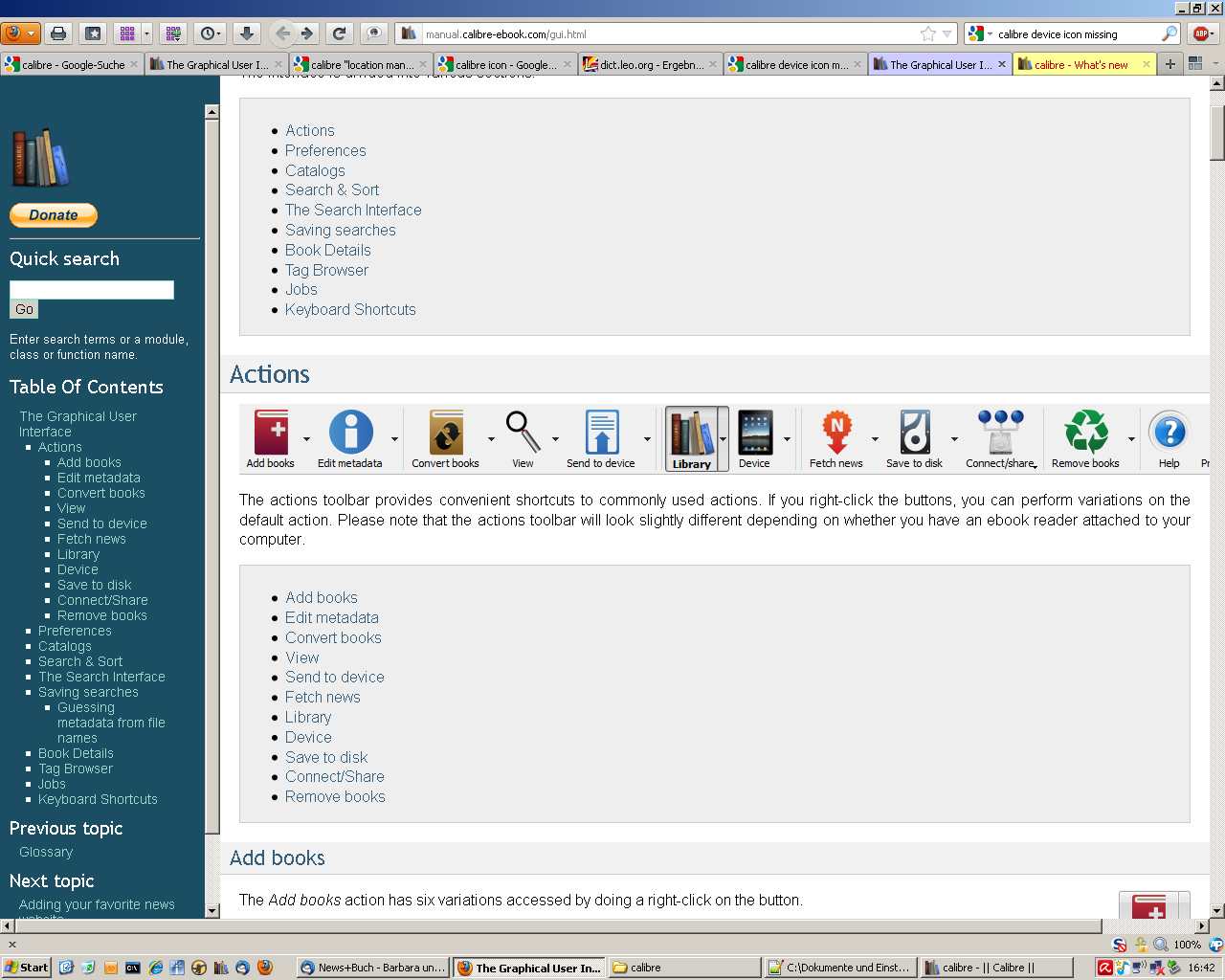

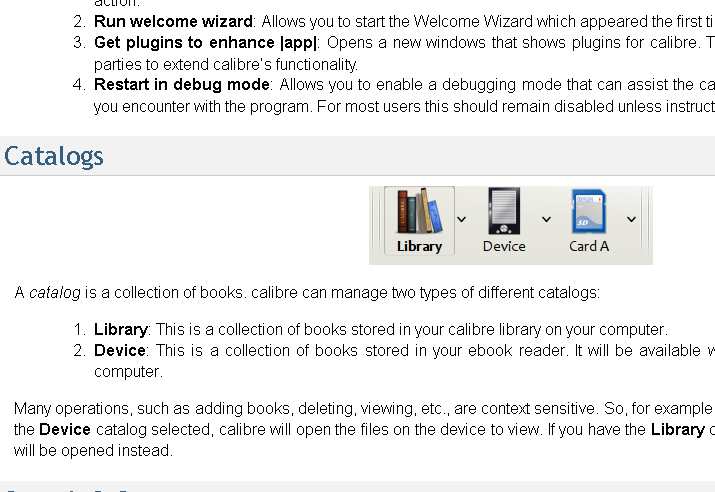

Old 12-26-2011, 10:59 AM   #5
KlausRegenbrecht
KlausRegenbrecht began at the beginning.
Posts: 56
Device: PRS-T1
This places the Icons for All Device Storage (Main, Card_A, Card_B, as needed) when the device is attached
Sorry my english is not the very best, what I'm looking for is the icon "device" you can see at the picture.
This icon is getting lost, i used it the last weeks, but since two days it disappeard. May be the new version of calibre?

Old 12-26-2011, 11:36 AM   #7
KlausRegenbrecht
Posts: 56
Device: PRS-T1
Your English was fine.
My Answer for your problem is Correct. Try it.
'Location Manager' (there is no Icon in the toolbar adding tool because a single entry results in a SET of icons)
I'm so sorry, but i can't find 'Location Manager', what that in german? Or have you a picture of 'Location Manager'.
Klaus
Ps: I'm missing the icon 'device' beside 'library'

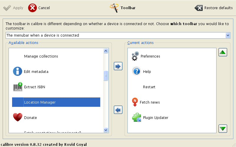

Old 12-26-2011, 11:48 AM   #8
Posts: 31,427
Karma: 62503914
Klaus
Sorry, my German is limited to 'Danke'
Here is a picture (blue line)
Name:	Location Manager.jpg
Old 12-26-2011, 11:54 AM   #9
KlausRegenbrecht
Posts: 56
Device: PRS-T1
Thank you very much, that 'Ortungsdienst' in german, that 'ortungsdienst' is in the left column, if i click the arrow 'change to left column' an error appears, this is the text:
File "site-packages\calibre\gui2\preferences\toolbar.py", line 265, in add_action
File "site-packages\calibre\gui2\preferences\toolbar.py", line 168, in add
AttributeError: 'NoneType' object has no attribute 'dont_add_to'
Klaus

Old 12-26-2011, 12:00 PM   #10
Posts: 31,427
Karma: 62503914
Klaus
Now, That is a problem I can't help with.
The Coding gurus will have to fix that
You can ONLY add to a toolbar with 'Device Connected' as part of it's name
Old 12-26-2011, 05:02 PM   #11
KlausRegenbrecht
Posts: 56
Device: PRS-T1
Thank you again, for your help. So i could isolate the problem and in a new thread kovidgoyal wrote:
"Ah, a bug that affects non-English calibre installs. Either set your calibre language to english and then use restore defaults, or wait for the next calibre release to use restore defaults."
Klaus
