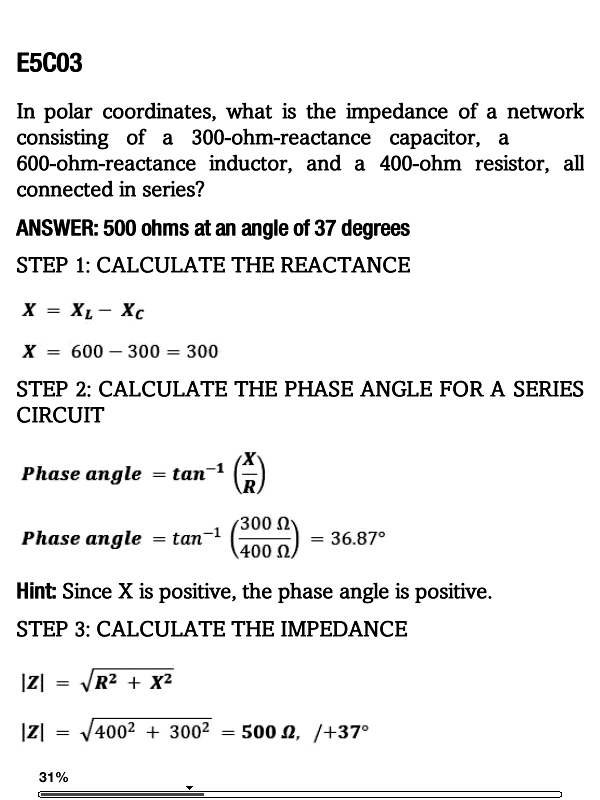

Probably not a good solution for converting PDF where math formulas will look good. I wrote a math book for radio communications and the only good way I found to get the formulas to look right was to put them in image files. It was a tedious process where I used MS Word to create the formulas then took screen captures and resized them to fit the 600 x 800 E Ink screen. Unfortunately mobi does not support a math markup language.
  Reply With Quote

Thanks for your reply, but that doesn't sound really good. If I've to convert all my books and papers this way it will be a lot of work. I hope that there will be an other way....
