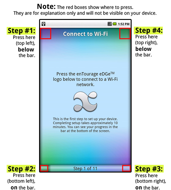

How To Bypass The Setup Procedure:
https://www.mobileread.com/forums/at...8&d=1316487782
