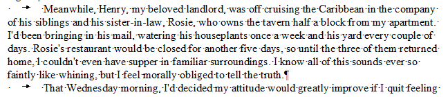

When the conversion does complete, something is funny with it after I open it in Atlantis.
It will normally load just fine, showing the Times New Roman font as usual. But now, it loads as shown (in the pictures), and for the life of me can't figure out why. No matter what I do to the font or structure, it will not change how the font is displayed. Maybe this is a handling bug in Atlantis, but I have not seen this happen before.
If I load the rtf into Word, it will usually display fine. I can just resave from word, and reload it into Atlantis and it displays and works fine again.
Twice now it has displayed any words that ends with an 's, 'd, 'll, etc. with a japanese type of font. Meaning, it will replace only the 's, etc with the japanese style, not the word itself. I cannot reproduce this effect at all.
